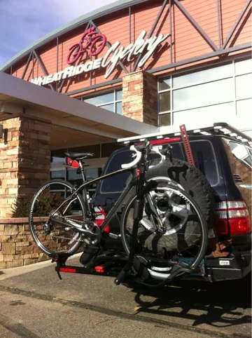

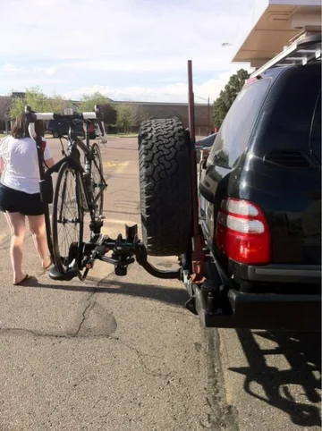

Just picked up a Yakima Holdup 2 from REI. 20% off and $30 mail in rebate made it hard to pass up. Was sold on the Kuat NV till I found this at this price. I can fit 2 bikes on it with my spare tire as shown but the closer bike touches the tire. I can't open the carrier and need about 6-8" to clear. Looking for a good extension that still keeps the rack solid. I like this style of rack especially because nothing at all touches the bike which is important to me for carbon fiber. So far after a 4 hour drive home I'm happy with how stable and secure everything is. This new version also has sweet built in cable locks that retract into the arms when not in use. You can kind of see the lock in the pics. The rack is also expandable to four which I intend to do once the kids get older.

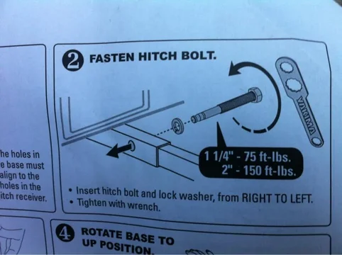

The Yakima uses a screw pin anti wobble system. There is currently no movement. I figured with a second screw pin extension it should be pretty secure. I found one from hidden hitch that I'm going to try. Will report back.

Swing out won't swing? Do you think there is any chance of this happening? Extension? How does it handle inside the receiver? Does it wiggle much?
I am going to try to pick up a hitch extension like This One. I just need to do some measuring this weekend so I get the right length. Eyeballing it, I need 8-10" to get the swing-out to work. The Yakima itself already has a screw-in style anti wobble mount so there is zero movement of the rack inside the hitch. All in all its a very stable rack. I figure the double anti-wobble setup should be just about as stable.
One thing to note is that Slee put's his pin hole too close to the bumper body, something that has always annoyed me about his bumpers. You can not fit the closed end of a wrench (or the wrench that comes with the rack) on the screw-pin so you have to use a open end.
