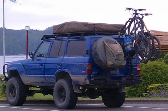

If I had a swingout tire carrier, I'd use something like this
http://www.thule.com/en-US/US/Products/Bike-Carriers/SpareTire/963XTR-Spare-Me
Butt
I've noticed recently on the road that a couple of these types of spare tire mounted rack have multiple mounting holes to accommodate offset spare locations.
The bigger issue you will run into with these (and all 'post & arm' style racks) is that the arms only work well with traditional diamond frame designs. Modern, full-suspension frames and most kids bikes don't mesh well. I had a Kuat Alpha a few years ago and it only worked with about 1/3 of the bikes in my quiver. If you are a mostly a roadie, or are rocking old school mountain bikes, this won't be a problem. If you are into fancy carbon designs or huge DH rigs, stay away from racks with arms.
I then switched to the Kuat NV (in the pic in this thread) and it cleared the 35" BFG KM2 on my fj40.

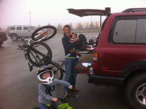

I have what looks to be the Yakima hold up, it works great & I love it, you may need a 2" extension receiver that you can get from just about anywhere. Thule makes a similar rack that locks the bikes, but it goes straight out from the hitch, the Yakima curves up slightly, also these will fold down flat so you can access your rear doors or tire carrier, or fold up so you can parallel park better w/o bikes. But if your just getting started both of these are expensive, maybe just go w/ a hitch mount bike rack that hangs the bikes (w/ the hitch extension) off Craigslist to save money & see if you're gonna use it as much as you think!
This is the rack I have!! On my s10, I think an extension would be needed to clear your tire rack! Kinda fitting that I was parked next to a troopy!!!
Did the same thing as WXM. Works easy, inside the truck so that it does not cause excess drag, bikes are kept clean, dont have to worry about people messing with bike. For a 60 is can cause issues because you have to drop the back bench which means you can only have two people riding but for me that is just fine. Simple and cheap and I have oriented the block so that I can actually fit three bikes in there if I really need to.
