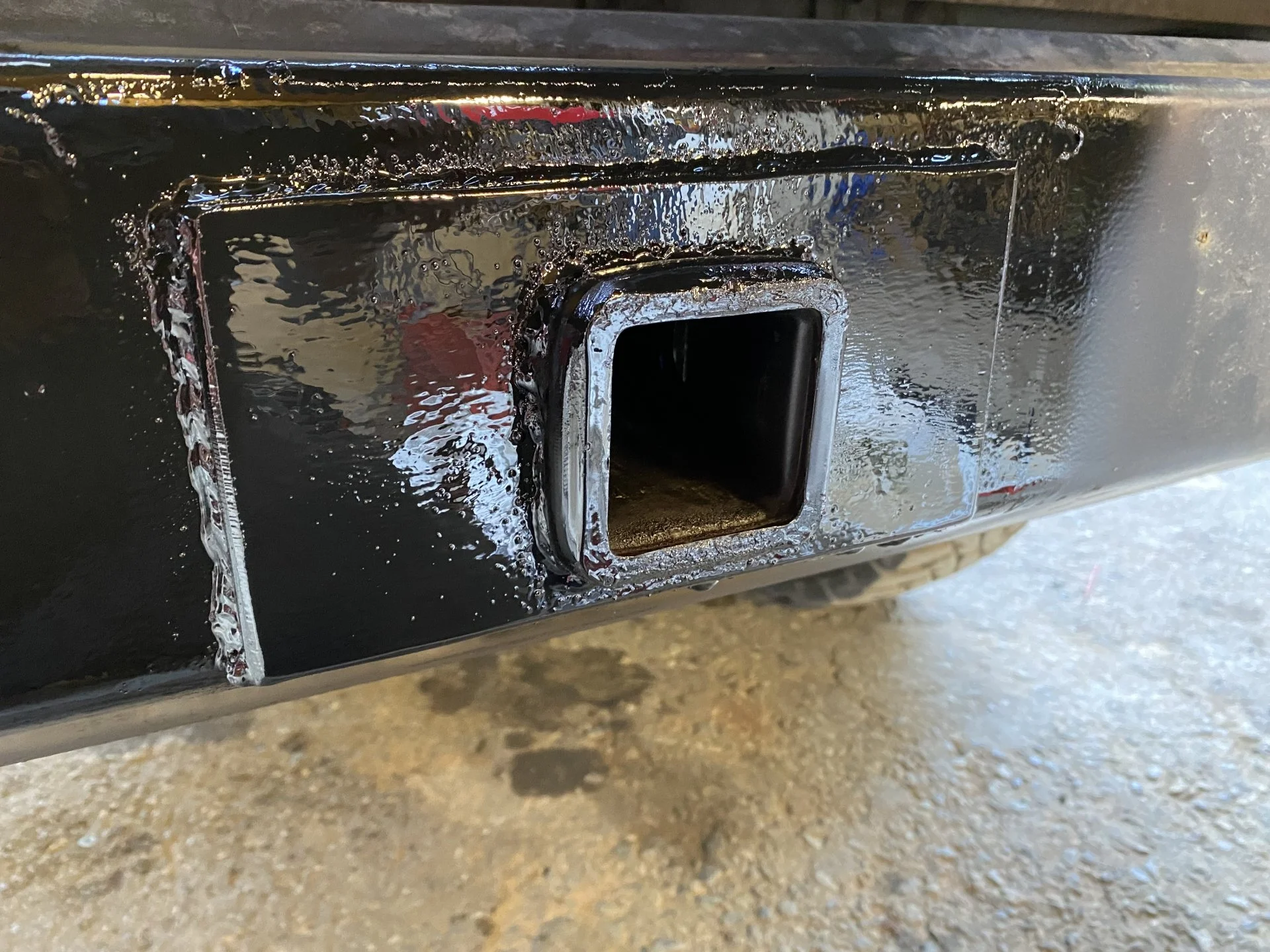

I almost bought the Curt receiver but then I found some 3/8
scrap and made it so I didn’t have to worry about hanging down too low.

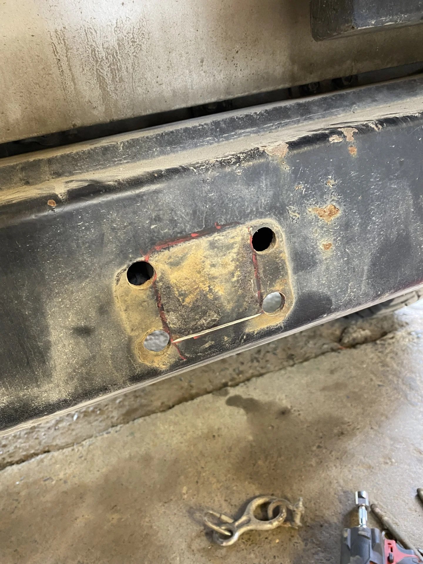

it was a bit of a chore tbh. The receiver piece is welded to a plate which bolts to the OEM crossbar at rear behind the receiver. Welding in there sucks btw.
At least now I can slide whatever accessory hitch I want in there…specifically my new work trailer and a bike rack :)
