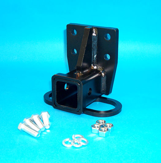

I’ve looked everywhere for one to buy but no luck. Can only find 2” receivers that won’t work because of bolt pattern. Can anyone fab one up for me? I wanna have it bolt on just like the current one Thanks

I won’t be towing anything. I just wanted some place to put wood etc. when going camping. I am going to use one of these. I thought about removing the step on the rear bumper but I wanna keep it. I would love a 2” receiver but a 1.25” receiver might have to do because of bolt pattern. Thanks for the help. I think getting one made is going to be the cleanest look on the bumper

I took the step off but I’m having no luck finding a hitch. Only one that I can find that would work is the CURT one but I can’t find a bolt pattern so I’m unsure if it will fit. Even tried calling CURT, I just get an automated machine that puts me on hold forever. Nobody ever answers. Someone wanna make me one?
