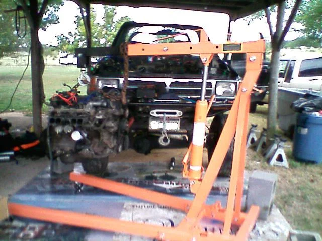

The guy that will sell you a Jasper for $2300 is allowing himself about $500 profit, which is fair I guess. Lots of engines go together in basements, car-ports, garages and pastures. Cleaner is better, but sometimes you just have to go with what you have. If you can afford it a long-block is nice, and Jasper is fairly trust worthy as long as you aren't ordering a 2F. Here is a picture of my clean room, plenty of engines have gone together right here.
