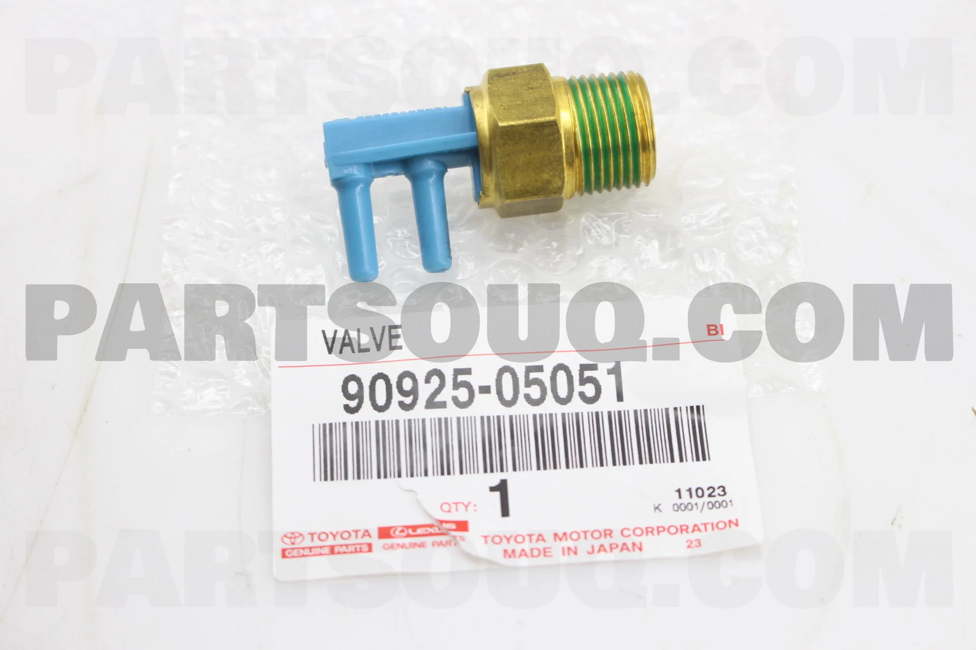

Has anyone found a substitute part number for the BVSV yet? if not, I was wondering if anyone could put a hole in my logic before I pull the trigger and purchase one.
When I use my Toyota parts catalogue CD and punch in the discontinued part number 90925-05052 and suggested replacement 90925-05056 using Amayama, at the bottom of the page it comes up "other vehicles this may fit" and listed is Corolla KE70 - Engine 4KC and the obvious 12HT.
Link 90925-05052
Link 90925-05056
I have cross referenced the Corolla KE70 BVSV - Engine 4KC with a part number 90925-05051 and it is available
Link 90925-05052
The purple 90925-05035 which was my first choice, after some research does not cross match any model numbers that the existing 12HT BVSV shares.
Any info or advice would be great.

Just completed a rebuild on my 12H-T and rebuilder chucked/lost the original BVSV and fitted another purple version, but seems to be closed below 40degC and open above so does not oeprate correctly. The BVSV to operate the idle up must be open below approximately 40degC and closed above. Open allows vacuum through to the idle up actuator. I am trying to figure out if the No 1 and No 2 designations refer to how the switch operates (ie either closed below temperature, open above, or open below temperature, closed above). Any insights would be appreciated. Attemepting to find a replacement part and only finding versions which are closed below temperature, open above.
Ordered 90925-05035. Unfortunately not suitable as suggested in this thread. Closed below 40degC. Open above. It does not activate the idle up actuator correctly (ie below a certain temperature). The search continues...
This is what I concluded a few years ago as well when I started this thread.
