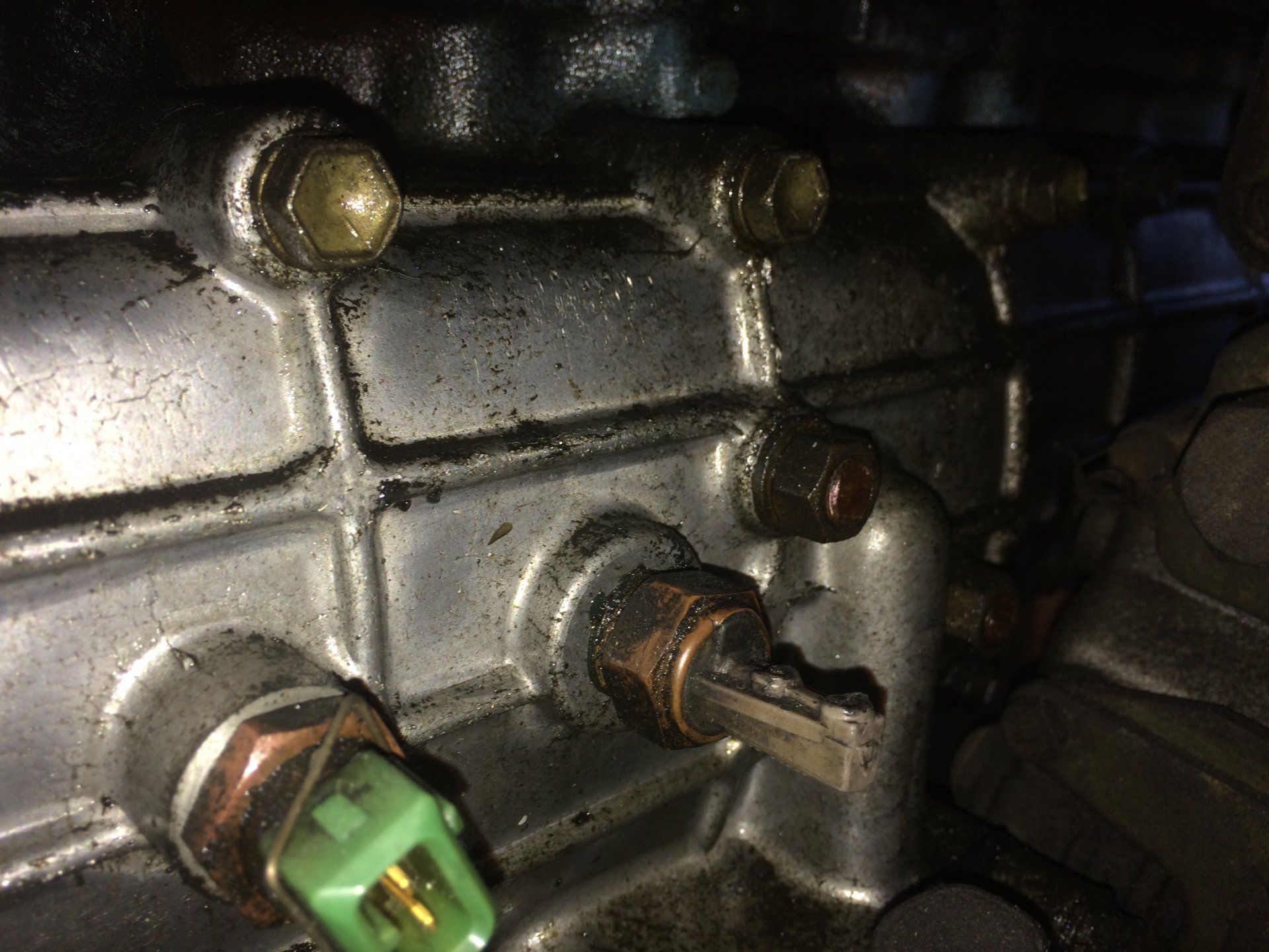

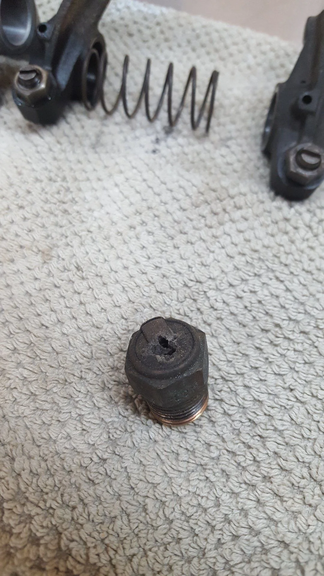

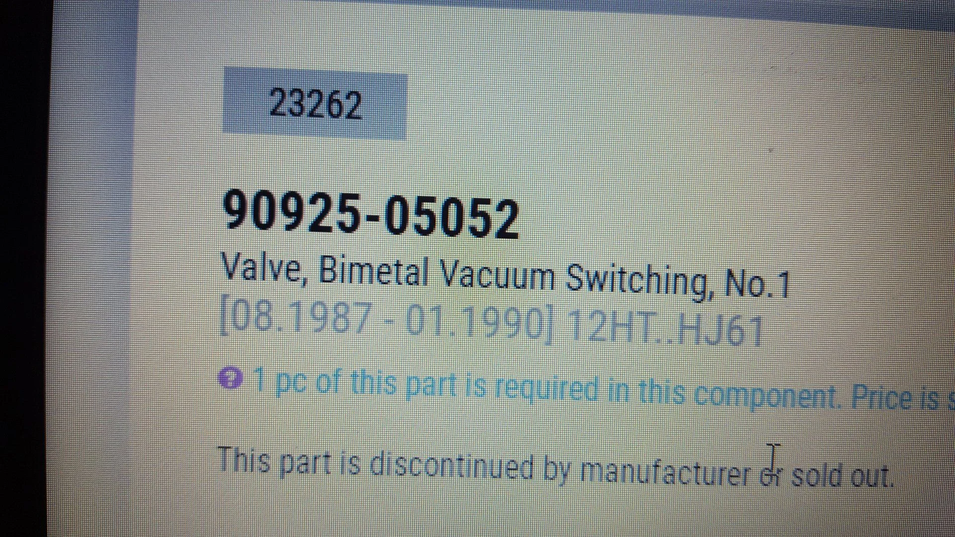

I wasn't quiet sure whether to post this here or in the 60 section but since this is technically for a 12ht I'll start here. I'm looking for a replacement BVSV for my 12HT. This operates the idle up when the engine is cold. I know the correct part is no longer available but I believe there is a replacement part that operates in a close enough temp range. The original part number is 90925-05052. I tossed my broken one I think so, I don't remember what color it was. I know the colors on the various ones dictate their operating range. I remember reading a thread a while back referencing the temps and colors but cant seem to find it and it's making my head spin. I also don't recall which ones open or close at temp so that's making it more confusing for me as well. The one I need should close at a certain temp and normally be open. These bi metal switching valves were on all models of gasser and diesel cruisers and I had this one laying around from a 2f that I used to plug the hole until I find a suitable replacement. It is 90925-05046 Thanks in advance

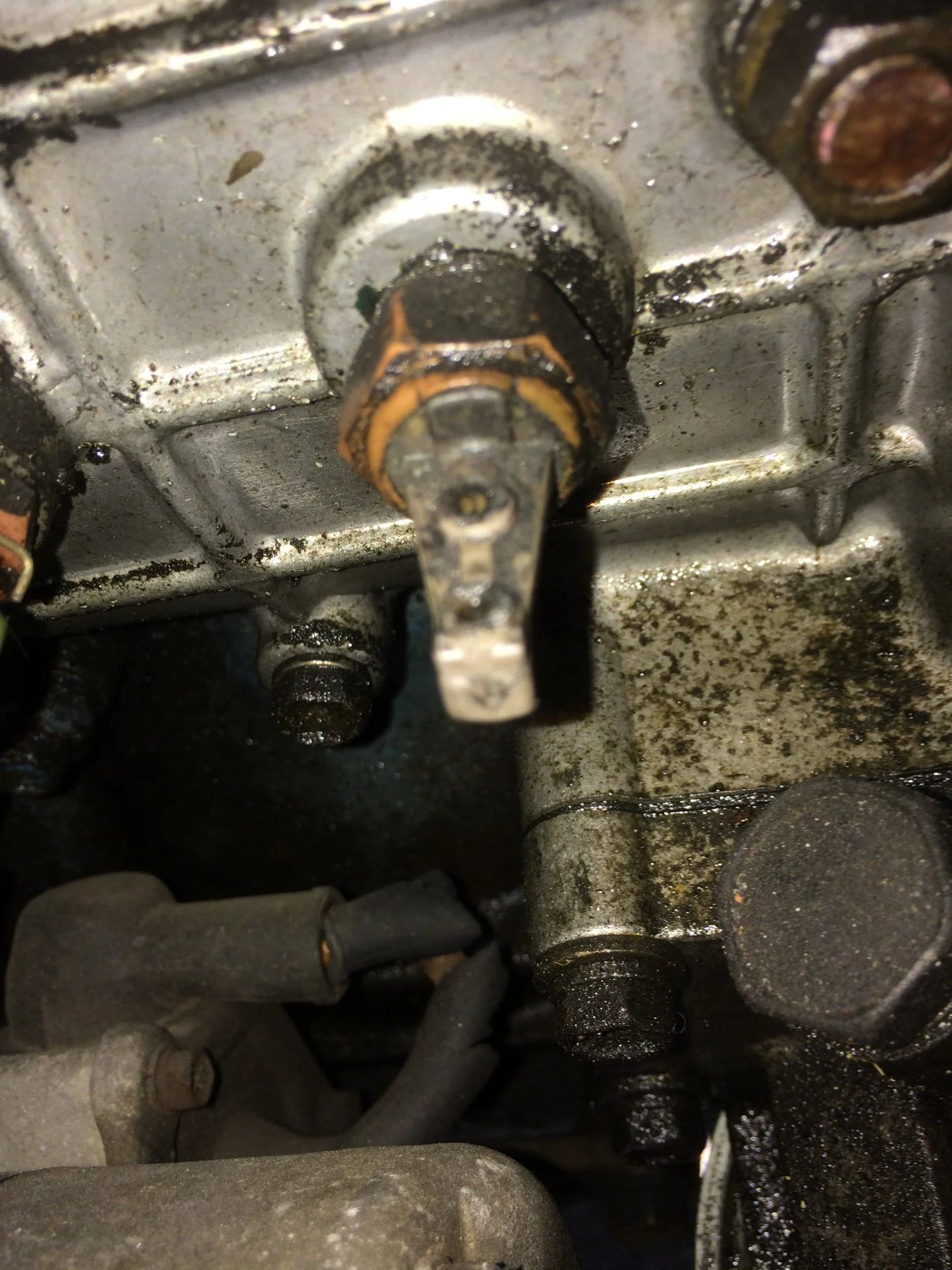

not sure whether they are purple or pink as seen in photos by @roma042987 and @coldtaco above, i just had a look at mine and it seems to have lost its colour
Some of the mauve ones seem to fade to that colour. Its probably from the 30+ years of heat and oils.
You could probably work out the faded colour with some cleaning and sandpaper

Here . It has the same part# as Onur suggested 90925-05035
