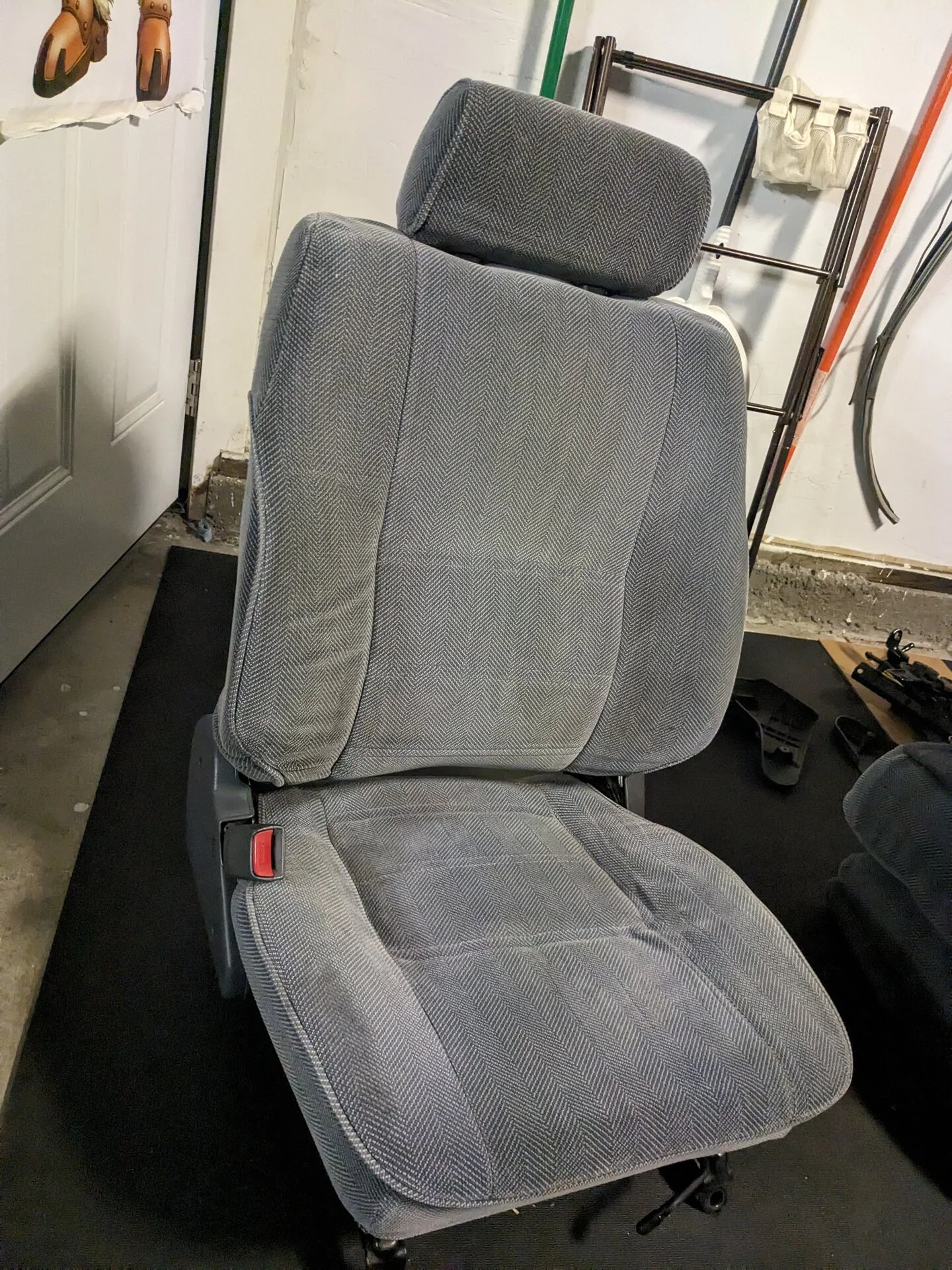

Hoping to get it done (at least on one side) this weekend. Long lead is cleaning the fabric and letting it dry. I wish I knew how to sew in some light foam to replace the bits that are attached to the cloth on the back side of the fabric that's degraded.
Need to add three extra holes to the foam to tie in the back side of the front of the fabric and you also need to cut a little off each corner of the bottom of the cushion. Looks like it'll work! I'll make a full video once it's all done (waiting on some extra hog rings).
It may not look impressive but it's a solution to the NLA manual seat back cushion problem.

And the part for the power seat back cushion is "only" ~$100. About half as extensive as the bottom cushions.

Please be more specific. As far as I know, the only seat combinations from the factory for the US market are power leather and manual cloth. Early 91-94 might have had some leather tossed on cloth manual seats by the dealer, but in essence there's just two types of seats from the factory (cloth manual and power leather).
You comment seems to indicate that there is a "leather option" besides what I've just demonstrated. And to restate, I've demonstrated that the back cushion for a power leather seat can be installed into a manual cloth seat (with a couple minor modifications to the cushion foam).

The video's now private -- but it looks like you were able to modify the foams from a leather/electric seat (upper back and bottom cushion) to work with cloth/manual seats?
