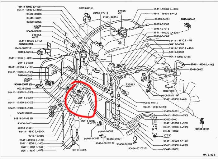

Another member sent me this diagram (thanks @sami ). The motor in my shop is set up just like this. I believe my issue is the coaster motor does not have the BVSV on the side of the block along with a few other things. Can someone explain the function of this? I assume it's temp related.
View attachment 1471276 Another member sent me this diagram (thanks @sami ). The motor in my shop is set up just like this. I believe my issue is the coaster motor does not have the BVSV on the side of the block along with a few other things. Can someone explain the function of this? I assume it's temp related.
Confirmed...I don't have a BVSV. Not even a place to tap one. Is this
because it's a coaster bus motor? If so, is there a different vacuum diagram for the bus motor?

I only know of 2 vacuum diagrams for the 12HT. One for aircon equipped models and one without aircon.
Do you have a 24v or 12v engine? I think the Coasters are all 24v
What does the BVSV stand for?
Rosco, this is an AC motor. Interesting comment on the cut off valve. It makes sense since my motor runs for a minute or two and once the vacuum canister builds pressure the motor dies. I do have good oil pressure as well. Been running it quite a bit as I've been putting it together. Would like to see what that cut off valve looks like. Also, not sure what BVSV stands for but it's in the diagram and standard on 12HT's out of 61's.
That would be the vacuum operated idle up on the back off the pump for the air con and cold starts. It sounds like something is shutting the engine after start up that's why I was thinking oil pressure. Where are you picking up power for the VSV

VSV = Vacuum Switching Valve
BVSV = Bi-metallic Vacuum Switched Valve
BVSV are temperature sensing and normally in the thermostat housing. Their colors correspond to their opening temps.
VSV are either electric (solenoid) or vacuum actuated.

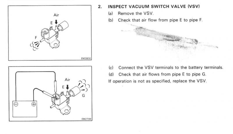

@roscoFJ73 and @ozcrusier I have a question. Someone questioned if i had the VSV plumbed correctly. I felt I did according to the vacuum diagram but when looking the the service manual it looks like the line out to the shut off valve it different. Look at these two pics and let me know if I'm seeing this correctly. I have not worked on this again as I have my turbo and injectors at a shop getting redone. Therefore I'm focusing on other parts of my build. However this one issue seems to keep creeping up in my mind :)
