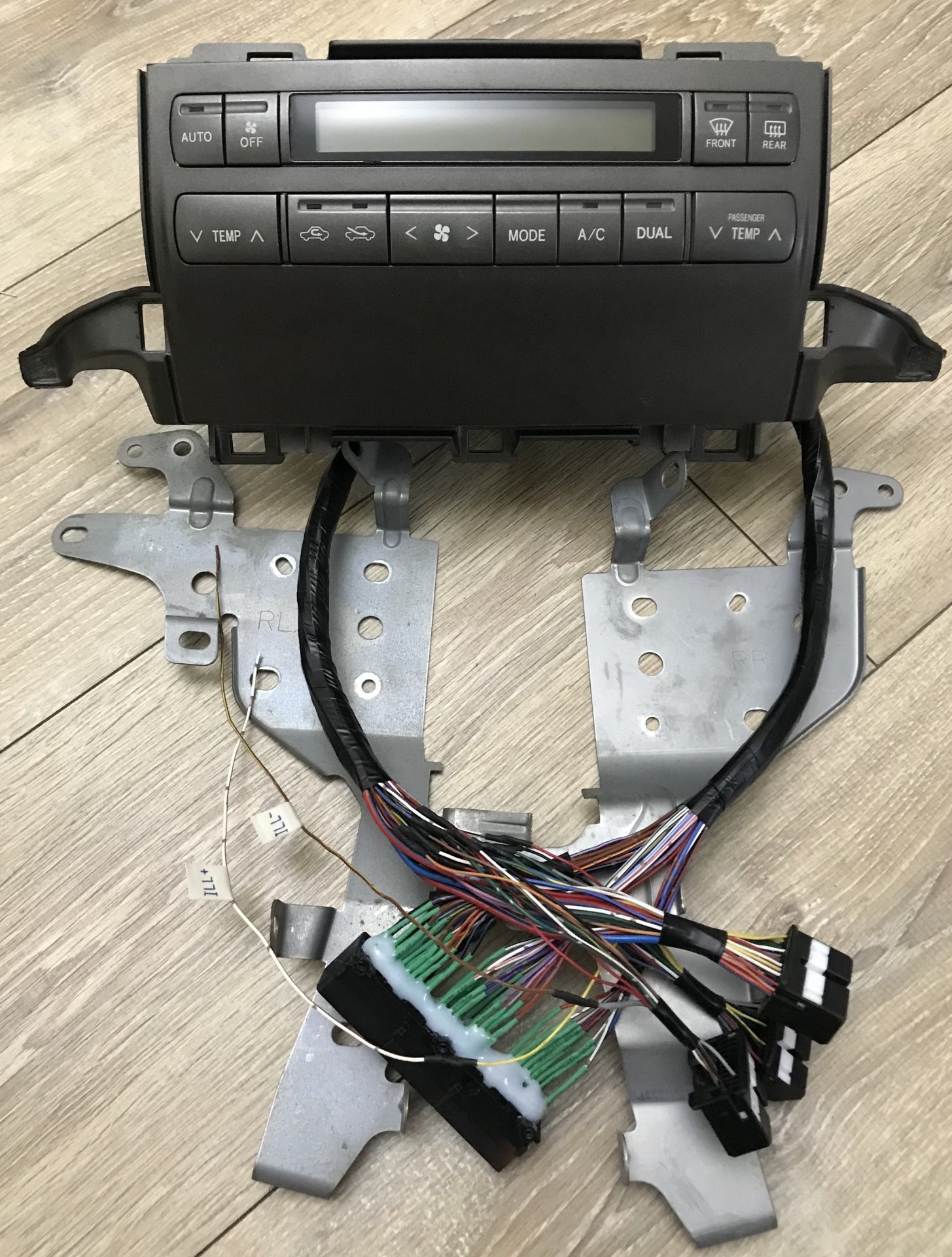

I currently have several climate controls for GX 2002-2009, 88650-60770, ...771, ...772, ...773. the price for 772 and 773 is higher, there are a couple of them in stock.

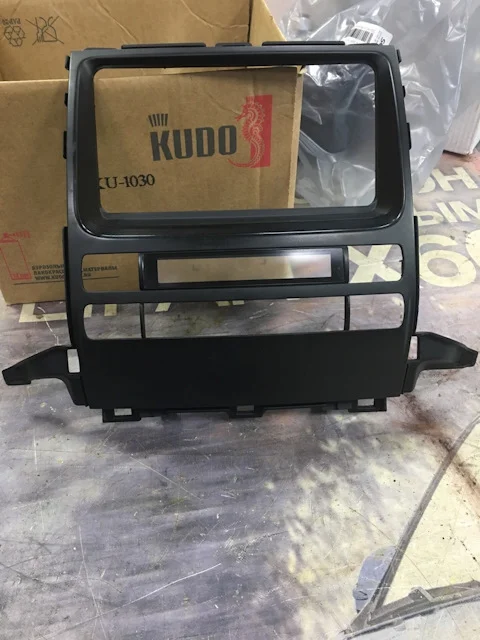

2. There are also side brackets.
3. I can solder the harness plug and play, it takes time and you will have to wait a few days.
4. I can solder harnesses for steering wheel buttons for radios with 3.5mm mini jack like in Pioneer, Sony radios.
5. There are OEM frames for 2DIN radios in black, if necessary, I can paint for an additional fee, in the color of GX470.
mail: zemeapp@gmail.com
WhatsApp +7(708)2820333

I currently have several climate controls for GX 2002-2009, 88650-60770, ...771, ...773. the price for 773 is higher, there are a couple of them in stock.
Eldar
