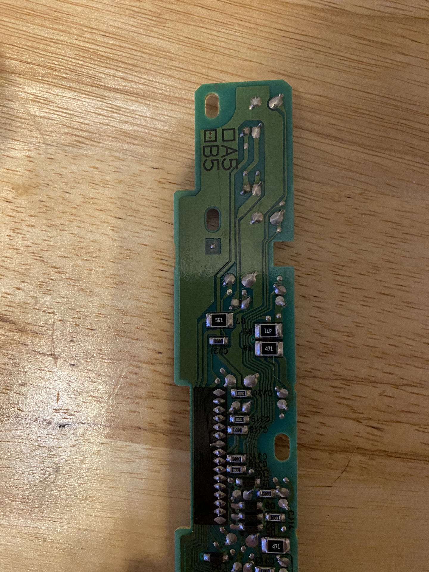

Per this thread it looks like the bulbs inside the non-nav HVAC buttons are replaceable.
However, it looks totally different for the nav unit HVAC. I disassembled the switch plate on my nav unit since it was just sitting in the closet, and they’re all soldered onto the board (picture below).
@binaryaudax can you confirm if the non-nav are actually replaceable, or are they soldered, too?
The non-nav uses replaceable incandescent bulbs to light up the switches and the display. The display is on with ACC and the switches illuminate when the parking lights are on.
The smaller lights on the switches that indicate the features are active (e.g. defroster is on) are soldered LEDs.
Thank you! That is such awesome in an otherwise frustrating week.
I think I will opt to replace all of the non-soldered bulbs with green LEDs. Figure if all the buttons and switches have the same green, and the only difference in shade is the green light that stays on when a button is pressed, my ocd will be satisfied.
My ineptitude with a soldering iron would just lead to the board getting cooked.

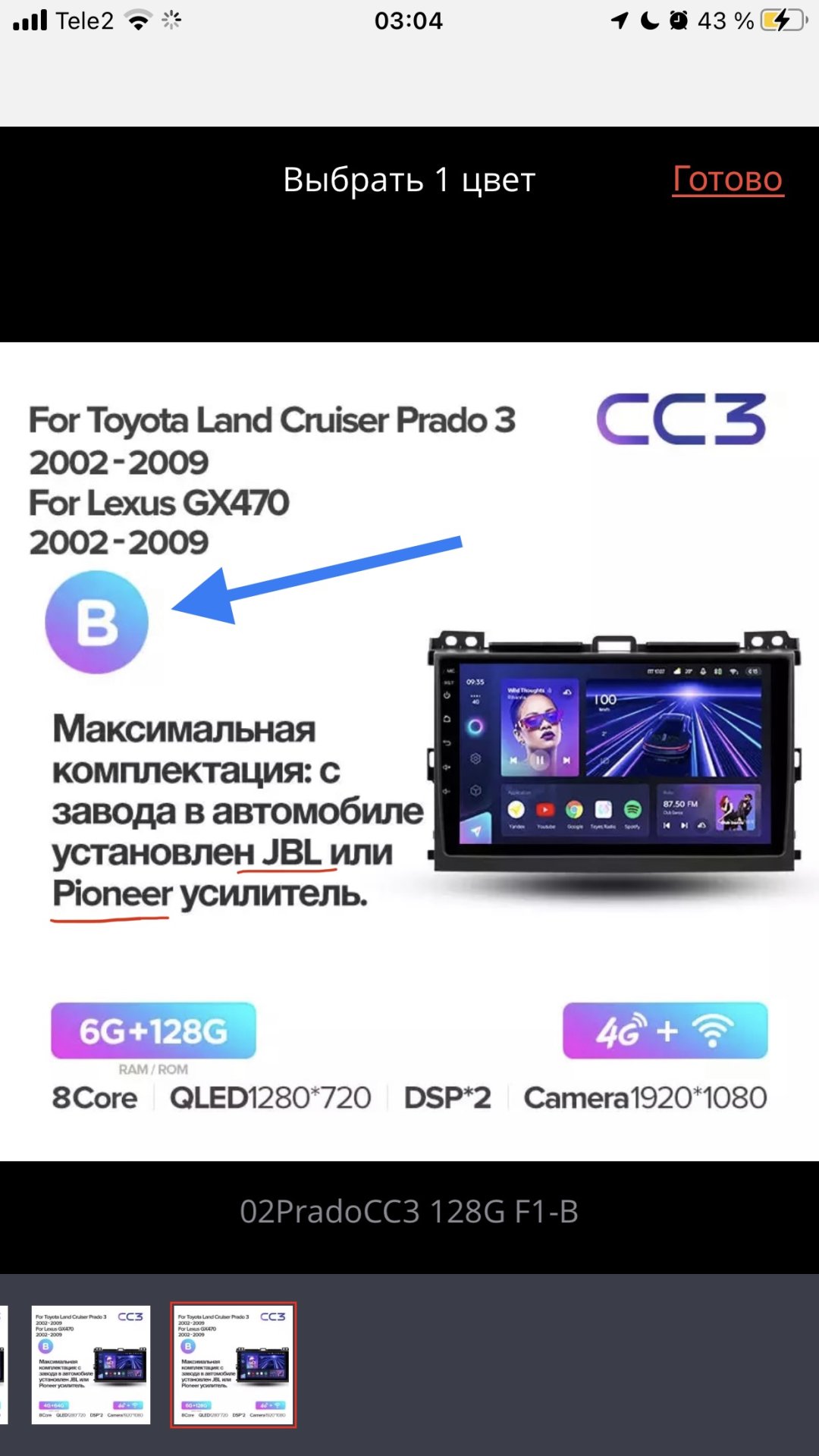

I was actually leaning towards the Teyes CC3 until Joying released their model with the physical volume knob. That was what swung me to the Joying.
Based on this flow chart: This flow chart from the GXOR FB group and this message on the Teyes CC3 product page:
It seems both the JBL & ML amps require an extra CANBUS wire to turn on the amp, while I guess the non-nav non-ML doesn't. 🤷‍♂️
