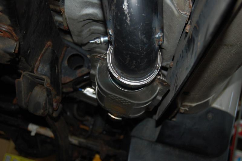

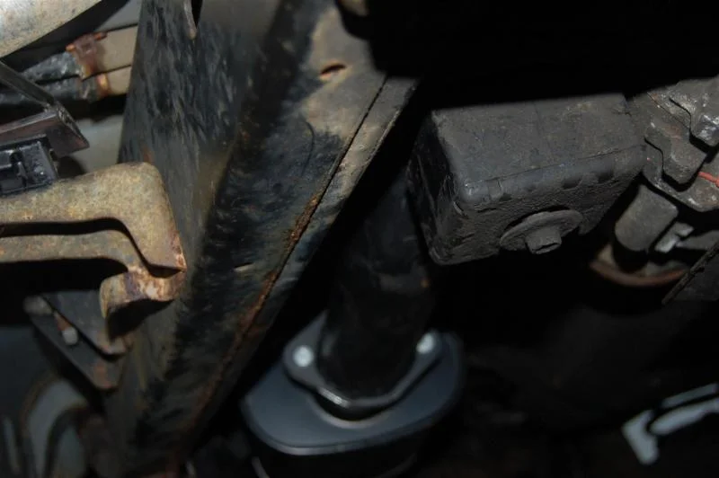

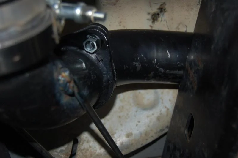

I thought I'd explain what I did for the exhaust.
I bought a RAGE big bore 3" system for a diesel 80. This system needs to be modified for use with OBDII so a cat was added and two O2 bungs.
Now that I finished the system there was an easier way to do it but I'll leave that for another day.
For a cat I bought a eastern catalytic Coverter which was ECO III and a 16" oval design.
For the bungs I when with what Slee off road offers which was real nice.
The Rage system runs the 3" pipe over the frame rail. In the present for a 95 plus 80 doesn't have the room for this. However if you swap out the rear shield for one from a 93-94 truck you get gobs of room and heat protection to go over the frame rail with a 3" pipe.
I havge a couple of pics attached but they aren't so good, sorry
