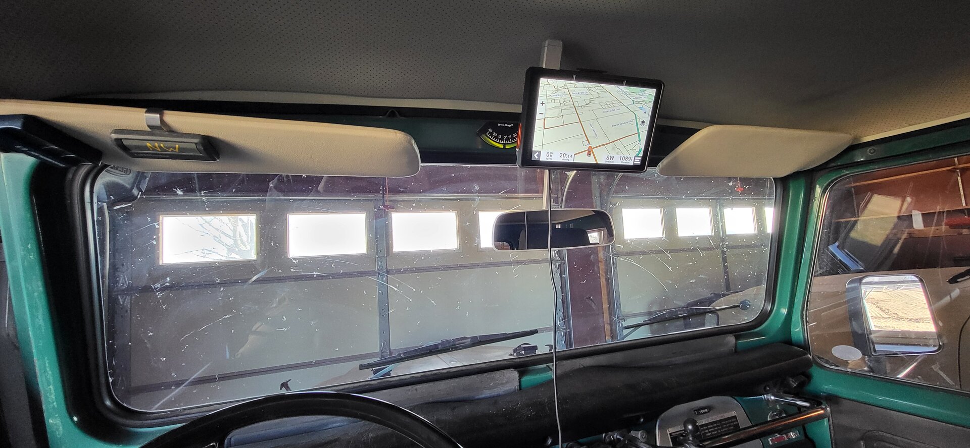

Made this little plate to use a mounting ball at the top of the windshield.
I'm ordering up a Garmin Tread for navigation in the 40, and thought above the windshield would ne the best place to do so since there is an acre of real estate between the mirror and the headliner.
Being in the shade, glare shouldn't be in issue.
I'll have to see when the device shows up.

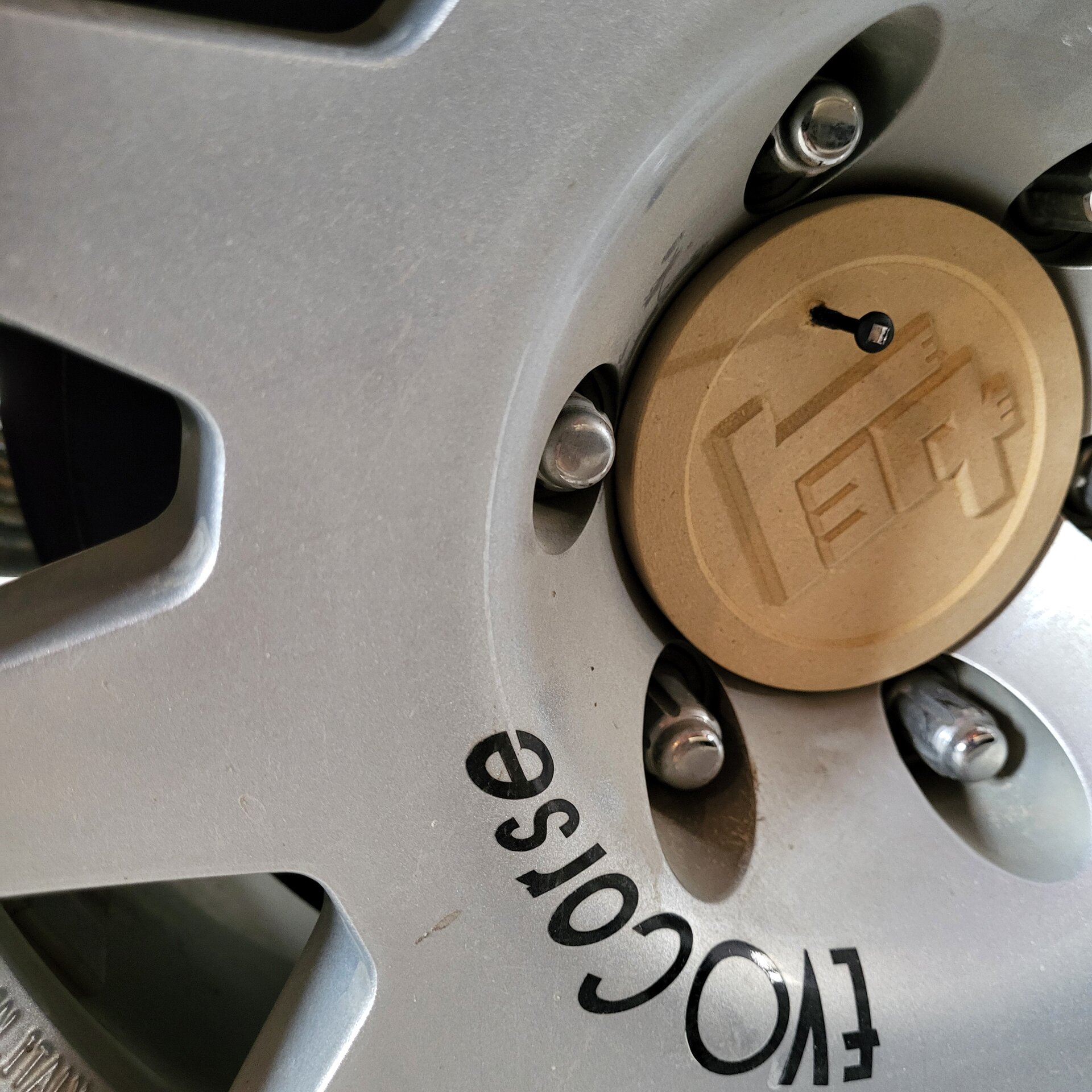

I'm real close on the center caps. The face of the axle flange isn't flat and is creating some issues that I think I have a resolution for. Until I get the face fitting the flange nicely, I can't set the actual thickness of things. These will be cut from a resin material for the final. Same stuff I made the switch panel and radio face plate from. I'll paint the recessed area silver to match(ish) the wheels.
(Screw in the face so I can actually grab it)

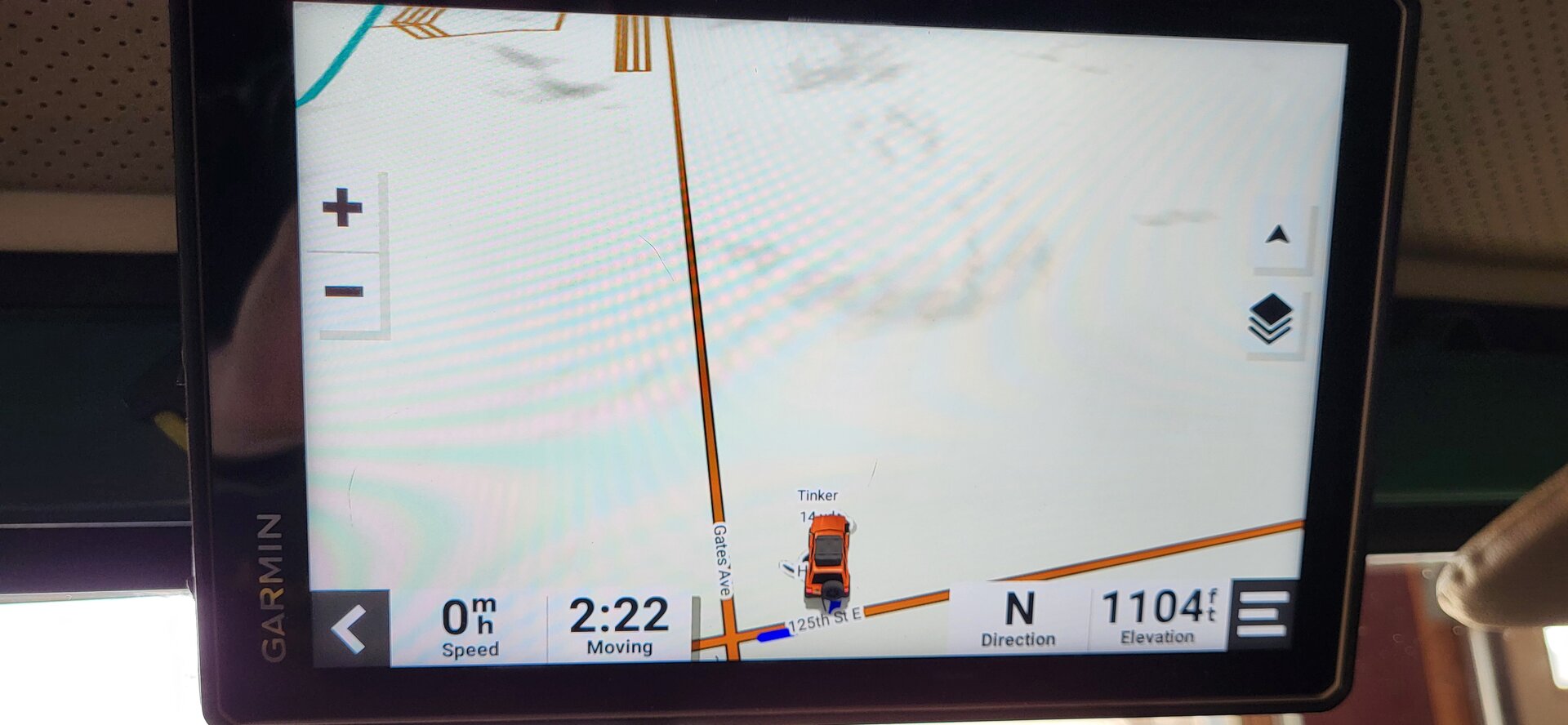

The cameras for the Garmin showed up yesterday. Took a look at placement options.
I don't like my options.
For the rear this was the simplest solution, but I've got a feeling being that far off center will bug me and the tire will block a lot of vision. Above the center of the ambulance doors is likely the best spot and also the worst for running the wiring.
I've got a 2" thick block of black UHMW plastic that I might try and mill out some mounting options. Or.... I'll stop being a bitch and just get a 3D printer and learn how to use it to make something
That does tuck up there nicely.
EXACTLY how I was hoping. My only complaint is the thickness of the magnetic mount pushes it aft more than I'd care for, but nothing I can do about it. So not a problem. Is what it is.
I don't care for how the front camera looks where it is sitting, but I think that is the most out of the way place.
Image is really good. I have it being trigger off of a relay in the console. The rear I think I'm going to put that on the switch for the rear auxiliary lights. So when they come on, either manually or when going into reverse, it kicks the rear camera on. I need a mounting solution for that yet and I haven't come up with anything good
The note on the screen makes me chuckle. I thought that's why I added the camera?
For perspective, I can't see the front bumper at all while seated.

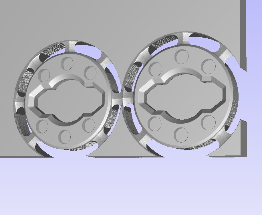

Started in on this project again. Machining some center caps to cover up the flange on the end of the rear axle shafts.
Front Side
Backside.
The six small round pockets will be for neodynium magnets. I think that'll hold them in place? Along with a .010" gap around the outside to the wheel.
I think. Probably. Maybe....
and the hole I'm trying to shove these into.
I need to cut one out of mdf to see if my clearancing on the back works, and if I like the dimensions of everything. Shouldn't be too bad on machine time. Last time I started this, it was something like 15 minutes to do the front face. I should probably make a third one to go on the spare as well.
