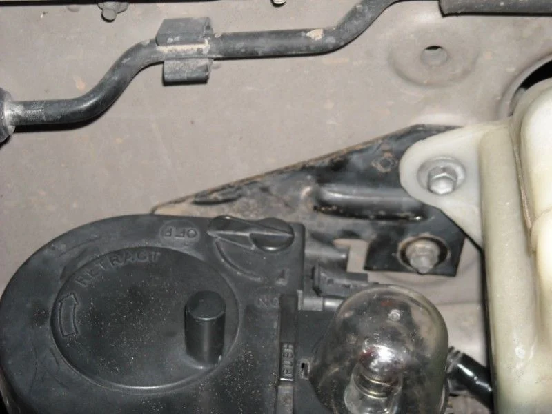

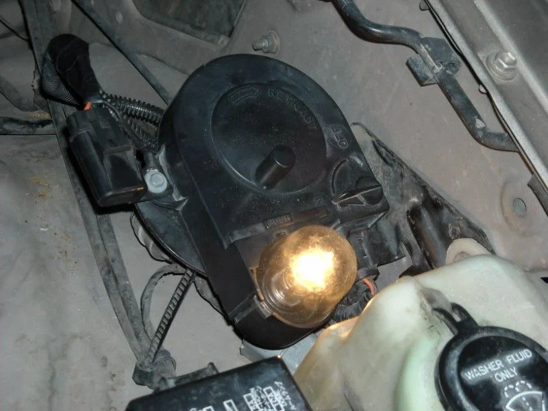

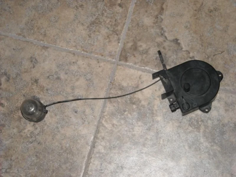

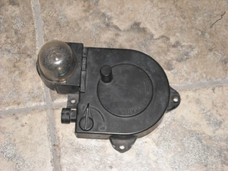

I think these are on 1990:ish to 1995:ish full sized GM trucks.
get one off the van if you can, they have a steel mounting bracket that is useful for mounting it, the other ones bolt to the fenderwell, usable, but not as easy.

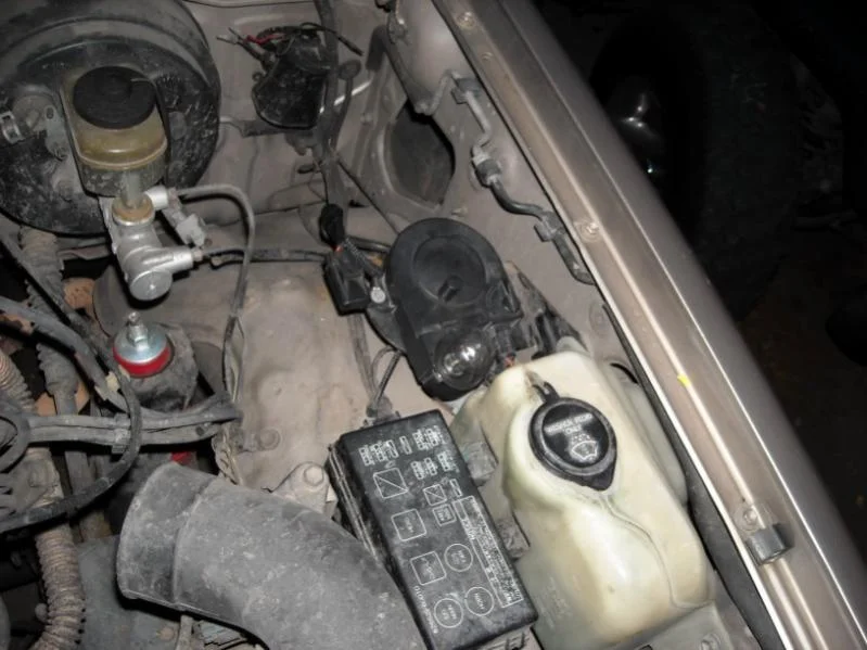

I used the mounting screw for the washer fluid jug, and a stud for the fender mount, they were the right spacing, and close the the fuse block.

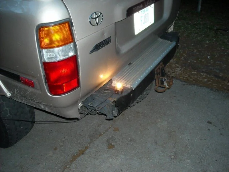

Here are some pics..

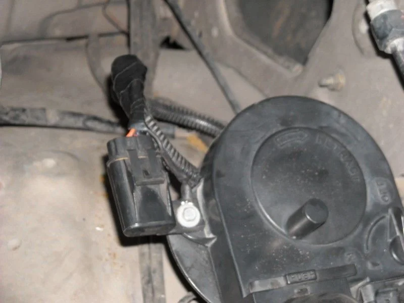

oh yeah, get the wiring harness from the van too, it has the cool waterproof blade fuse dealy..
a

the fuse block is right there, it had an empty spot with the power side plumbed, no connector for the fused side, so I just put a blade connector on the wire and pushed it in. The light has it's own fuse..
a
