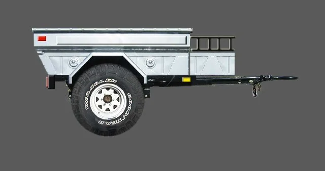

Pretty close to scale photo chop-
I like the photoshop design.... too cool for sure!

I didn't show it in the photochop but the long rectangles that run along the upper edge will be an E-track for holding stuff to the top.
