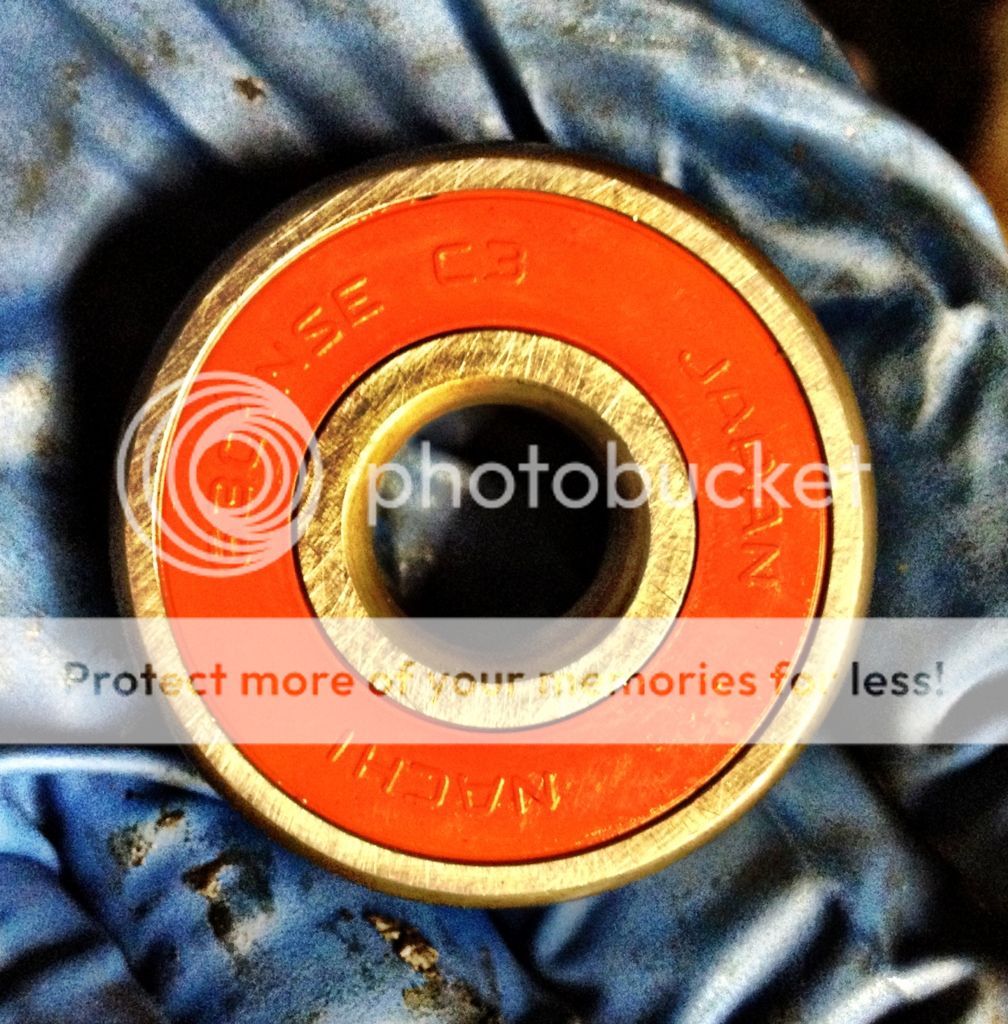

New Koyo bearing for the AC idler pulley from eBay.

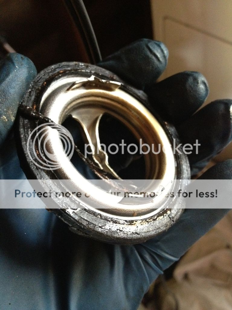

Dug in and found this gem:
http://i680.photobucket.com/albums/...-91E0-059A5272F1FF-45185-00001AC112DD7DCD.jpg
Neat, huh? :bang:

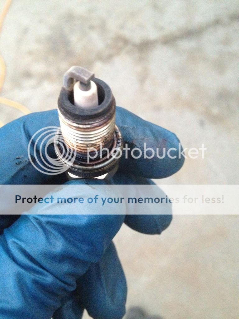

1st five spark plugs were unremarkable Densos:
http://i680.photobucket.com/albums/...-B219-157EDA25F649-45185-00001AC1A15FEB5B.jpg

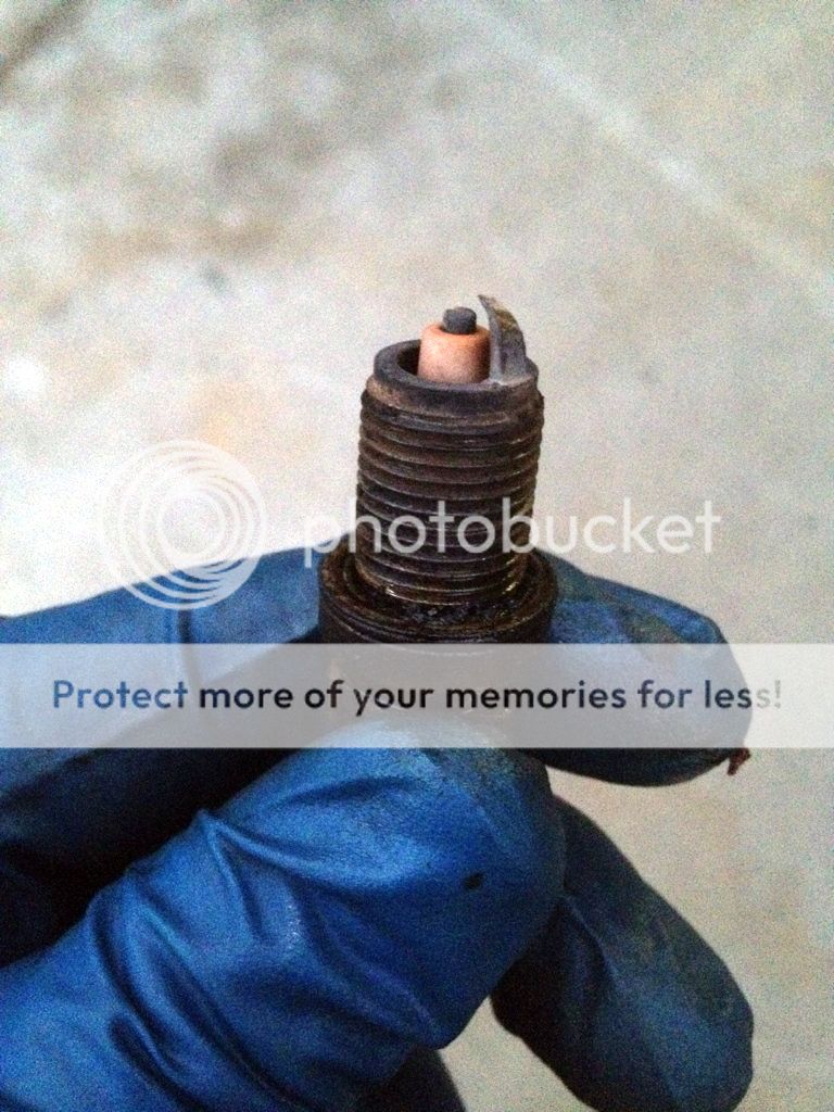

#6 was an NGK and probably original:
http://i680.photobucket.com/albums/...-AD6F-60B9EFD160A4-45185-00001AC1B1FAE810.jpg
:censor: :bang: I guess that explains the slight miss at idle.

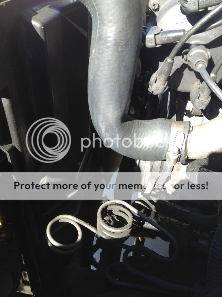

Gotta love the amazing fit of aftermarket hoses:
http://i680.photobucket.com/albums/...-935A-B8D4FC961856-45185-00001AC1A899B1C0.jpg
