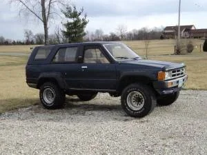

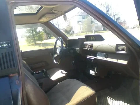

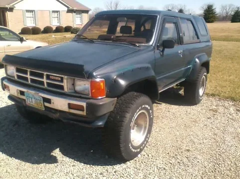

Runs great what should I do first?
Ya the tires need fliped but I got some 33 ill probly wait untill I crank t-bars and lift back end havent made up my mind on what to do to the rear just rig it with some blocks untill I sas or do it right the first time the rust isnt bad I checked had one hole on back corner fixed it only thing I dont like is the auto lockers they suck but I think I found some asins get some more pics when I can.
Very cool and congrats... I always liked those models!

Nice truck, wish my runner had the sunroof and SR5 center gauge cluster. In regards to 33's you will want to regear, I think you'll find the 4cyl even more anemic with that size tire. I have what amounts to a 30" tire on my 86 runner, I feel any larger and I would need to regear. One thing I would suggest is to do an EGR valve delete, send out the injectors for a good cleaning and clean/hot tank the upper and lower intake manifold, you will probably see some increased power and MPGs.
Nice truck and good luck!

Im trying to get all the parts for sas but toy parts in my area are getting hard to come by if I cant find parts ill probly put the money in gears it does pretty good with the tires that are on it cruises at 65 with no problem
