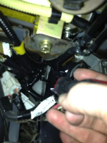

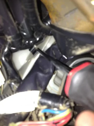

I did the antenna tonight. Not too tough really. First you'll remove the cruise control cover and the fuel module on the fender. Then there is one screw holding the antenna motor in place. Remove that. You can then pull some slack on the coax and wiggle the motor out and service it.
If you do what I did and replace it you'll snip the coax above the plug in the firewall. You'll see it when you pull the cord.
Next remove the fascia over the radio and the radio and unplug the coax cable. Unsnap the coax from inside the radio bay.
Then take off the glove box by unscrewing the two screws below the box. Remove it and follow the coax and unsnap where it is connected behind the wiring.
Then tape the cut coax to the fresh coax and feed it through hole in the firewall.
Then feed it through by pulling the coax from behind the glove box then behind the radio. Then reconnect everything and you're all done.

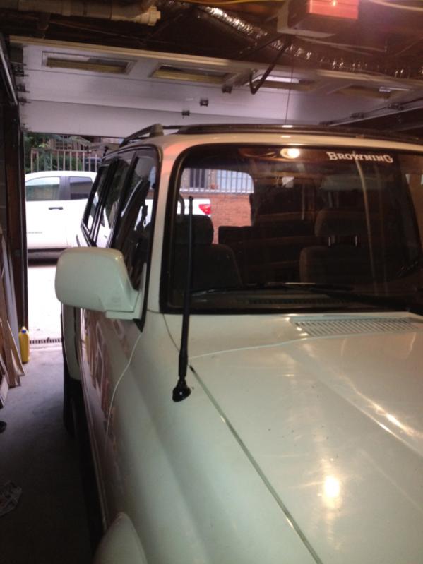

Has anybody messed with their power antenna to replace it with a normal not PITA type of antenna? My main question is, is the black cable taped on the top tube running into the dash the coax cabals into the radio?
Can I reuse it or do I need to use it as a guide to run new coax cable to the radio? My antenna was so corroded, when I tried to take off the crown cap it sheared off and now I have to order tons of parts or convert it to a normal one.
So I hope someone here knows how to mount a normal antenna and can help me...
I've replaced the whole thing once... easy to get to when you remove the fender.
Yea, I just went through the hole from the inside. It isn't too bad if you unclip the coax cable from the radio and two holding brackets. You can then get it out and service it but I decided to bypass it completely and put a whip antenna.
My motor still works if I ever decide to reuse it.
