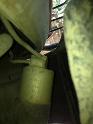

Got my Bars rear main stop leak today and will add. I also had the AC system looked at today and found my leak.
My line from the dryer to the condenser is broke. I will have to call Onur and get one. Any other ideas?
Also, what are you guys thoughts on seafoam?
Yep; that'll do it...
