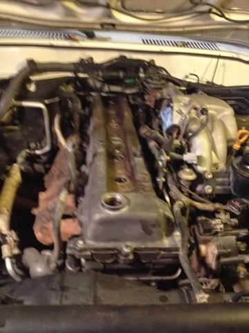

Since I have cleaned my engine I have noticed that the valve cover gasket is leaking for sure. I have noticed that there is what appears to be oil on the bell housing below the no.5 and no.6 exhaust manifolds. Would that also be the valve cover gasket leaking around the no. 6 exhaust manifold?
These are the pictures of the valve cover gasket area and no. 2 bank of manifolds. Sorry they are sideways.
And the second thing I noticed is when I crawled under it when it was good and warm I am leaking oil on the underside at all the normal places, but it seems more than a drip or three. It seems to be producing oil almost. The bottom of the oil pan from where the plug is is clean and dry except for one small area on the passenger side. It seems to be coming from the rear main much worse and from the passenger side near the back of the block.
The valve cover leak is worst on the back of the block, could that be trickling down and making it worse on that side of the engine? Also, how invovled would the rear main be to change and if I changed it or had it done, are the pan arches and oil pan gaskets easy to do at the same time?

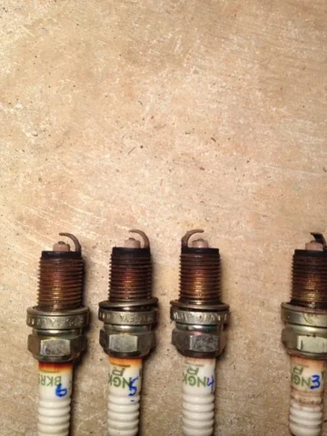

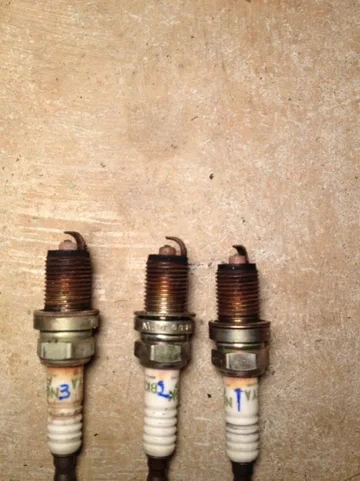

I will admit that I had nightmares last night I'd pull no 6 plug and find it steam cleaned or ruined. But they all looked the same. Also the original plug wires were still there. A few pics below.
You guys think the plugs all look normal, considering the age and all? No reason to worry about HG issues I would think...
