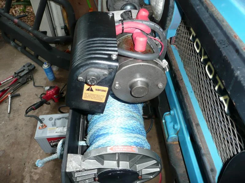

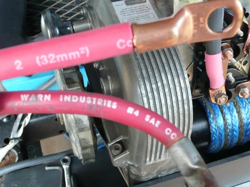

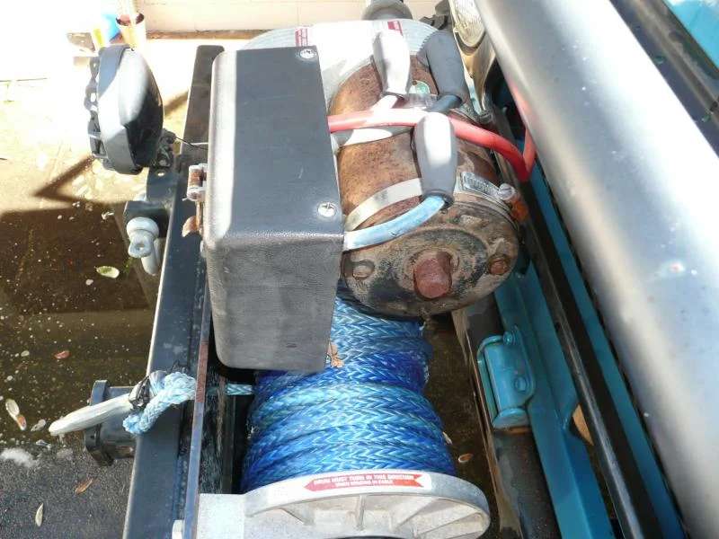

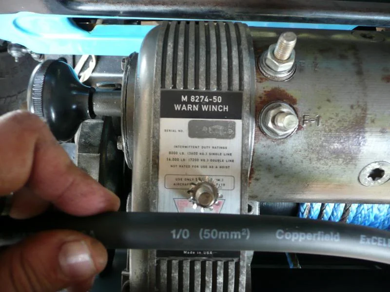

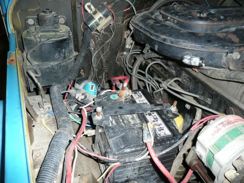

Anyway I'm was busy those days installing the ARB OLD Style front bumper, CB ant., Warn 8274-50 that i upgrade the selenoids wires from 4 ga to 2 ga and a main power to 1/0 with 300 Amp. fuse....next plans Saginaw PS, Metal Tech full cage..LTB 34x10.50x17 on FJ steelies....the list never ends..:meh:..thanks for all the inf and the feeling driving this old FJ40..its something that you just understand if you have ONE....:cheers:

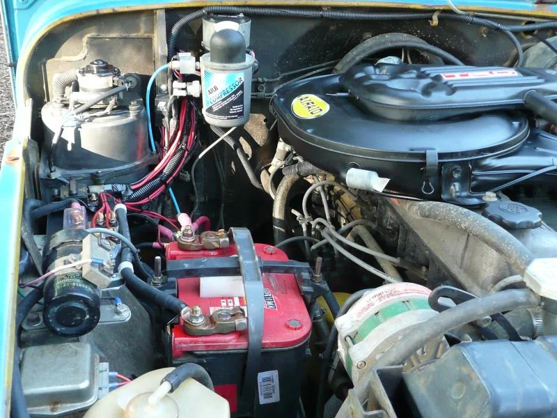

The battery wiring almost make me cry..when i open the hood...now its showing a decent JOB....:)
Well i start last Thursday and finish today by 11 00 AM..its enough for 4 days in a row....:popcorn: Enjoy the new Change:beer:
Nice work with the crimpers and welding cable! That should be a lot more reliable now.

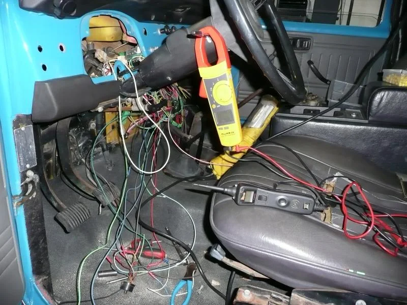

more changes to the inside harness

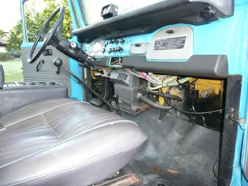

The inside wiring when i first got the 40,just call me for fix electrical problems.....no wipers, no flashers,no blower,also i change the light knob to the original location and install the oem wiper switch, no lights at the cluster.Now its look better and the way that should be.:D
