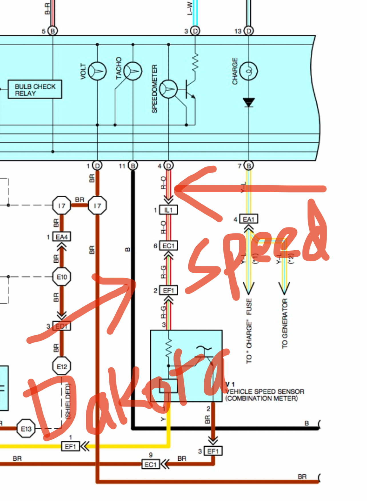

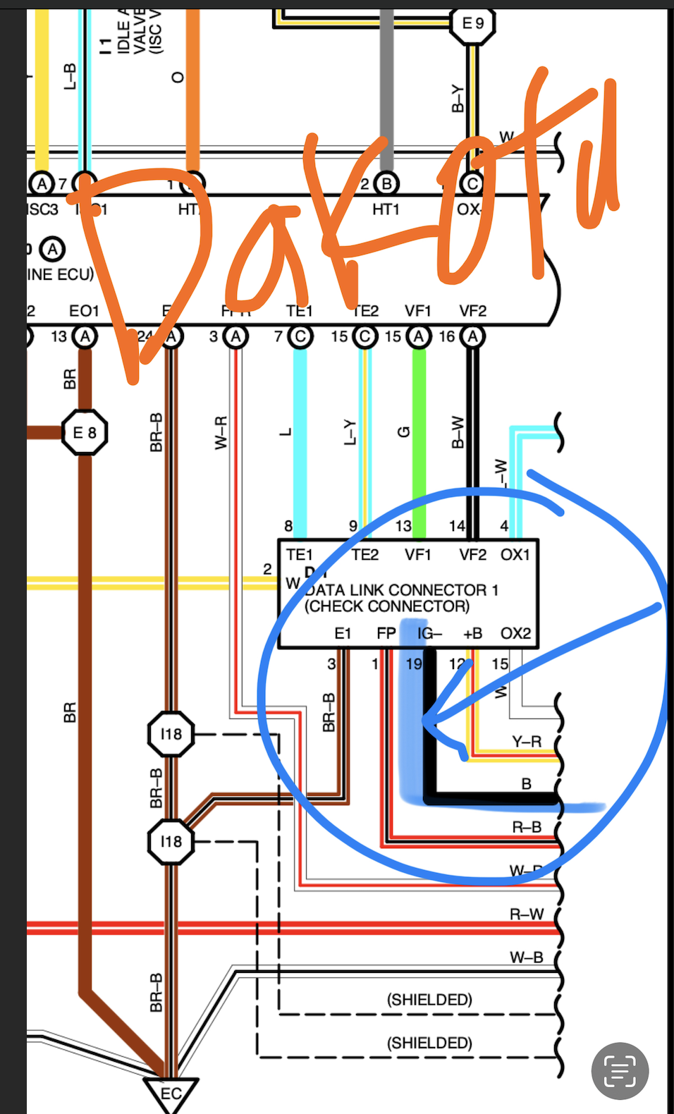

That is a nice ride. I used a Dakota box as well. I tried to connect the Dakota high voltage output wire to the black wire from the check data, that didn't work for me so I tapped it to the wire from the combination gauge. In addition, I ran the positive wire (from vehicle speed sensor) to the Red Orange wire and speedometer works for me. There may be a break in your ground or power wire from your speedometer sensor. Some people said you don't have to use the Dakota box for the tac to work.

1) Speedometer shouldn't be swap related.
2) Tach is easy, depending on GM ECM being used. Toyota's tach can be adjusted for different number of cylinder pulses or most GM ECMs can change its tach pulse frequency to match the Toyota tach (3/rev).
You do need to either pull-up the GM 5V pulses to 12V, or modify the Toyota tach to accept 5V pulses. You can spend money of a Dakota Digital tach converter, but not necessary and just adds more complication and cost to your swap.
Much cleaner done this way and one less thing to go wrong down the road.

Speedometer stopped working a few months prior to the swap. If my Toyota VSS in the transfer case is toast I might be able to grab the signal from GM's sensor mounted in the Marks adapter. Holley needed that for transmission control.
Appreciate the tachometer info. Need to do some more research on how to make it work with Holley.

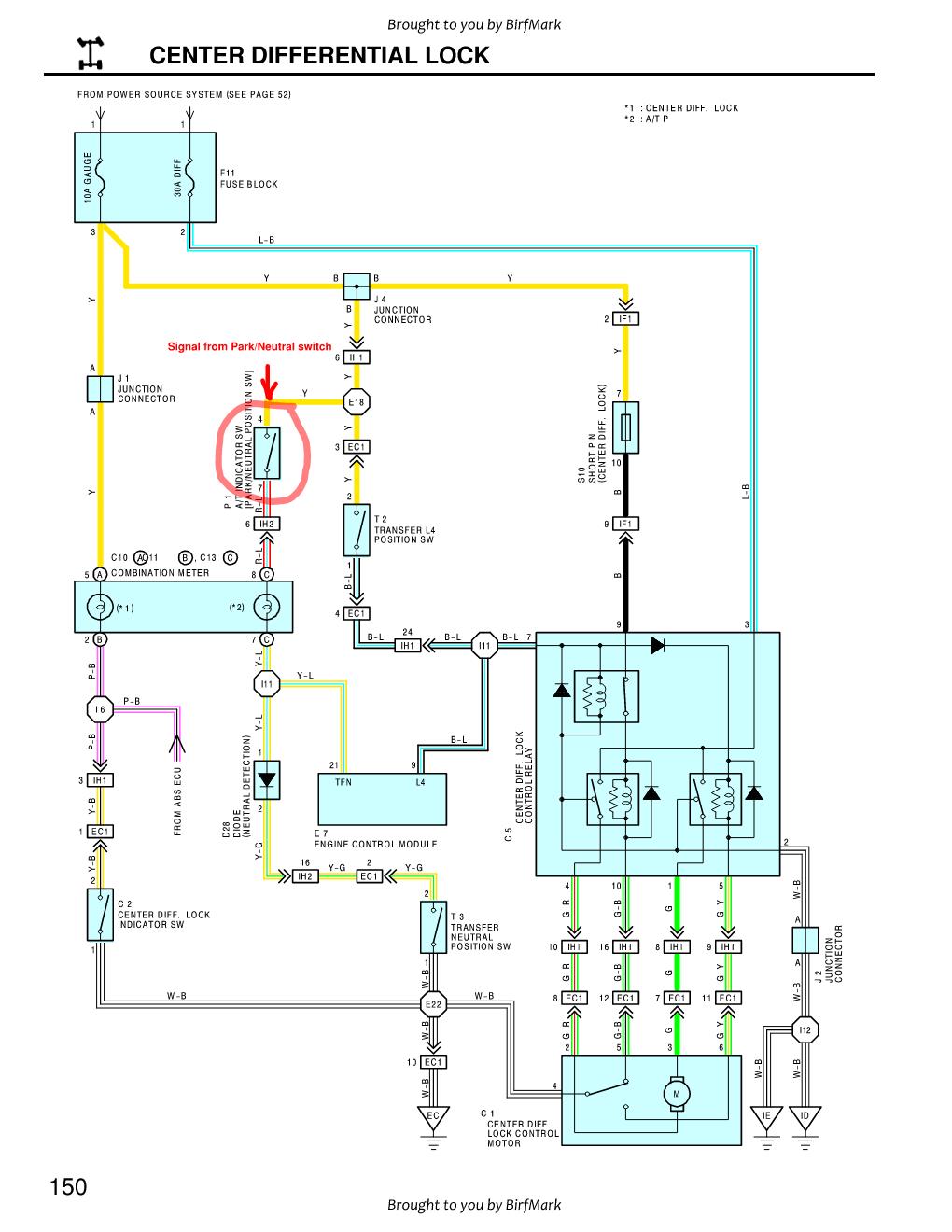

1. The center diff locks as it should when I put the transfer case in 4L, but the dash light doesn't come on. It will no longer activate with the switch when the transfer case is in 4H. Can't seem to figure out the wiring diagram 100% for now, but it looks like I need to add a signal wire form P/N switch to the IH2 connector (Red-blue wire).
2. Also, when switching from 4H to 4L and other way around it will not go in gear. The input gear is spinning and not letting me to go between H and L unless I turn the engine off.
Any help or advice will be greatly appreciated!
I only followed recently, so I am not sure what was done, or how it was done.
1. I would short the connectors to check bulb/wiring. All those t-case wires are not part of the swap and should have been retained.
2. Sounds like a transmission issue. Are you not in park/neutral when switching 4H <-> 4L?
