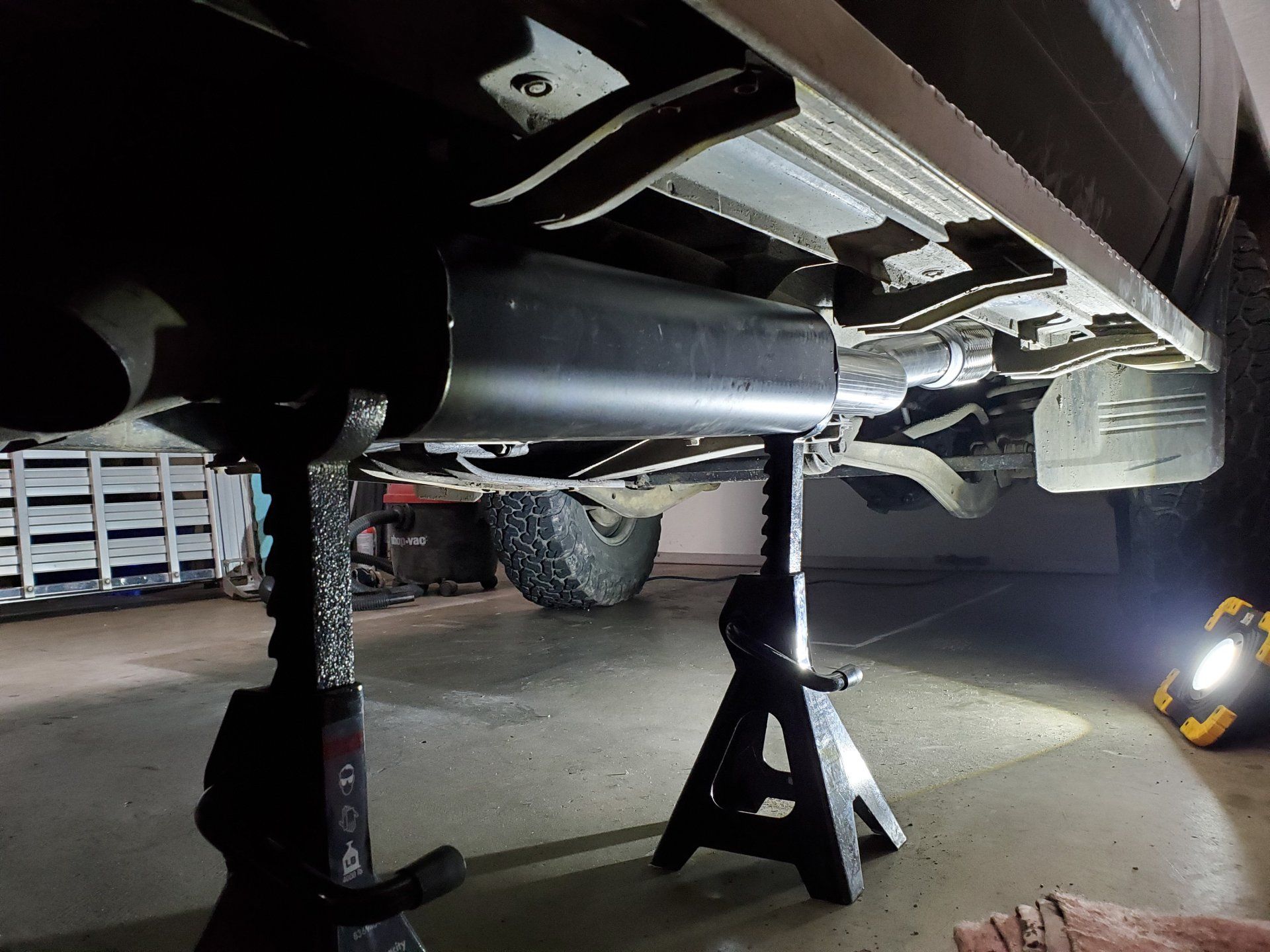

My down pipe cracked and I re did my rusted out muffler. I need to redo it all over again, because now my flange isn't sealing properly to the turbo and my muffler is hanging down to low. Here are some pics.
Pics of the crack
and here is my attempt at fixing it.... letting it cool very slowly....
my new... aka temp exhaust.

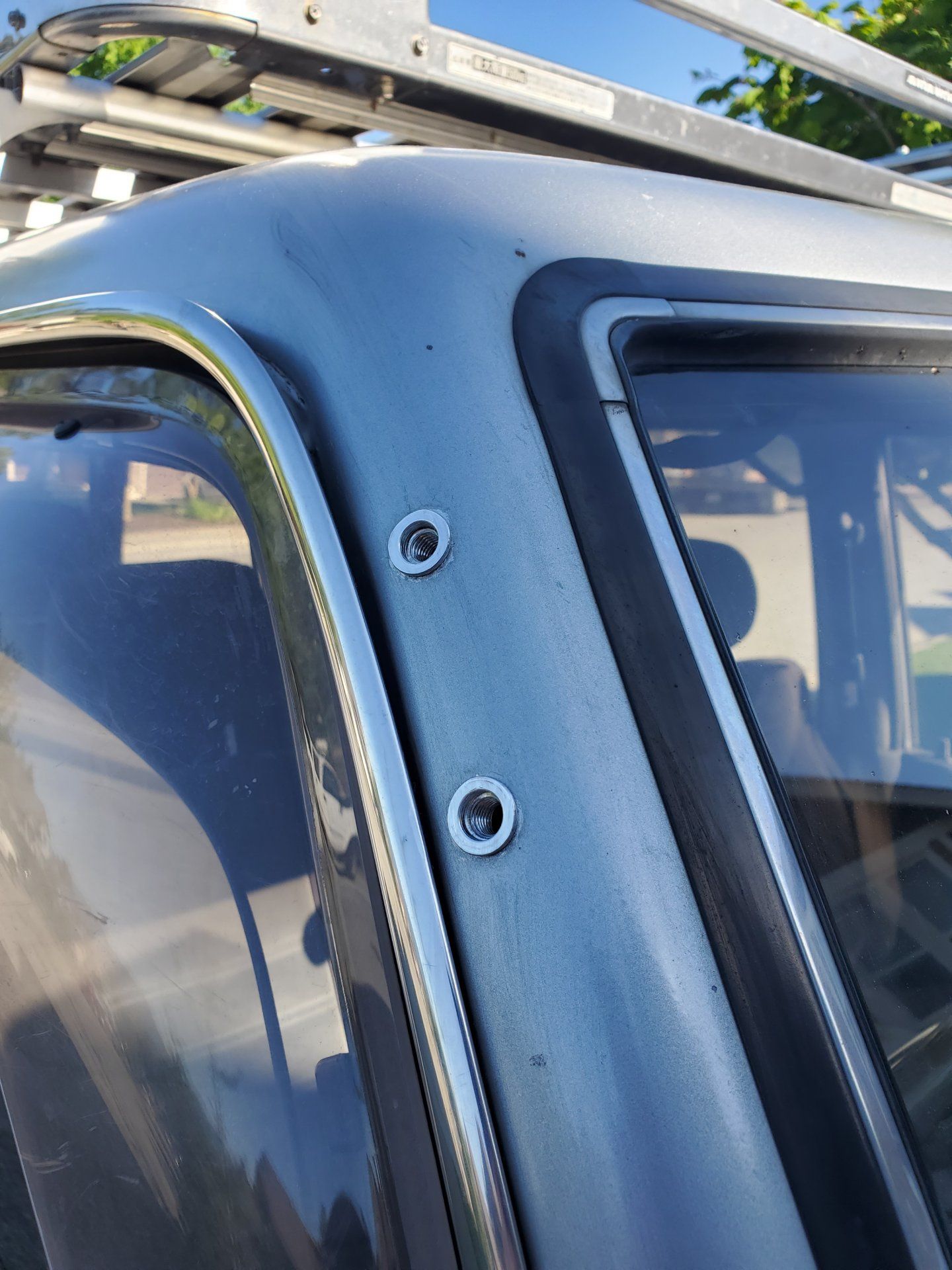

Now for the fun part, I installed a factory Landcruiser snorkel. I'm pretty sure this snorkel wasn't meant for this truck and I knew it would need a custom part to make it work, but I was up for the challenge.
Thats all I got, I had to borrow a thread rivet tool and 3d print my custom part.
Here is how I did it.... First figured out where the middle bolt needed to be, then once that was figured out and mounted I did the other bolts..
I had to turn down a bolt on my lathe and to fit in here properly then install the rivet nut.
When installing the rivet nut on every hole, I drilled the hole, deburred it, painted the metal and the nut with new paint and while it was all still wet I installed the rivet nut.
