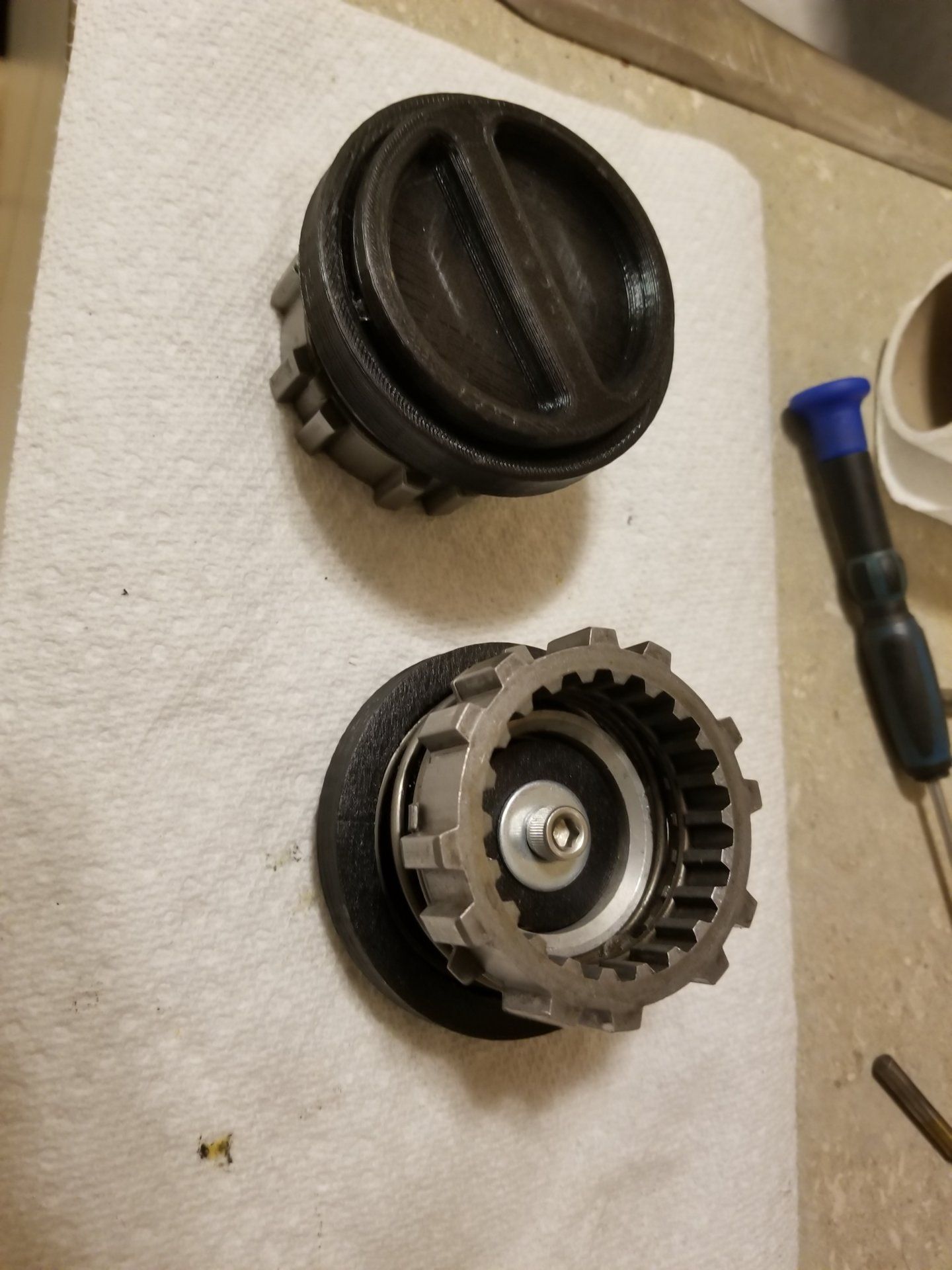

Now it was time to machine one of my spare hubs and get the plastic parts to fit. Here are some pics of me taking them apart.

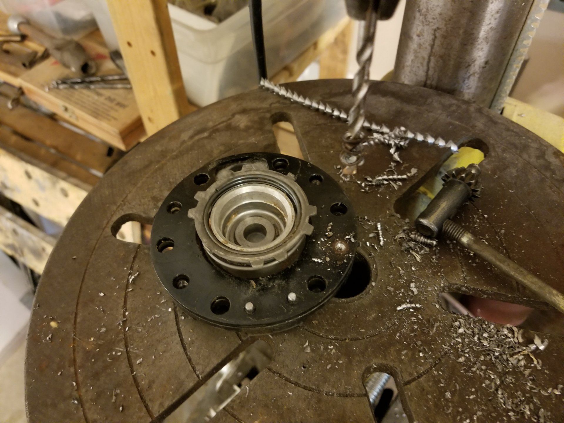

First thing I noticed was the four T-20 screws I had to remove. Out of the two hubs I could only get 4 screws to come out, even with heat and brute force. I ended up drilling out the rest. (reassembled them with only 2 screw in each one in the end)

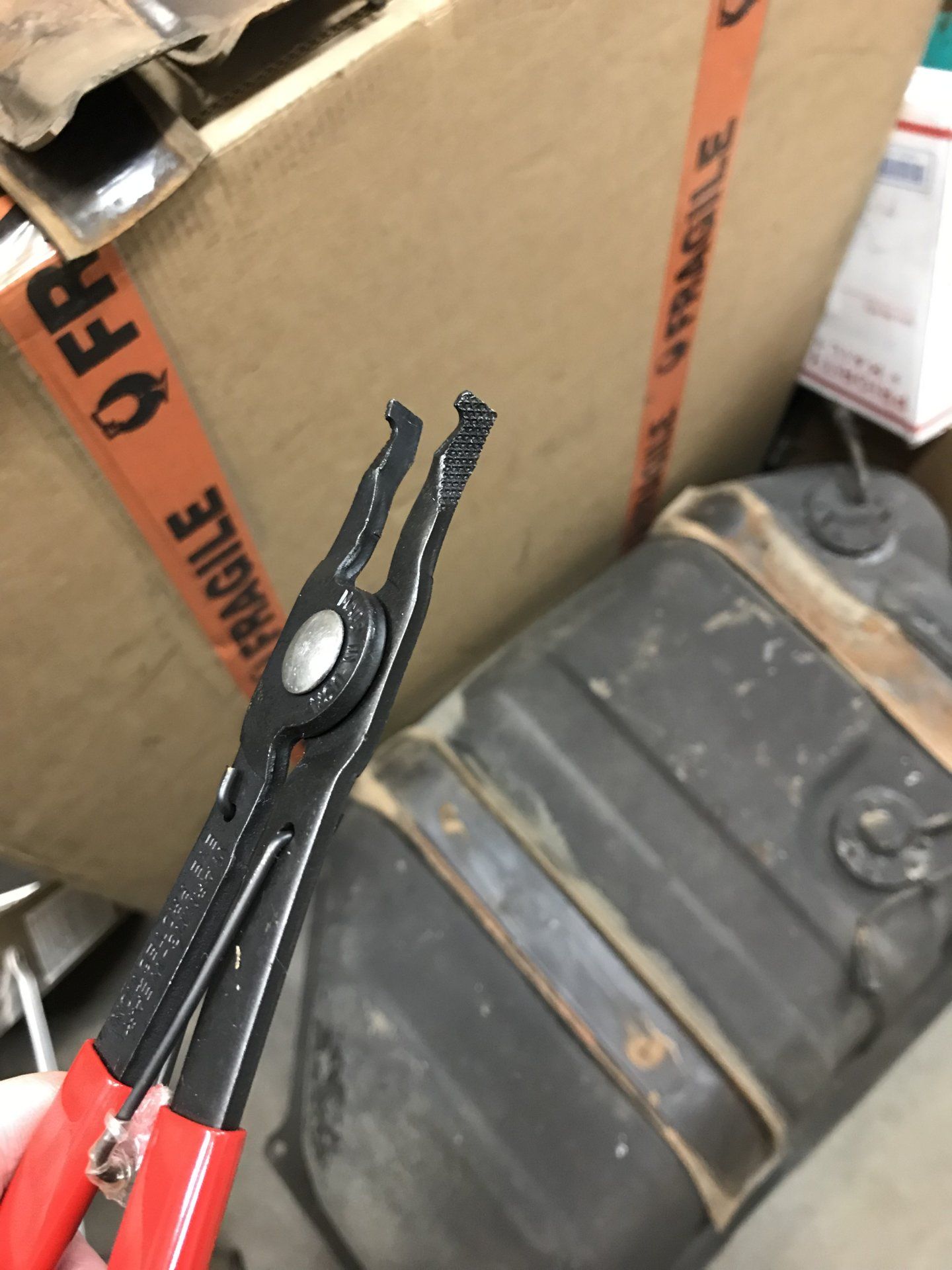

Also I had to take out this pain in the ass clip.

and then clean everything up... (I think I'm missing a washer in this pic)

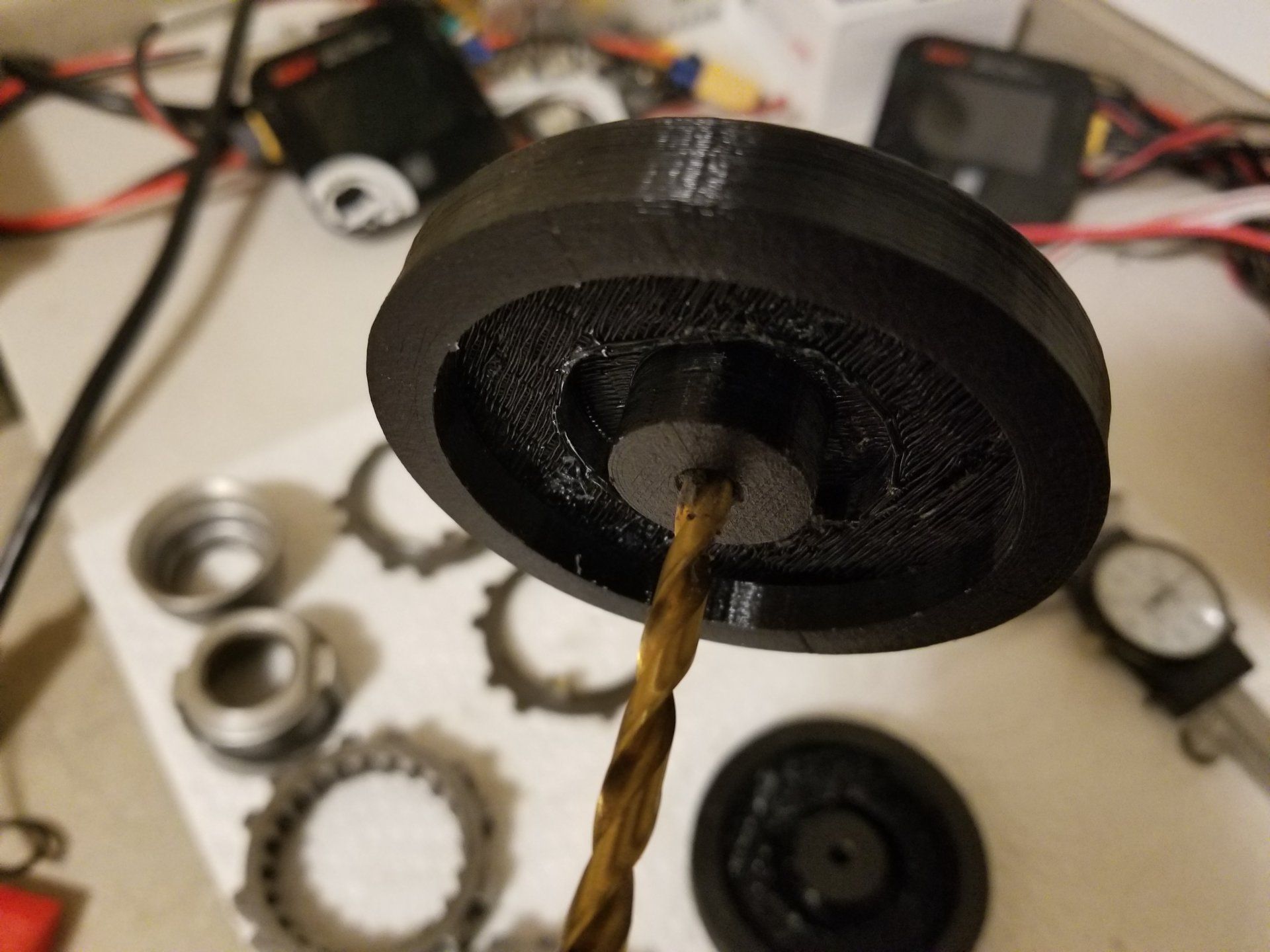

I had to drill and tap these parts, even though this isn't absolutely needed with this design because when everything is assembled having it all together makes it hold together on the hub. The screw is there just to hold it all together while you assemble it and install it.
Now I just chased the hole with a 0.201 (tap drill for the 1/4-20 tap) and tapped the hole by hand.
