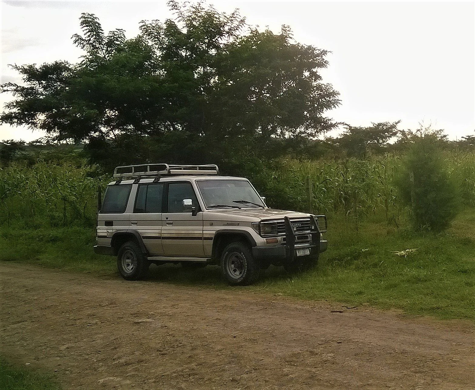

First off, thanks for these great posts, helpful!
Being that I'm in a third world country here, I don't really have easy access to many third party parts...which spacers are these?
If I can get the dimensions/specs I'm could get them machined here easily I'm sure (front/back)
I'm also wondering about how much Toyota shock absorbers would allow there, and if an inch or so spacer would mess it up... my Toyota ones are fairly new,
Btw Old Man Emu/ARB absolutely useless (or maybe lack of interest) in letting me know if there are any vendors in C.America...

I got the spacers off ebay for reaaaaly cheap. Cheaper than it would be for me to buy the aluminum and studs and machine them myself.
Just search "2 Toyota 1" Inch Wheel Spacers Adapters 6x5.5"|12x1.5 Fits All 6 Lug Pickups" on ebay..
Not too sure on the second question about shock absorbers...
Most 4x4 parts stores online carry Old Man Emu.. shouldn't be hard to get information from them.
