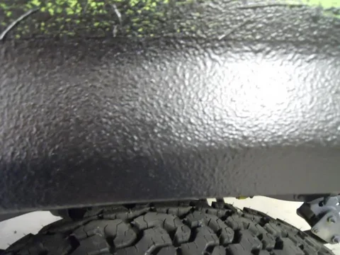

My black monstaliner on the 60 has weathered the Vegas sun beautifully. I've had it on for about a year and am very happy with the product. Enough so that I am about to do the same liner treatment on my Tow rig.
Ive used herculiner, Duplicolor, Some 3M version, and one I can't remember and Alpha liner. So far, the herculiner has stuck on better and weathered better than any of them. Admittedly the alpha liner was a professional job but it faded fairly rapidly.

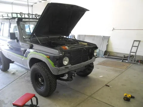

Plan on having this on in a couple weeks. In the final stages of body work on my 60.
I'll post up pics as soon as there is any progress.
Here are a few pics of the kit to get started.
J
