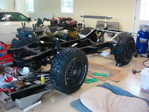

Then my wife :princess: surprised me on Father's Day with these...
17x8 American Racing Mojaves with BFG KM2's 285x75.
It appears the 17" rims clear the steering arms but I may need to run spacers to keep from rubbing. I really dont know yet as Ive yet to set tub on the frame.
I have grown to really like the look of oem steelies with skinny BFG's but I guess I will keep these...;)
I am so glad you posted this picture as that is the EXACT wheel and tire combo I am going wiyh on mine! Great job on the build!
