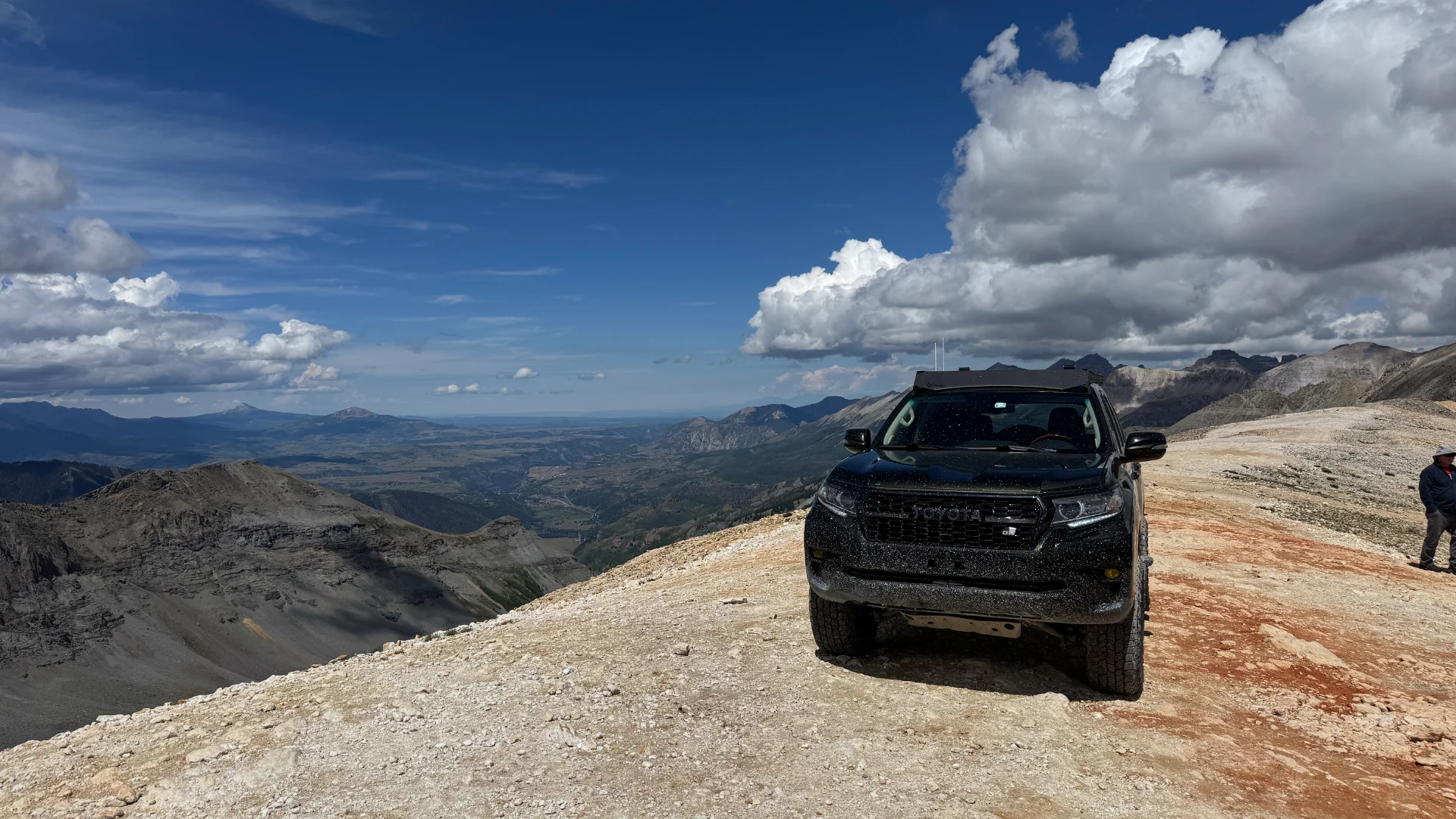

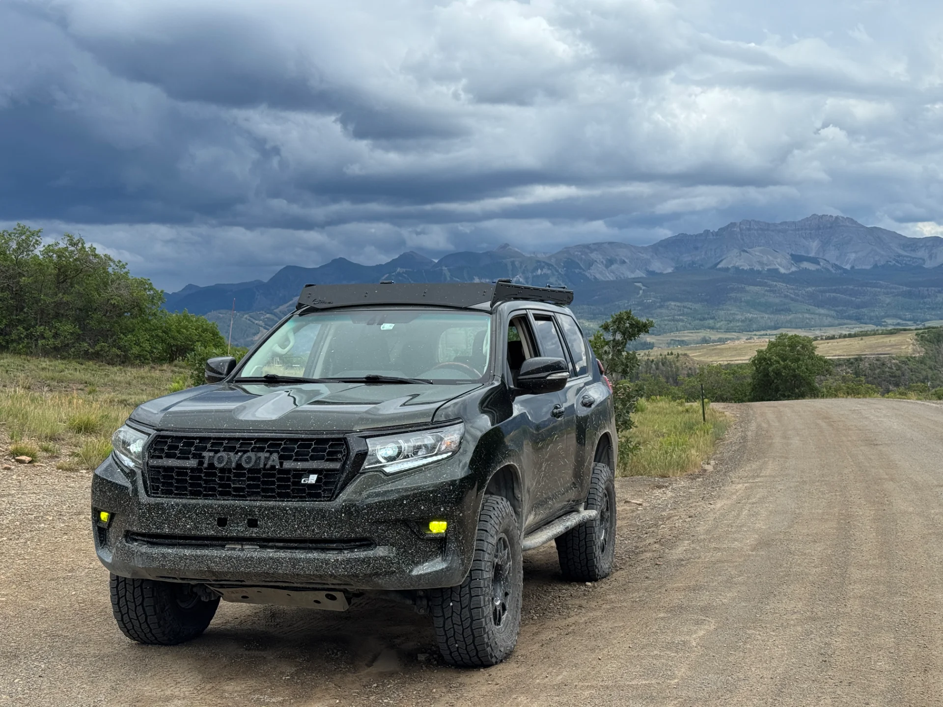

In other news, I took the truck out to SW Colorado at the end of July to meet up with family and it performed great.
