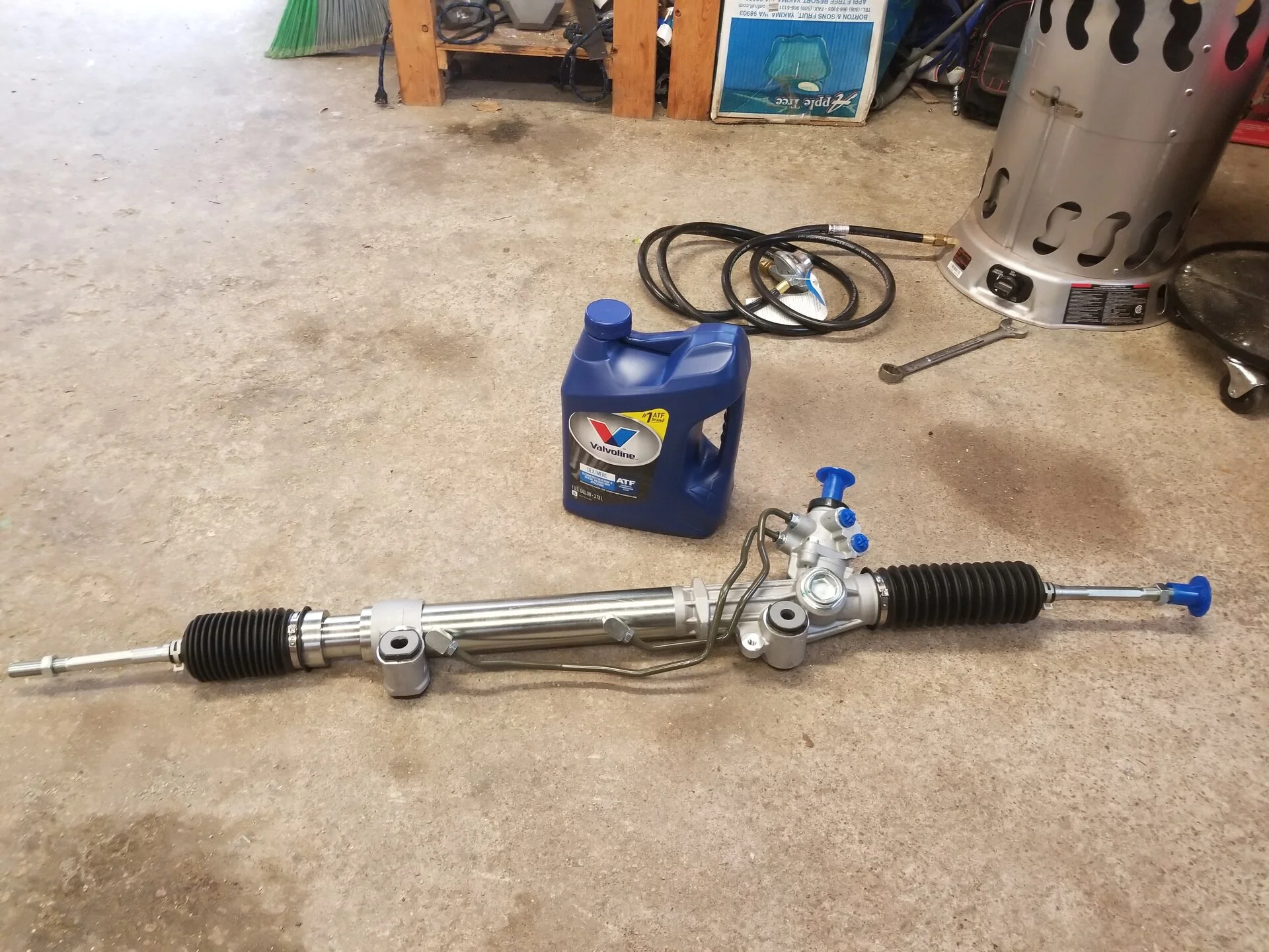

They are pretty solid on the 120/150 racks - see photo of mine below. It has an inner metal sleeve with rubber all of the way around it, filling the void between the rack bolt and the rack body. It looks like the 100 Series rack mounts totally different than a 120/150 rack (more similar to the 1st Gen Tundra/3rd gen 4Runner rack). The 200 series appears to use a similar system as the 120/150, although the 200 rack is much beefier.
With how the 120/150 racks mount, you'll have some very weird handling/steering behavior if the rack bushings go bad, as the front tires will be able to move on their own quite a bit.
