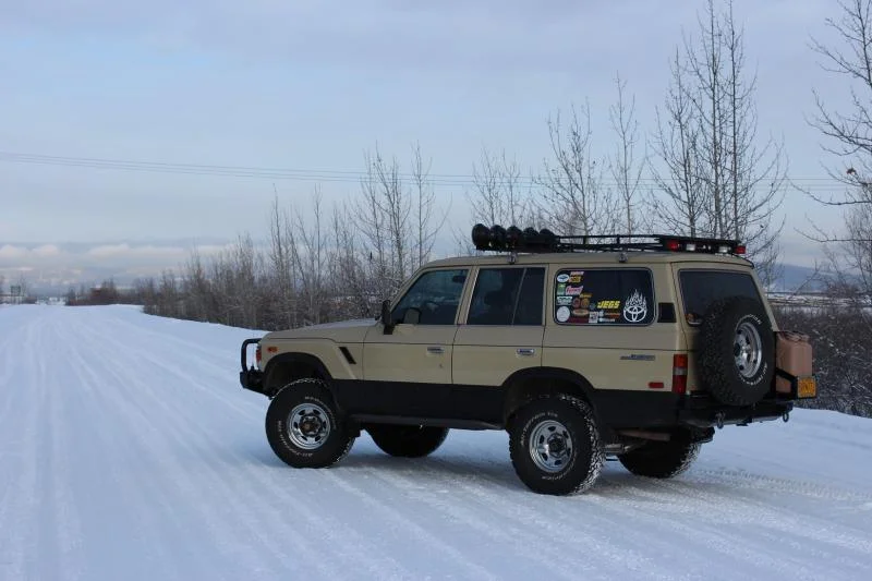

I finally finshed the rear bumper swingouts! I detailed the build in my rear bumper build, but here are some poser pics. I promise to get some real action shots when I finally get this thing out of the garage. :p
TK
I'm completely impressed!! Makes me want to get home that much faster and get mine all wrapped up. Someday I'm coming up there to go for a tour, you can expect a call!
Cruiserpilot, Thanks for the props! Anytime you are up here, drop me a line. We've had a number of Mud members stop by to chat and wrench on their rigs.
ddnuts, that's what separates Mud from many other forums. Most mud dudes will stop what they are doing to help another member in need. Good stuff.
TK
MAN, I LOVE TAN!
Do the cans on the back hold gas or water? Those look like plastic cans. Where did you get them? They almost match.
Nice rear bumper.
What size are your tires? 33x10.5? or 9.5?
I love tan too! ;)
The cans will hold and are rated for gas. I got them brand new at a military surplus store here in Fairbanks. They are plastic. I almost went with old school metal jerry cans, but couldn't find any that didn't have a ton of rust in them. They are a few shades off from the Cruiser tan, but still look okay back there.
Between the jerry cans, metal bumper, and rear flood lights, tailgating me would be stupid. ;)
The tires are BFG AT's @ 33x15x10.5"
TK
man, that bumper looks fantastic. once i can save up enough money, and learn how to weld, i totally need to do that. i've been keeping a lookout for your rig around town but haven't seen it yet...
