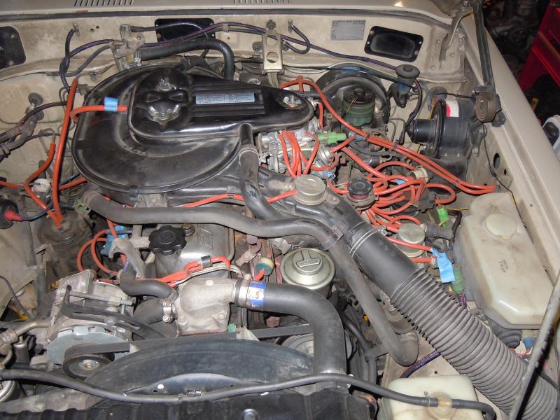

Finshed up the airbox mod for the snorkel this weekend!
Being as the intake for a stock US spec FJ-60 is on the driver's side and the snorkel intake is on the passenger side, I had to figure out something. I've seen a few guys running FJ-62 canisters, but I had an extra FJ-60 airbox, so I hacked off the OEM intake and welded the hole shut with scrap metal. I found a piece of 3" exhaust pipe and flatened it out on the airbox side a bit and welded it in. Doing it this way loses the intake heat riser, so we'll see how it does in the cold. If I don't like it, I can always figure something else out. We don't (currently) have smog police up here otherwise it obviously would not pass smog, but I can always bolt the original intake setup back on the rig.
Overall it turned out okay, but not perfect, so don't look too close. I used seam sealer on all the inside joints, and painted everything. These type of projects allways take longer than I figured. I probably have 10 hours into the bugger, but at least it kept me from Black Friday shopping!:bounce:
Alright, fill us in. How did you do that? That is high on the future mod list for me.
I probably should have taken pics during the process, but I got too caught up in just getting it done. Really it isn't too difficult as long as you have access to some basic metal working tools and a welder.
All I did was:
drill out the spot welds to the original air horn,
cut and fit some sheet metal to the hole the the air horn left,
shape one end of a 3x12" piece of exaust pipe so it will fit inside the airbox,
cut a hole in the airbox carefully matching the flatened end,
weld the pipe to the airbox,
seal and paint everything
and hook it all back up.
I haven't run it yet with the new airbox, so I'll post my review of it later.

Looks great! I like the airbox fab too.

Your Cruiser is coming along nicely, really liked how clean your snorkel install turned out, that is exactly how we seal up the 60 series airbox for the snorkel install. Great job! Thanks again for the AAL order. :cool:
The airbox looks nice.
I might copy that in the future.
Thanks, I saw the same mod somewhere on mud once, so let the copying carry on! ;)

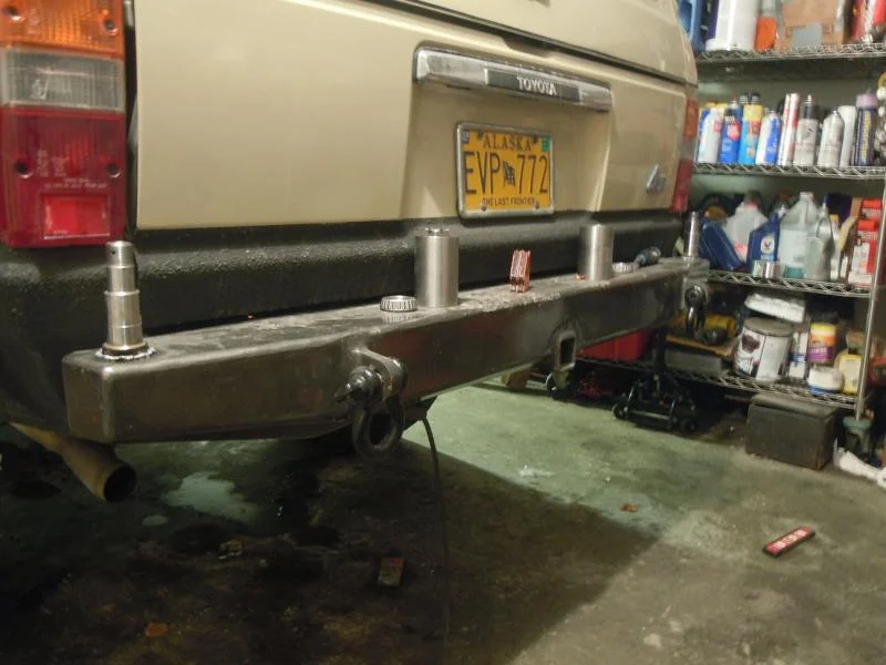

Thanks Kurt! i might be calling you in the near future to order up some add a leafs for the rear since I re-started on the swingouts.
...Thanks Kurt! i might be calling you in the near future to order up some add a leafs for the rear since I re-started on the swingouts.
For sure, let us know. We would love to get you taken care of. Thanks!
