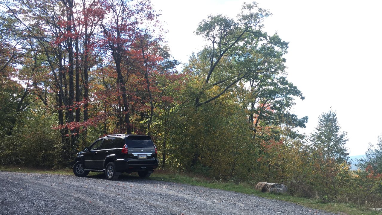

Yes, it was taken from one of the Vistas in Bald Eagle State Forest in Centre County.
Nice, I thought it looked familiar. Pre-kids, my wife and I used to camp out that way every year with her Penn State friends.
This is near Rothrock shortly after I bought my GX four years ago.
