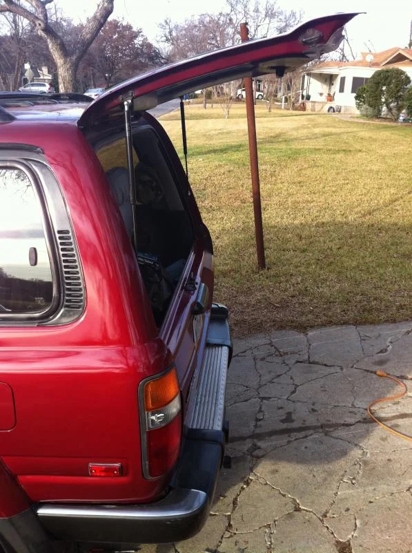

My fix for the ever-elusive hatch struts
I am in need of new supports front and rear. I am going to go with the McMaster option and am wondering if anyone came up with a part number for a McMaster hood support? My truck is in the body shop so I can't do any measuring and want to get these parts coming. I want to order everything from McMaster, so I don't need any sources thanks (Ebay, etc.). Thanks, Ken
Thanks for this. I've been looking for a replacement for my worn out gas struts for some time now. I just ordered #90 struts from McMaster, I can't wait till they arrive. I am tired of getting my head bashed by the hatch!

Got the #90 McMaster-Carr struts installed. What a difference they make!! If you need gas struts, this is the way to go.

I did McMaster fix last year and I love it. I'm 6'2" and I enjoy knowing that I can walk under my hatch and have zero issues. I like that it even opens up higher even.

installing mine now. Am I supposed to be cutting off any threads on the ball joint attachment on the McMaster shocks? Doesnt look my lower ball joint threads will clear the inside of the hatch with the mount. Top one looks fine.
EDIT: I went back and re-read the OP. thx for the tip!
