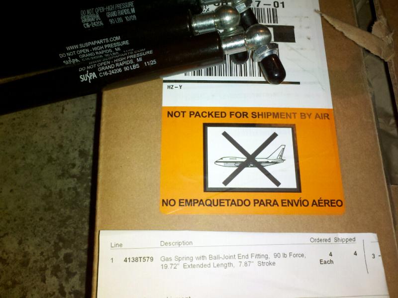

Here's my box. Getting ready to install them.

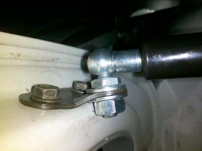

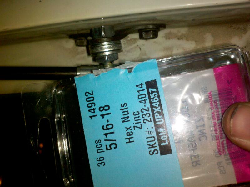

The top hatch mount fits perfectly. But I need to take off the lower mount and cut part of the threads off from the strut ball. I temporarily shimmed it out with a stack of washers, but it causes the hatch to rub slightly against the strut body. You'll need some 5/16-18 nuts and some flat washers to do the job. I used a ratchet strap to compress the strut as its impossible to compress these while also threading bolts and supporting the hatch.
I only installed one side because its late, but it easily supports the whole hatch with a tiny bit of help from the worn out oem unit. Probably could do it on its own. So add this to the list for those ''my 80 weighs 10K lbs, how can I lighten it up?" Threads. You could save the weight of both hood struts by adding a prop rod, and only installing one rear strut ;)

I'd stay away from the autozone junk. That's twice the price of the mcmaster Carr struts and they are probably lower pressure and made in china. The struts I got were made in the usa and I couldn't compress them more than an inch or so using my full body weight (190 lbs) even though they are rated at 90LBS.
Measure your hood struts and order similar size struts from mcmaster or do the hood prop mod since It will work on all 80's.
Thanks for the pic. I'm curious as to how to pack them for air travel. I could have my brother mail them to me or take them on the plane with him. I willing to take a chance knowing they might be confiscated, but I don't want him to get in trouble and I especially don't want them things to blow up mid-air or anything.

SHouldn't have a problem in the pressurized cabin of the plane. Just have him duct tape them to his leg and tell security they are a medical leg assist device.
Yeah, I was thinking "as long as it's pressurized" as well, but that's when TSA takes things like that because of the "potential" risk.

Just installed a pair; had to adjust the hatch hinge mounts a bit to avoid rubbing between hatch and body.
I just finished this mod. Thanks for sharing the idea! Aside from drilling out the posts on the hinges, all I had to do was cut about a quarter of an inch off the threads on the end of the strut that mounts to the body. I had to do this so the thread and nut would clear the inside of the hatch. Awesome!
