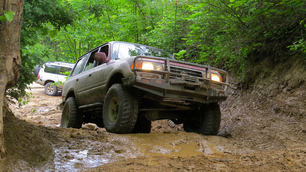

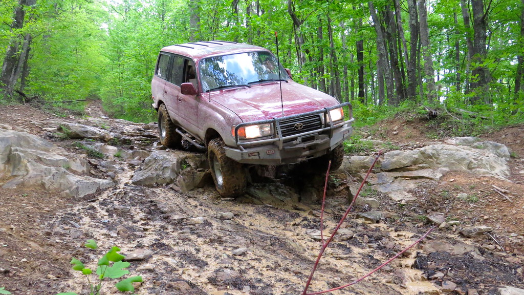

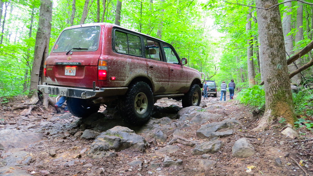

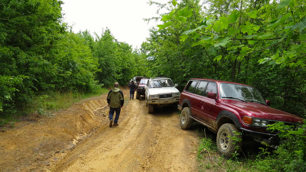

We showed up to GSMTR this year a little late (Friday morning), but were lucky enough to run trail 22 EXACTLY when every other 80 in the world decided to run it. So it was a great time to see all the different directions I could go in with this build.

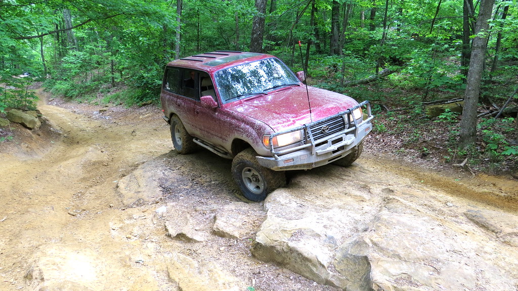

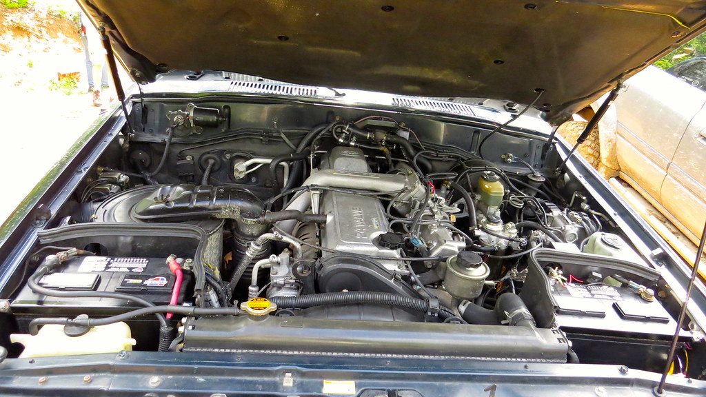

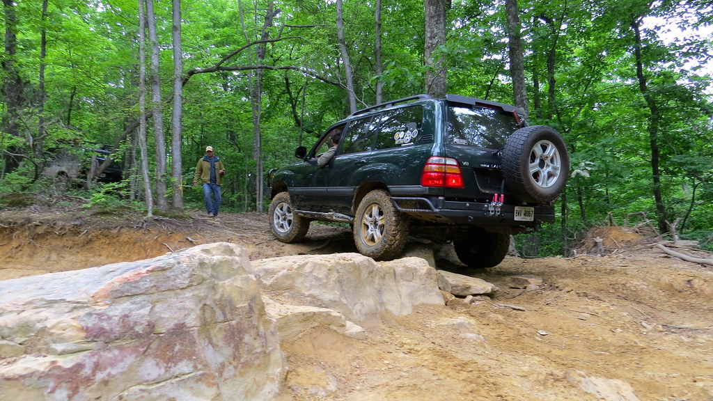

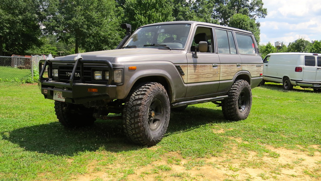

Toyota Diesel goodness...

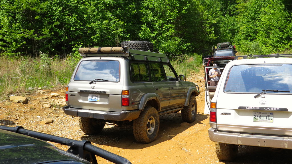

Awesome pop up camper..

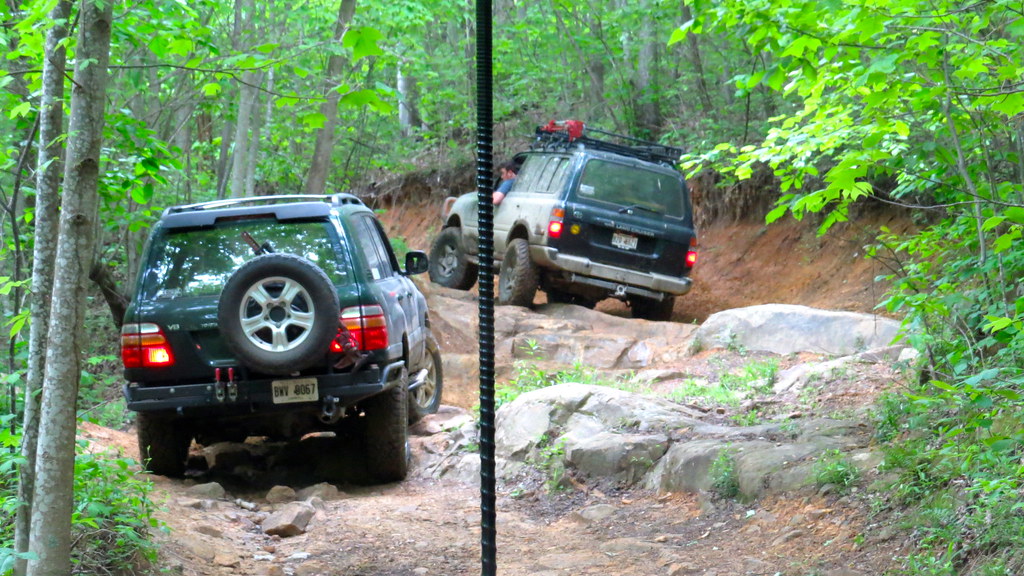

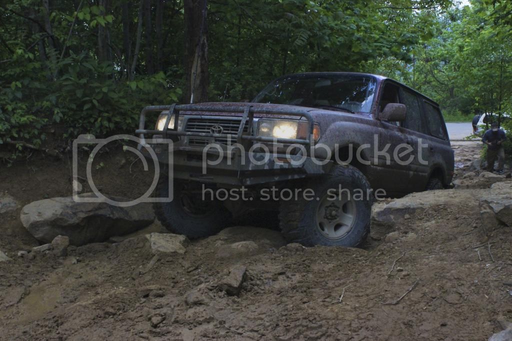

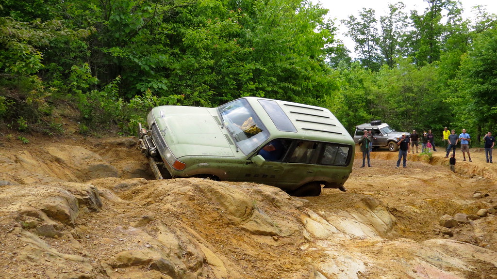

Theres some youtube videos floating around of this guy going up 22... It was so much better in person!

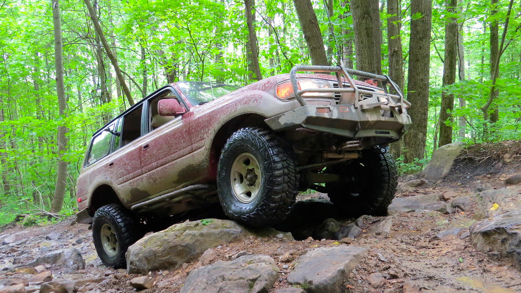

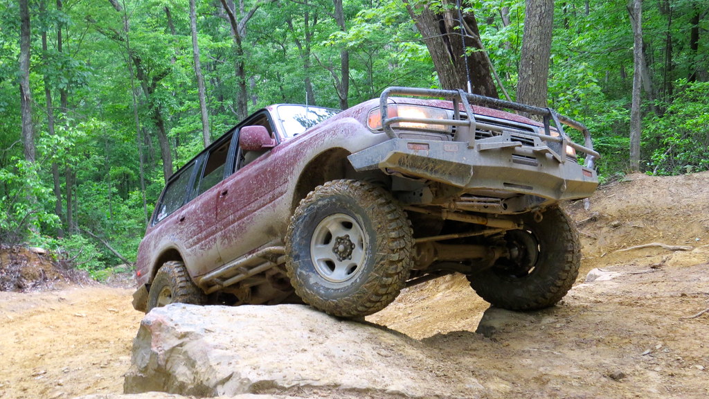

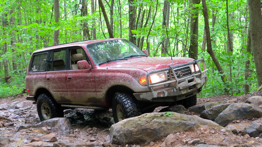

My brother drove most of GSMTR (including 22) since he paid the registration and wasn't able to bring his truck and I was feeling generous. So most of the photos here are ones I took. Im also learning to become a better spotter first so that I will be able to see good lines when I do begin to wheel the truck on a little more challenging terrain than I'm used to.

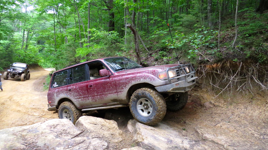

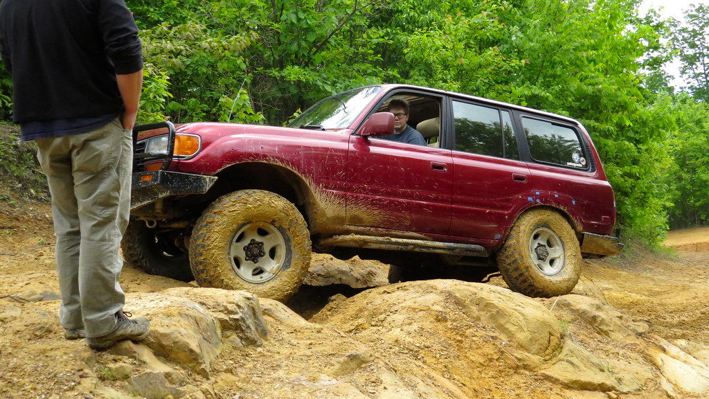

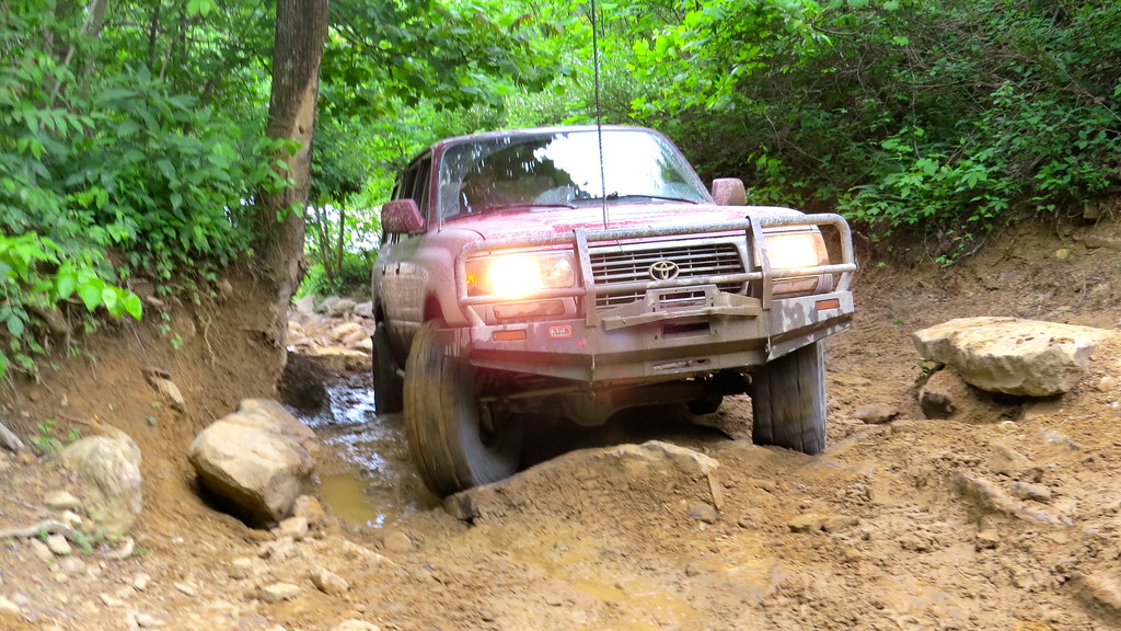

So this was one of Patrick's first trails with a vehicle that was locked front and rear... Those things can make anyone look like a pro haha:flipoff2:. He made it up with a lot less drama than the green beater 80, but was great to see what a mildly built 80 can do with such ease.

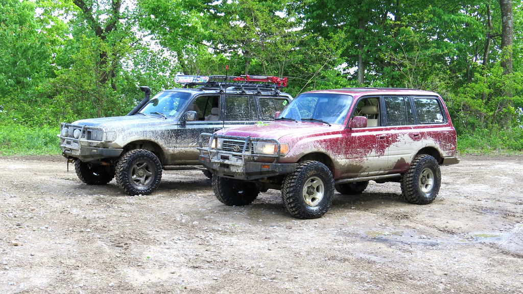

"Patrick Walking"... and also a shot of the trucks that made it up 22 ahead of me.

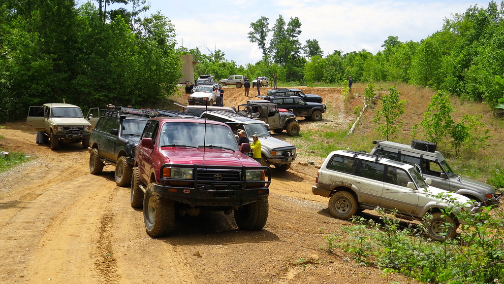

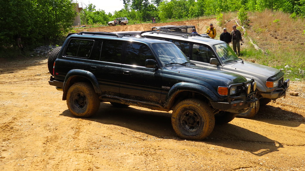

Another shot of the trucks in our group as we took lunch.
Usually, we dislike big convos of people out on the trail, but this time was cool. Being able to talk to everyone about their LCs was a really cool little experience.

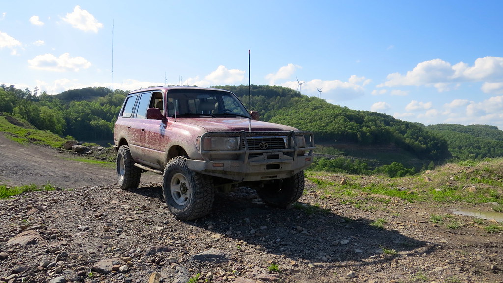

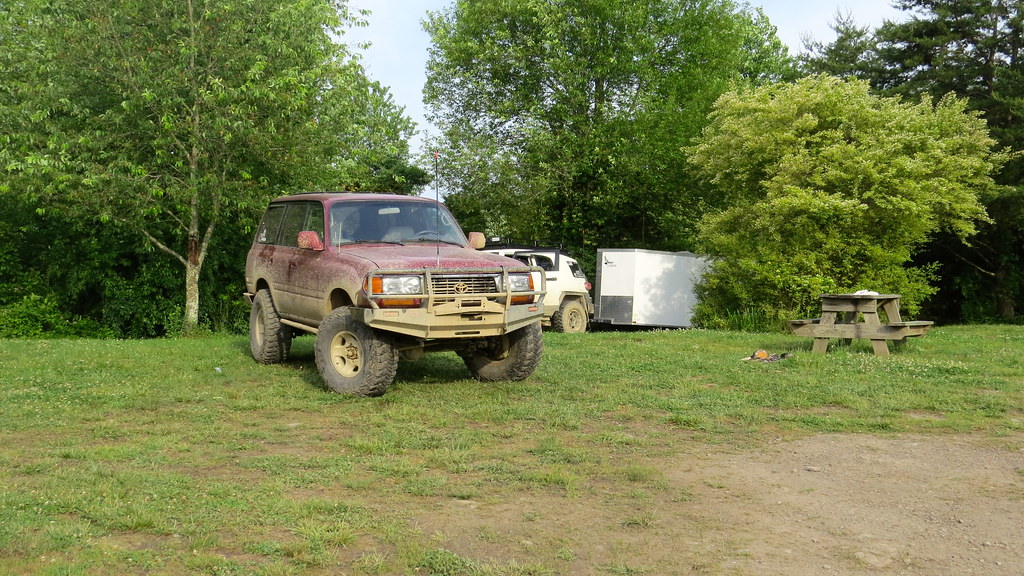

After finishing 22, a lot of us either split off from the big group or took a break to spend time at camp. Our friend, Asher (King Kong), my brother, and I went out and found Matthew (Jynx) and Sam Stewart and found some puddles and the wind turbines I heard Patrick talk about last year... they're really big...

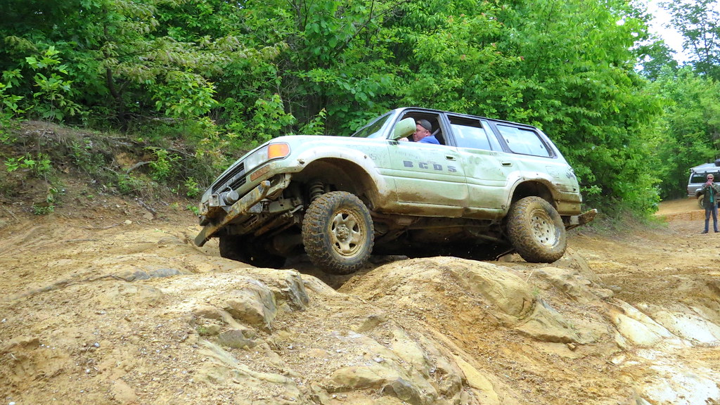

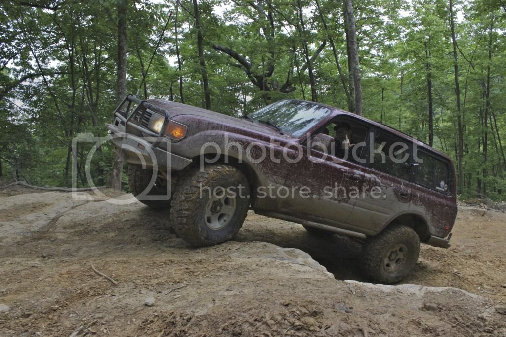

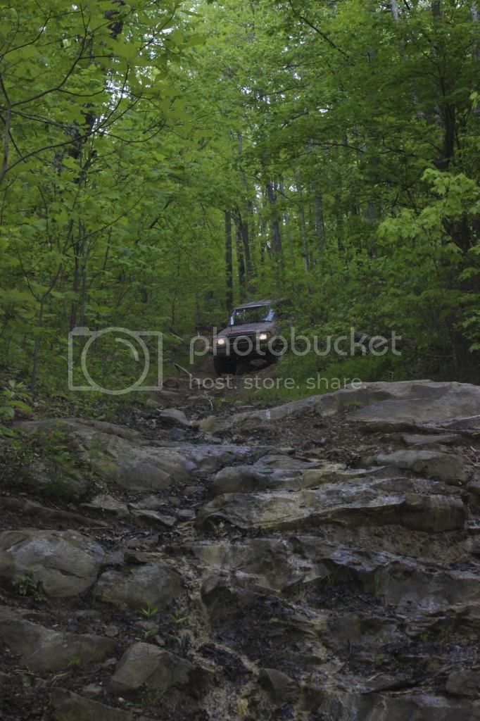

Trail 16

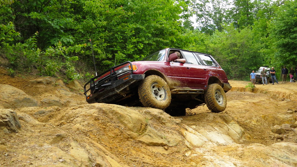

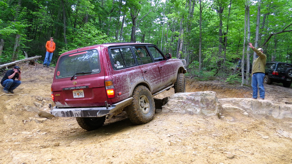

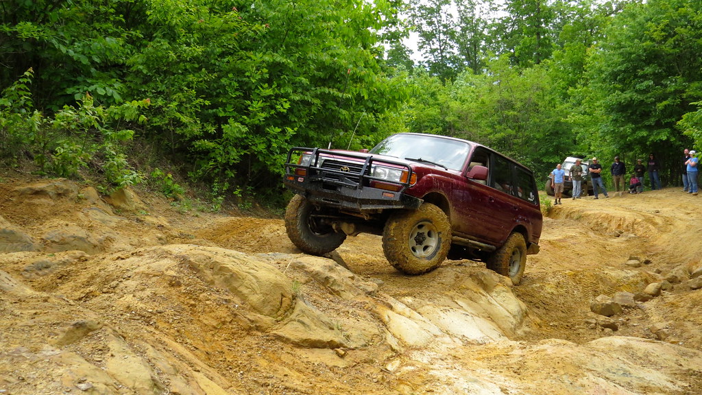

It has some nice ledges. Probably could've made it up this first one, but the spotter said my brother was hitting one of the control arms, I think he could have made it up, but better safe then sorry.

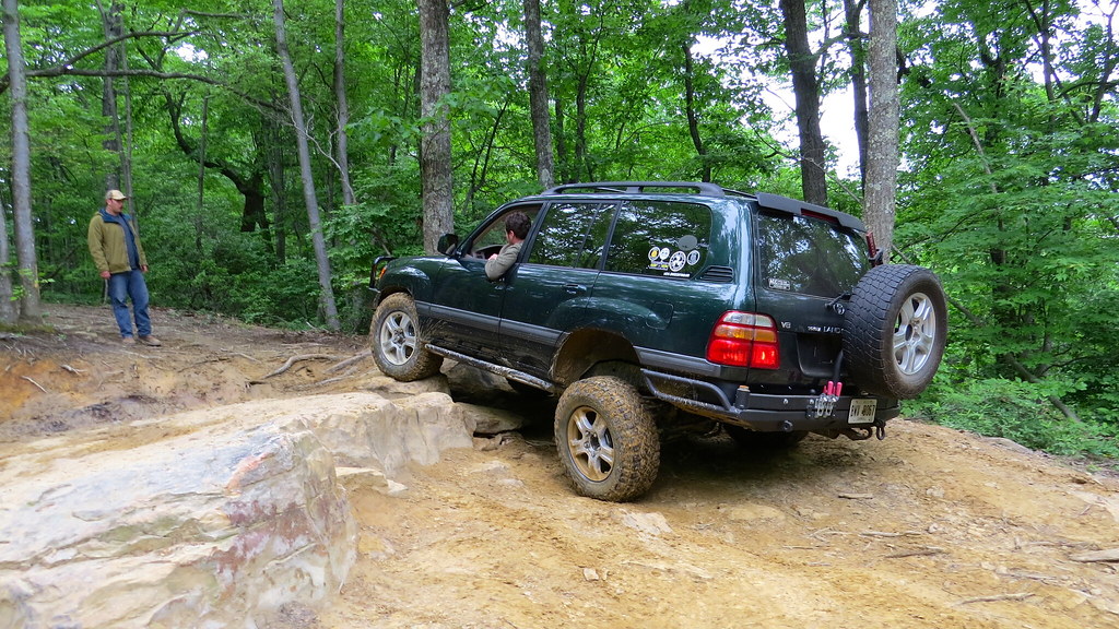

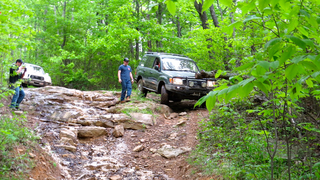

Charles (Griffin) heading up the last main ledge in his super nice 100.

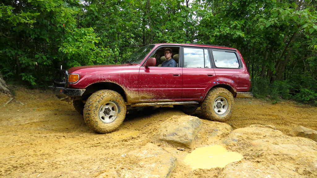

Patrick's turn
Easy as pie.

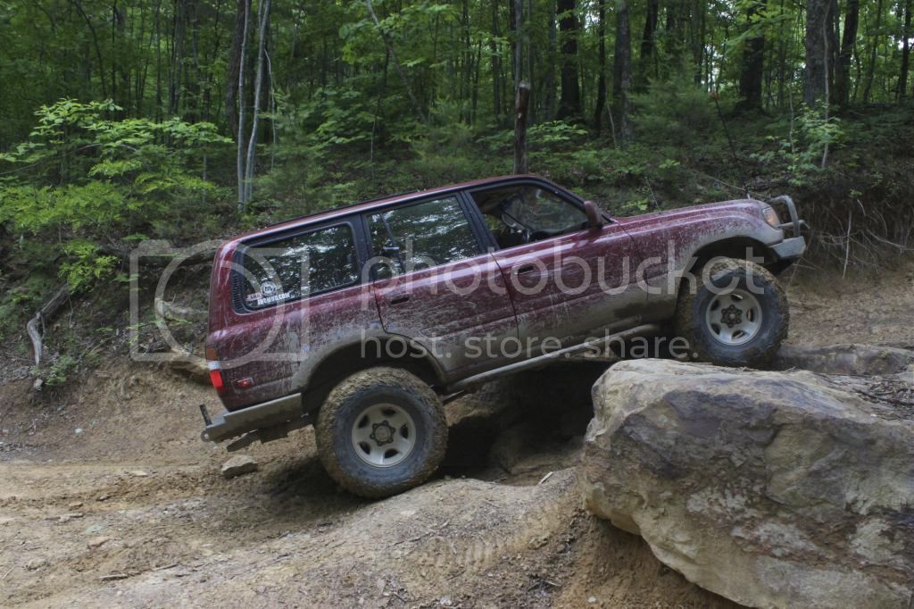

The last full trail we ran was 60. Our favorite of the day. Very steep declines and rocky ledges. My brother REALLY wanted to run it in reverse, but we just didn't have time.
"A" for Aidan!!!
I can't quite capture just how steep it was... but very steep.

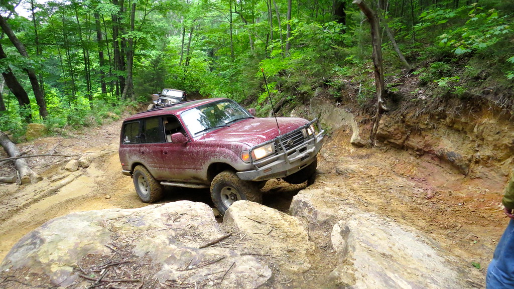

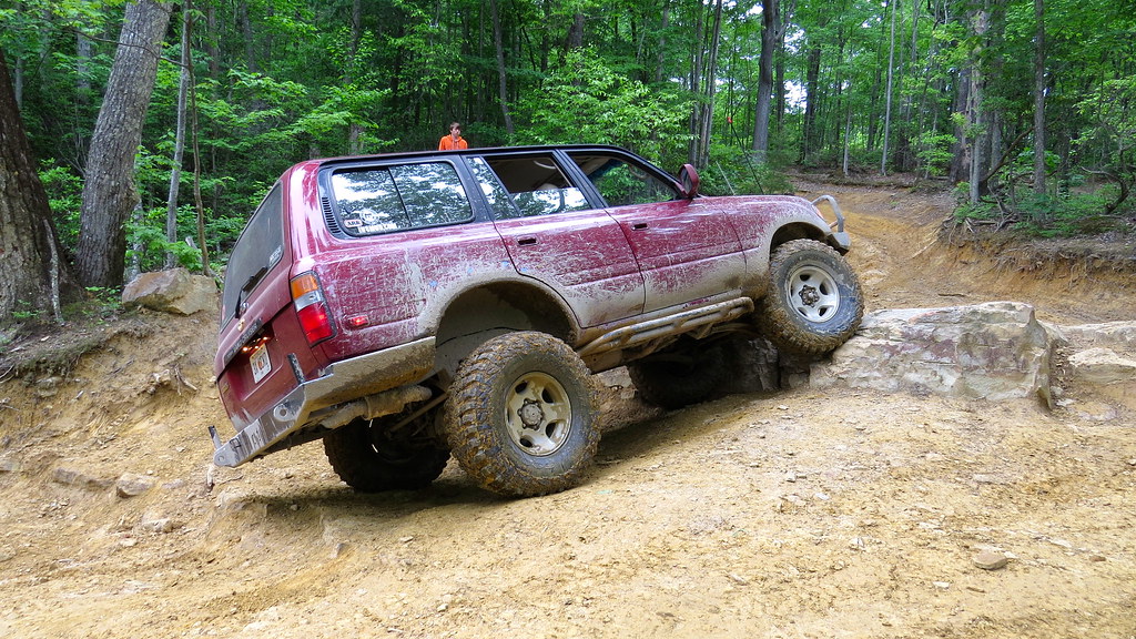

Patrick had been talking all day about a trail 15 and how cool it was... It was one of the more difficult trails at Windrock. Even truggies had been having trouble with it that day, we didn't belong there lol. But he gave it a shot anyway!
He made it pretty far. Farther than others thought he would haha. The only reason I made him stop was because when he bumped it to try and make it up that ledge right next to that passenger side tree, the roof got within inches of of it.. Trucks too new for body damage LOL!

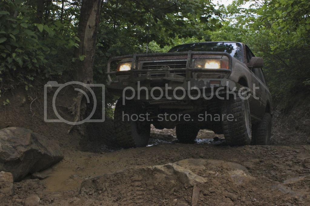

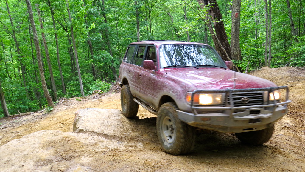

Oh yeah, here's Sam Stewart's video of me on 22...
I have many excuses for that pathetic first attempt... i was still learning front and rear lockers and thought they'd just magic me up... i didn't think that puny 8" diff could handle my awesomeness... I had like 30 people watching me so i started to get that nervous piss feeling pretty bad... Take your pick hahaha

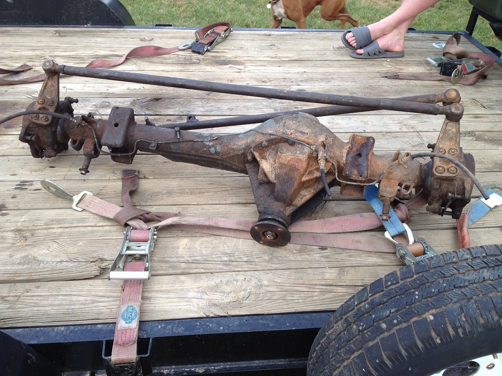

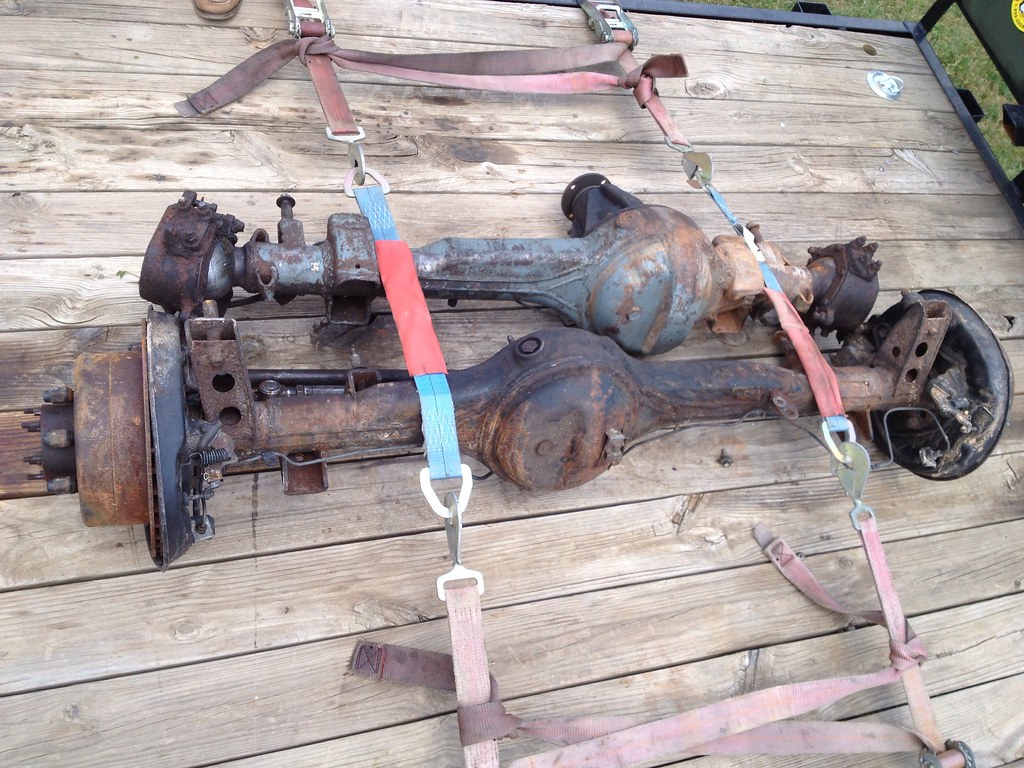

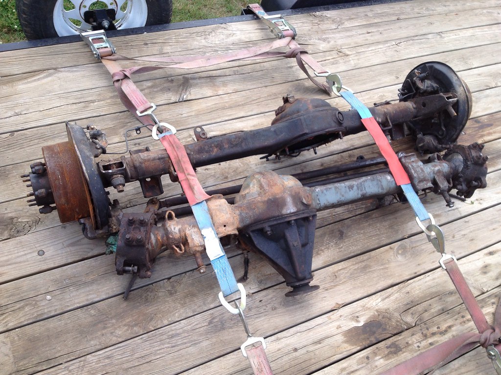

Its been a couple weeks but i got a chance to spend some time with my new set of axles! Thanks to @Fort Knox for loading them up and getting to Tennessee for me and also thank you to @tkinze for getting them back home to Georgia and sitting on them until i was ready. The Toyota community is a great one and I appreciate it immensely :cheers:
They both came out from under a certain 4bt powered 60 in North Carolina that is now sitting on 1 tons.
Huge thanks to Johnny (GLTHFJ60) who so generously gave me a price so low i thought he was joking!
The rear axle is a sprung over 80 series rear. Since i rebuilt my current 80 rear end not too long ago, ill just use this housing and swap the rebuilt stuff onto it. Ill chop a couple more brackets off it, clean it up, paint it, then bolt it on!
The front will probably not be used on Woody because the housing is a little bent, but that doesn't mean anything will go to waste. A fellow Ga Cruiser is building a 9.5" front housing for his 80 series crawler so the diff will probably be regeared and go towards that. The housing is still waiting for a purpose but i think it would go great under a 40 or mini truck.

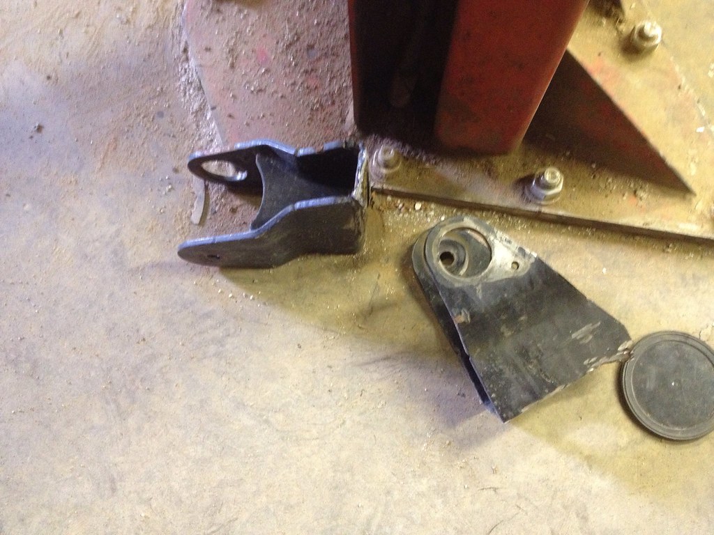

OK... so last week, my brother, Aidan, and I started cutting the brackets and perches off the axles getting them ready for beautification and the cut and turn!
I let Aidan do most of that work while i "supervised"... lol

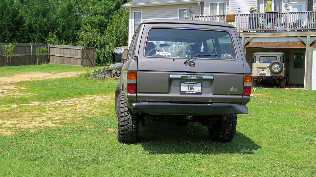

And then over the weekend, i got some work done with the Ga Cruisers. We all usually head over to the shop every Saturday to get stuff done on anyones truck that needs fixing or more mods. Well, we chopped off the shackle reversal, welded on the new shackle perches, and lowered the rear. Woody was riding low on 35s... too low for 35s haha.
The front shackle angle isn't very good now, but I'm pretty sure that once i remove a couple leaves from the front pack, it will become much more manageable. Or well chop the hanger off and move a little farther back.
The rear angle was almost vertical when woody shrunk, even after we pulled 2 leaves from the rear pack yesterday, we'll still end up moving the shackle hanger inward a little. Im all about that perfect shackle angle now lol, Ive spent waaaay too long with this pogo stick ride...
Yesterday was the first day we real got started on our own without the guidance of other club members. All went well, but we didn't really do anything that would've been problematic. We got a little bit of a late start, so broke down rear axle, messed with the rear leaf spring packs, then stuck the SOA'd housing underneath.
The springs are still a little more arched than i would like, even with the full weight of the vehicle on them, so i may do a little more trial and error tomorrow to get them flatter so the truck sits lower.
