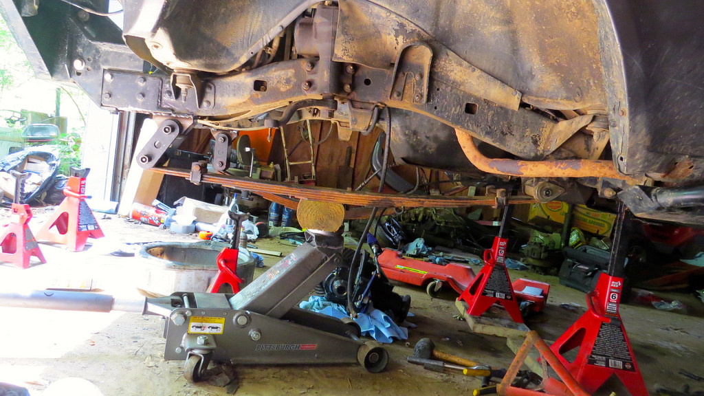

PS, that front shackle angle looked okay to me? Once you start working that suspension it is going to settle down more than what it is now.
Yeah when all the axle work has already been done for you, it makes things way easy haha. The front should be a little more fun though when i get started on it in the next few days.

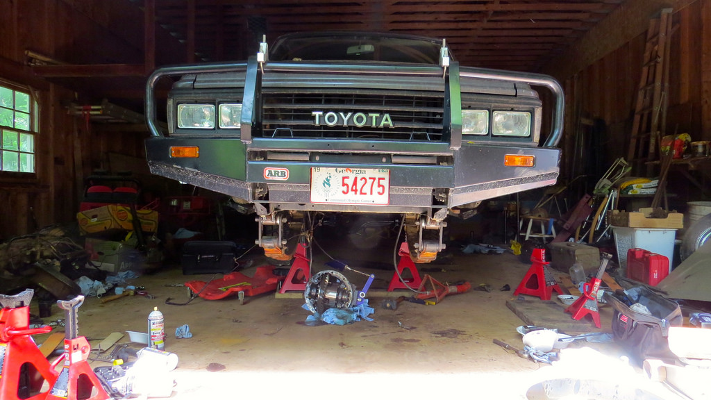

Yesterday, I got the front end all broken down. Didn't take any pics because I've done it like 40x and my hands were covered in grease. Next up will be mocking up the front axle and getting the pinion angle and castor angles measured so that i can take the axle in to get all welded up!

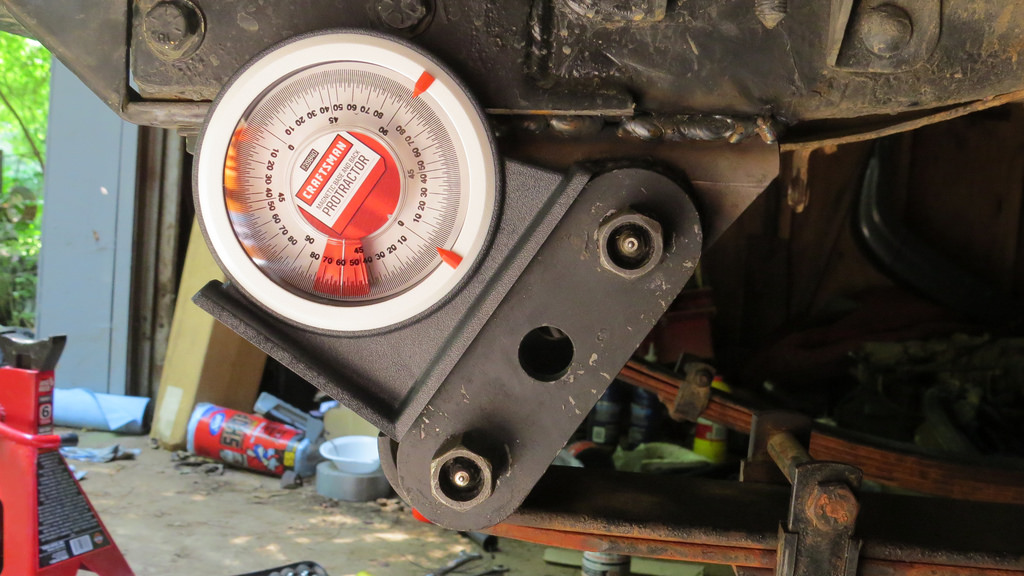

Didn't get much work done today. Just removed the current axle, ground the Ruffstuff perches down so they would fit on the new axle, and removed 2 of the leaves from each from spring pack...
My preliminary findings for the front shackle angle show that it should be around 60*, which I'm pretty happy with. We will know for sure when i get back over there and get the actual weight on the axle, instead of a floor jack...
