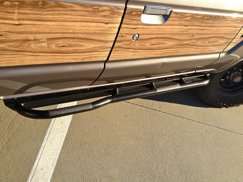

Not too long. Start to to finish, took me 4 hrs. But that's only because I ate dinner and pwned some n00bs on the old xbox in between sliders.
So probably an 1.5 hours.

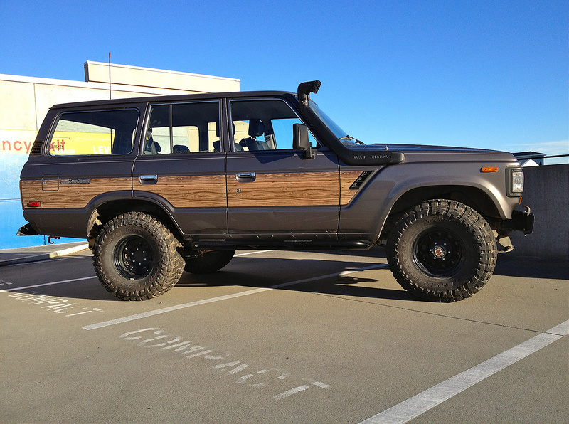

yaaaay pictures. Everyone, time to tell me how good they look.
Ay gurrrrrlllll dat s*** be lookin fyyyyyyynnnnnneeeeee!!! Lol black is definitely the accent color for this rig. Also your truck is too clean, it's time we change that ;). But lol we will definitely go easier, I feel like I'm probably killing my transmission the way I wheel :doh:.

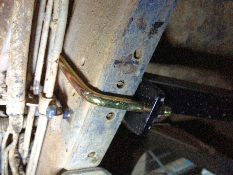

Nice install Patrick, do you have any pics of the underside/ mounting? U bolts seem like a much easier install as opposed to welding. I just wonder if they will move at all, especially the way you crazy fxxxs wheel... :D
I guess slight movement would be better than breaking a weld... Well considering one of my welds...
Also, your rig looks absolutely perfect with 33's. If you went to 35's you might have to play with your bump stop length to avoid rubbing. It can be done though! Or just get the Shackle reversal...
Danny, I'll post some pics of the mounting bolts when I get home in a couple hours. Im going fishing :D
And I'm gonna head to ACC next week to get the sliders/exhaust welded up because they are pretty much only hand tight, I mean, I'm really strong but it's only probably at around 150lbs hehehe. And that exhaust banging on the slider arm is driving me crazy.

Pics for DANNY...
(please pardon muddiness)
Driverside, rearmost arms...
You can see the hole in the bracket needed to allow the unbolt to pass through.

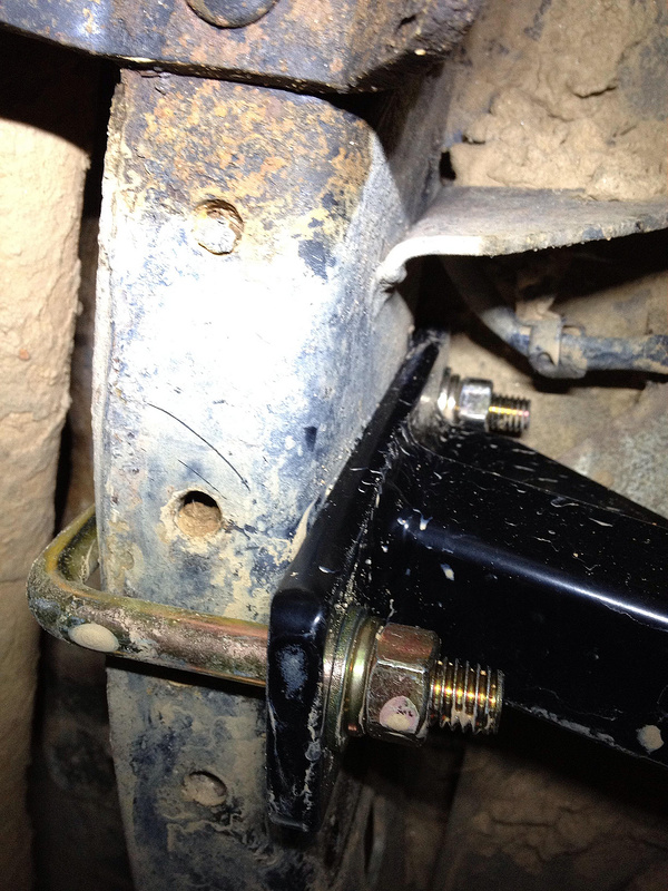

Driverside front arm...
barely enough room to fit even an end wrench.

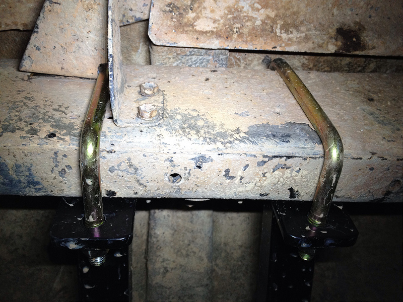

Passenger side, front arm...
Notice the spacers used to allow the unbolt to fit right up next to the frame. Wasn't hard to take off the 12 old bolts, but refitting the new ones and spacers in really tight spaces was a little annoying.

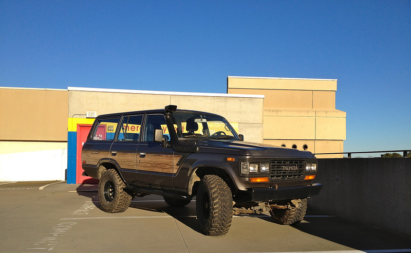

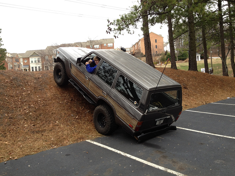

Hell yeah, found the perfect parking spot.
Left a big scar in the pavement with tow hitch... Oops.
Crazy smile :D
