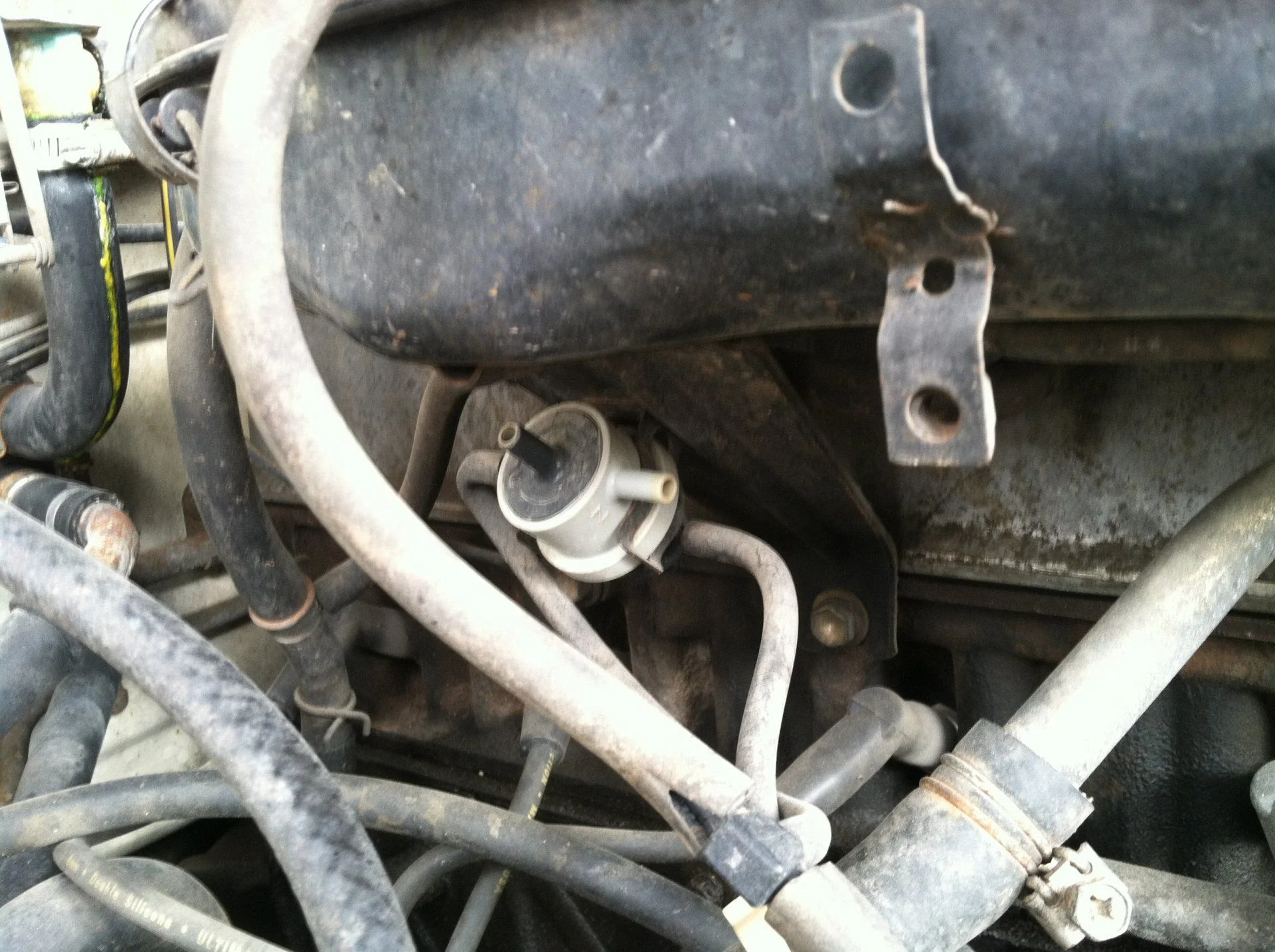

I have these 2 little hoses coming on the passenger side of the air cleaner that run down to the distributor which are cracked and even came off after bouncing the truck around on rocks etc. I guess it's time to do the hose replacements!

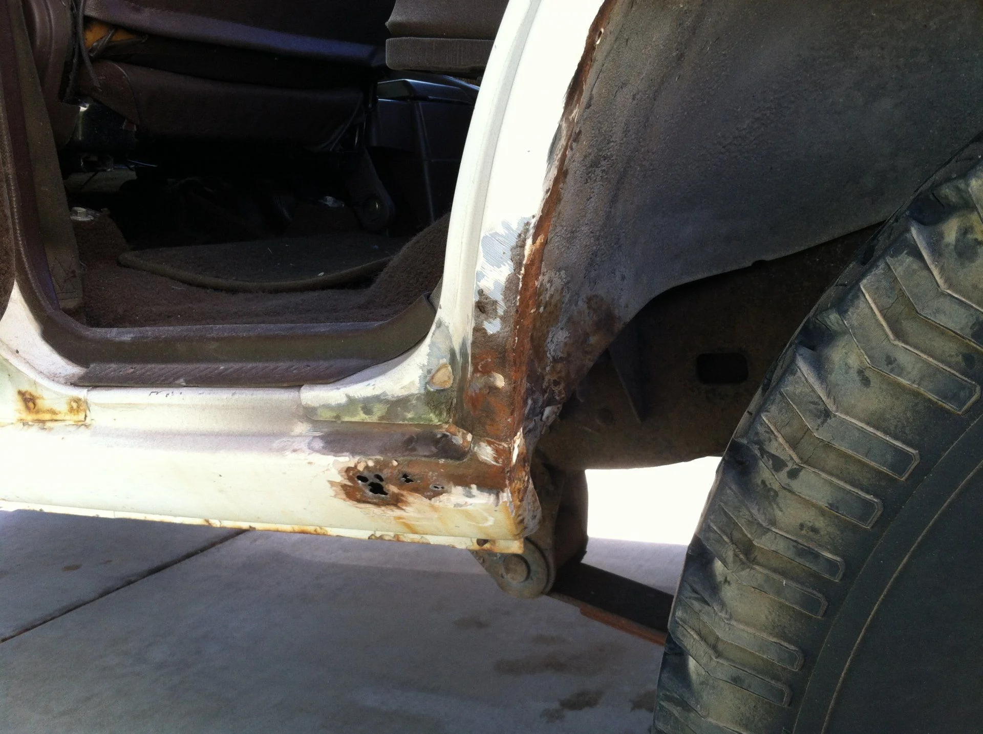

Looks like the front driver side fender, rear driver side door and the body below it were all dented at one point and then bondo'd heavily. I've got my work cut out for me. Luckily the passenger side is mostly solid.
Here's the hose that pops off - gonna tape the bugger on and find some replacement hose line ASAP!
Time to replace your vacuum lines. Check out this thread for great info on size and quantities. I bought mine from Boostcontroller.com and they worked out well.

I ordered the 3mm and 5mm lines from BoostController - they're really nice! I ordered red and replaced the cracked lines - I'll slowly replace all of them as time permits.
