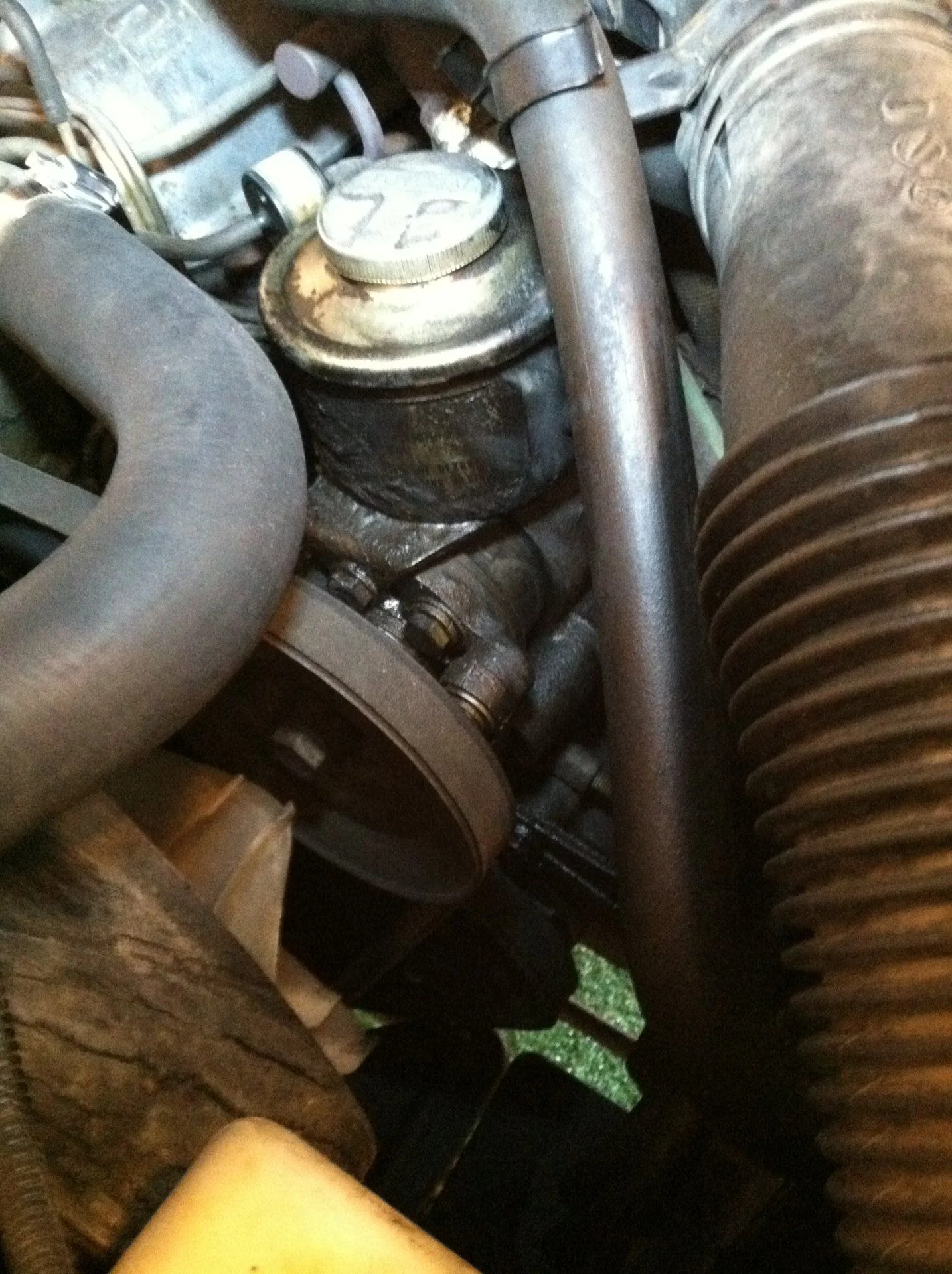

Power steering pump. Occasionally, when trying to make a sharp turn into a parking spot or something the power steering gives out! Always at those crucial moments!
It does look like it has a leak - a slow one at least. I refilled it and it happens less frequently, but still happens...
Careful of the PS Pump if it is leaking as that stuff will eat lots of things, including your smog pump. Get that looked at and/or taken care of quickly so you do not lose your smog pump (referred to as the vane pump in the manual). Neither are available new, or if they are they are SUPER expensive. May be time to look at the local salvage yards for a spare PS pump just in case. Oh and they don't come off easily, either remove the pulley first (If you can) or you have to remove the entire bracket.

If the pump truly is leaking then you have two options really; get a new one or do the mod to switch to a Saginaw pump (use search).

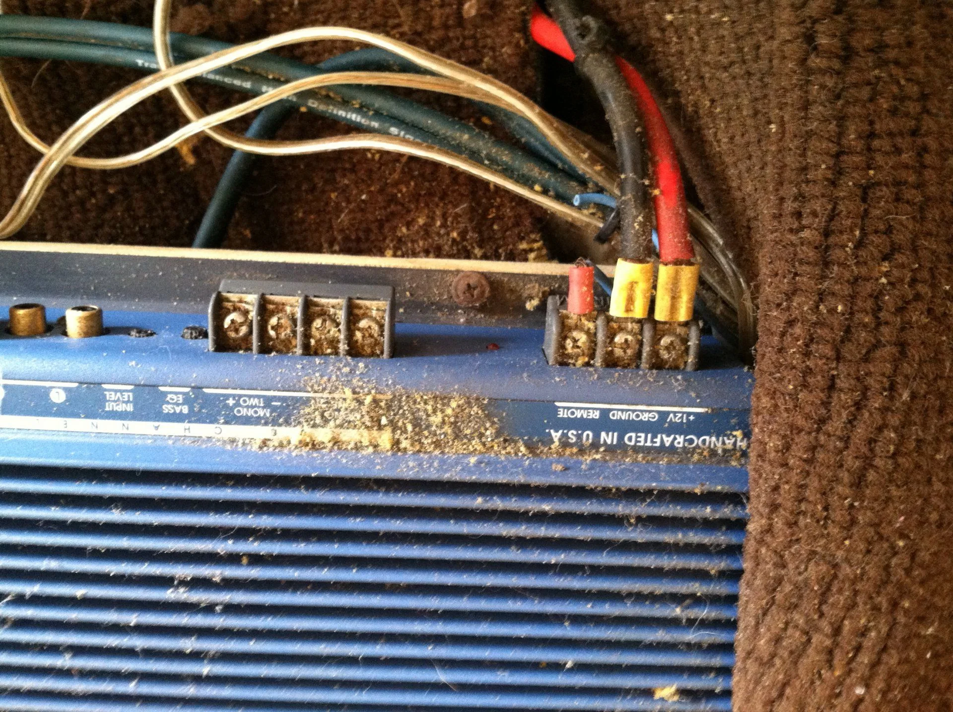

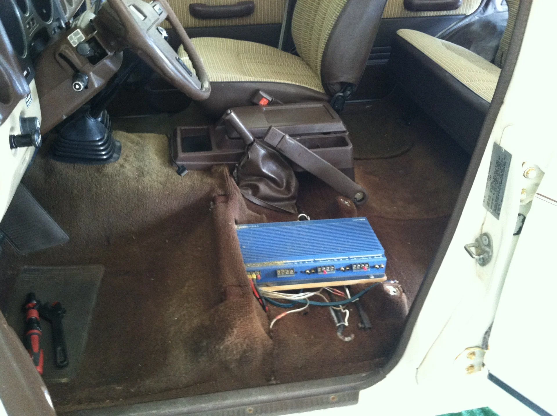

Pulled the driver's seat out to take a look at this amp.
Looks like the cushion was disintegrating onto the amp.

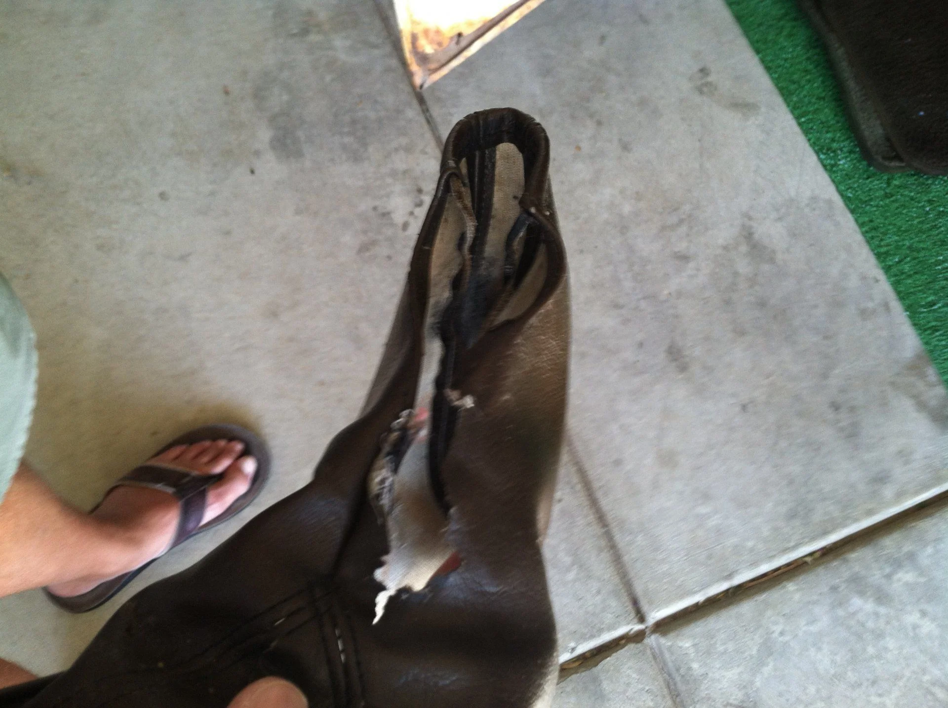

The e-brake cover is all ripped so I'll try to see if I can get that stitched up.

Anyone know what the two big bars are under the seat??? (one has a hook on the end and they're clamped in)
Jacking tools. Should be a bottle jack and tool bag under there as well.

Some updates. I removed all the seat and gave the interior a good cleaning. Scrubbed all gunk off and it's looking good inside. I still need to give a stitch job to the emergency brake cover. I also disconnected the stereo amp since it wasn't running to anything but I capped the wires etc in case I decide to get a bass tube one day...

Powersteering pump leak. It seems bad but the fluid level hasn't changed:
Looks like the whole inside the engine area on the same side is covered in dark fluid - could this be from the pump too? Looks like it.
Repairing/replacing this is out of my league at this point so I'll be taking it to a local guy who's been recommended for working on FJ60s to see what he says.

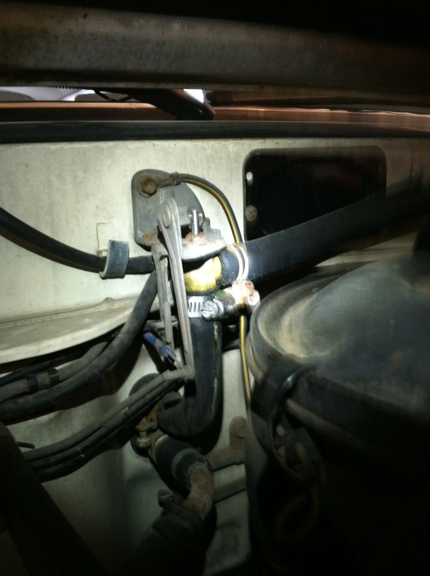

I see that one of the vacuum lines (the one coming off of the air filter on the passenger side) is split where it attaches to the air cleaner.

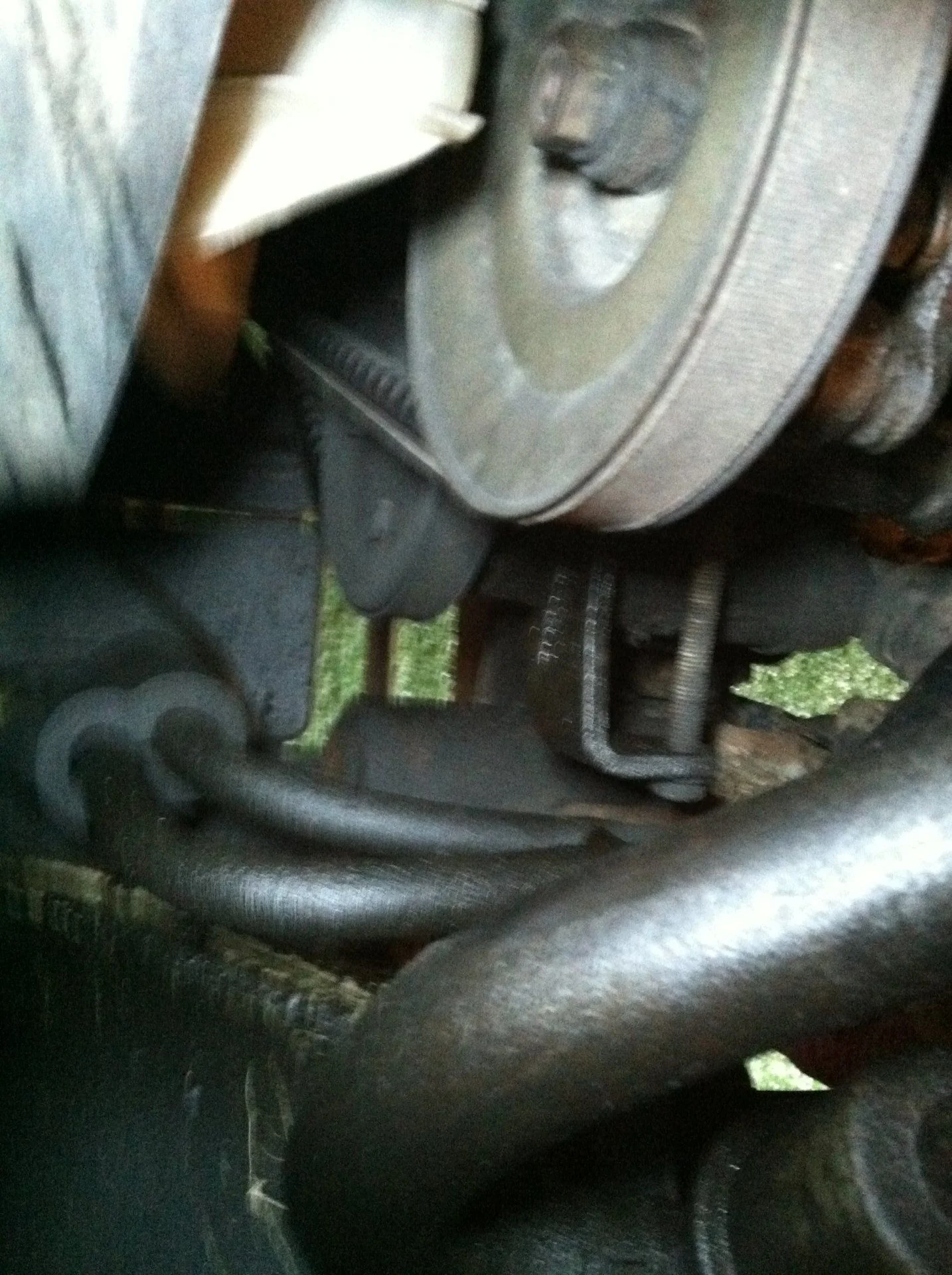

I see what I THINK is a lower radiator hose with a major kink in it.

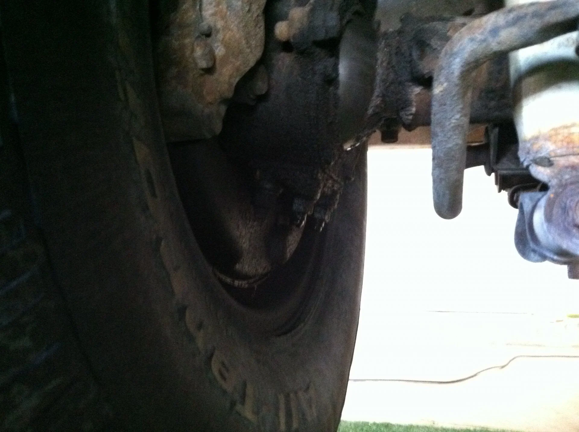

Leaking on the driver's side front wheel. I may try to tackle this one. Power steering etc is first.

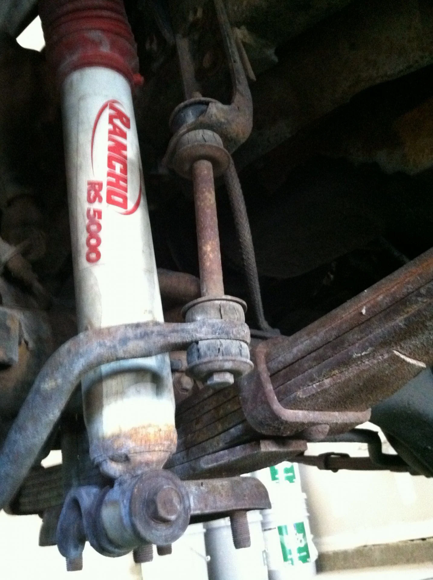

Rusty bottom of the shock and the bushings on the (steering stabilizer?) are pretty shot.

I washed all the carpets, pulled the e-brake cover off, sewed up the tears (and vinyl patched) on the e-brake cover and replaced it.
