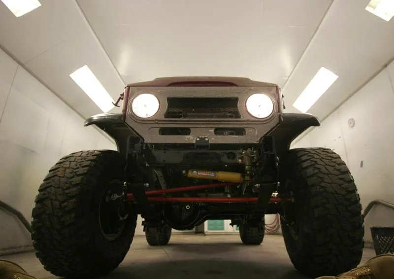

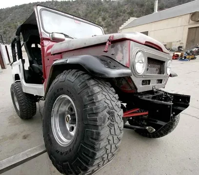

I figured it would be nice to post up some before during and after paint photos.
Here are the before shots...and the during will be posted up by thursday.

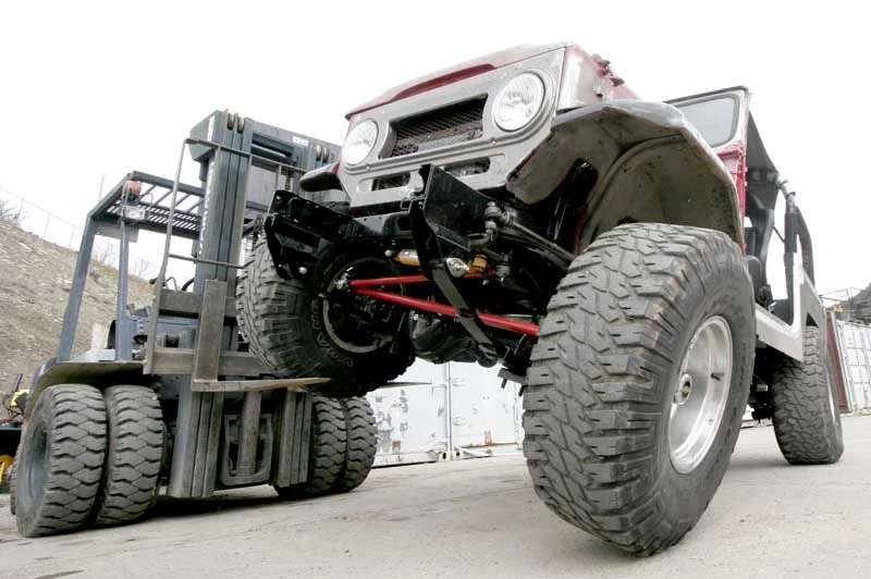

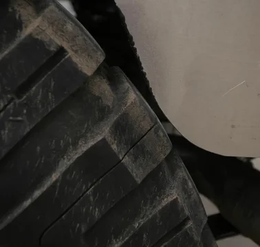

Flexed....(still had plenty of room to go in the front...but the rear would have tucked...After taking measurments I believe I will need 8in bump stops to prevent it from bending the rear quarter panel...check out the photo that shows how close I came!
