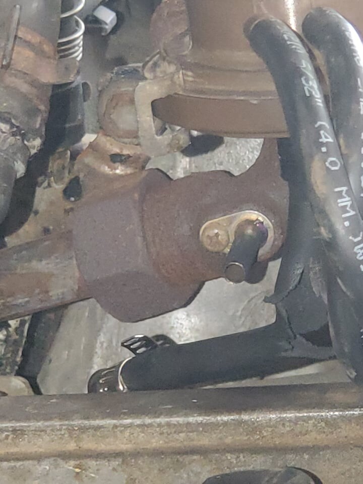

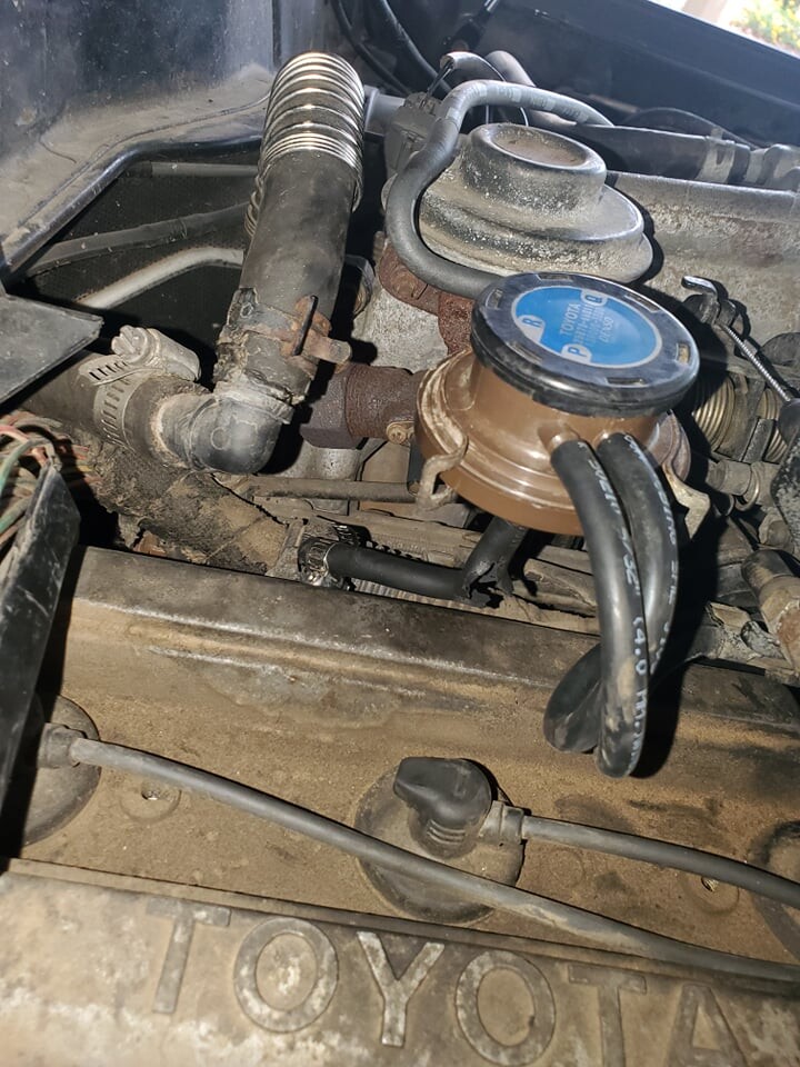

Replaced the exhaust gaskets between the manifold and downpipe. Please bear with me as I am no mechanic, so I will do my best to explain the situation. Now I am dealing with a blown out lower EGR vacuum modulator hose. Over the past few days, I have had no power at all, it struggled to do over 30mph on hills and acceleration from a red light or stop signs. The hose keeps popping off, with hard acceleration and under heavy load. So I attached the hose again with hose clamps and zip ties. Went on a small hill, gas pedal on floor and going about 15mph. Opened hood and the hose had blown off, with a hole in it this time. The rest of the truck is running and driving fine, though.
It is Toyota part # 25695-66010
I have done some research, and came to the conclusion that the cat's could be bad?
The culprit ended up being clogged cats. I took it to exhaust works on Broadway here in Tucson (thanks to another topic on here mentioning them) and they did an excellent job. I went with just a single cat. I also picked up a brand new egr modulator lower hose from Toyota dealership. It's running great now!
