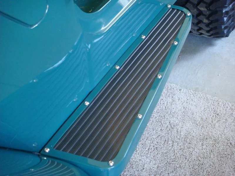

What was on the steps?
I have the same top on my 64 and I believe the 4 holes in the rail gutter are weep holes to allow the rain to drain.
My running boards came with the same white vinyl. I have put a alternative on mine. Still the same idea just not quite "original". I thought it through and white doesn't wear as well as black.
