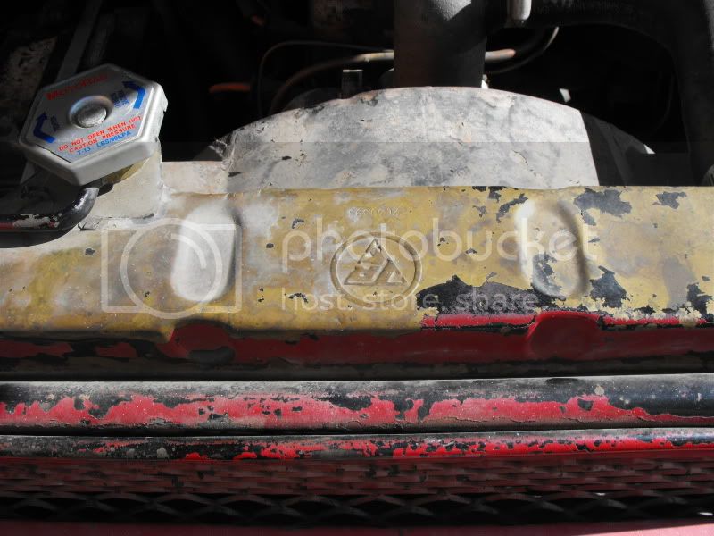

I think I may clean the paint off the radiator and use some brass polish on it. Too cool.
Big fan of the sight glass too. :D

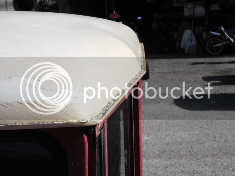

another roof shot
There's foour small holes and evidence of a rack; factory or add on?
