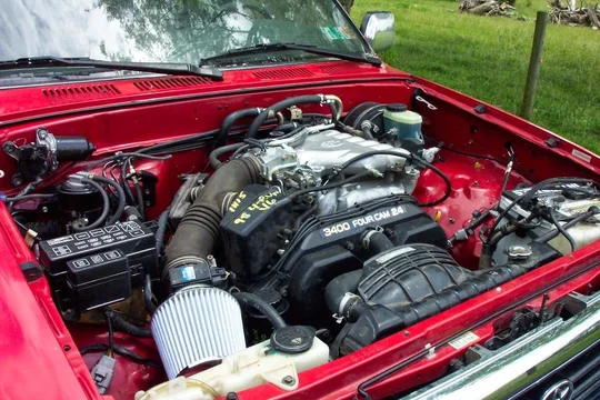

What would you do at this point?
Scrap it?
1.9tdi?
I'I need a 4cyl trans, a motor, and a bunch of adapter stuffs.
3.4 swap?
3.0 short block?
I would scrap it.
I have done (2) 3.4 swaps and would not mess with it again unless the truck itself was a "keeper".
Just getting the 3.0 out of the engine bay is not worth the hassle!!
