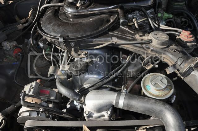

Well after hours and hours of reading....Finished up my desmog.
Big thanks to Jim C. for all this hard work on my carb./dizzy.
How do i look?
She runs good....I do have a weird vibration at idle sometimes.....Timing off causing that? Hit the gas and it goes away.....

So, here's the color coordinated version of my desmog. The lines can be traced although I couldn't get pictures of the back of the carb. Bronson is running much smoother now and I got rid of the overheating issues by making a block off plate for the tube coming off the manifold that went to the egr cooler. Plus adding coolant and water helped.

Nic,
you're welcome.
Timing would have to be way off to cause a vibration at idle. It's prolly the normal fuel distribution misfire. It's the nature of a single carb on a long engine.
Are you grounding the idle circuit, or are you keeping the decel fuel cut system?
If the decel fuel cut is to be removed, then permanently ground the ground wire for the carb. Dunno colors, I always check w/ the VOM to be sure. Turn the key on, probe the vehicle connector to the carb. one wire will show +12V, the other will show zero. The ground (zero V) wire from the carb needs to be grounded. Snip the wire, install a ring terminal and screw it to body.
Start with the timing at 7* (at the BB). Drive it and listen for spark knock, especially in the critical 1800-2200RPm range. If it runs well, advance several degrees, test drive again. If knock is heard, or tork decreases, set timing back. If no knock is heard, then advance again. Keep advancing until knock is heard or tork decreases, then back off several degrees.
