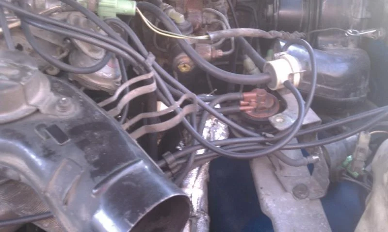

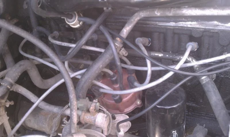

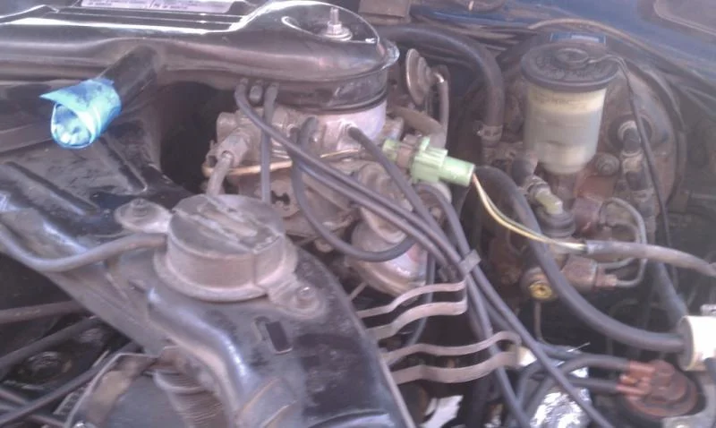

Well it appears I have jumped the gun. I am having problems getting the truck running. I had them last night but thought it was due to getting fuel back to the system but this morning it took a good five minutes of cranking and pumping (Not sure this helped as there was fuel in the sight glass) to get running. Once it started it stayed running no problem anyone got any ideas?:confused:
After I got it running this morning I drove the 5 miles to work and let it sit for a couple of hours and had to run somewhere and I jumped in and it started up no problem.
I have searched but I am not finding much that fits with what I have.

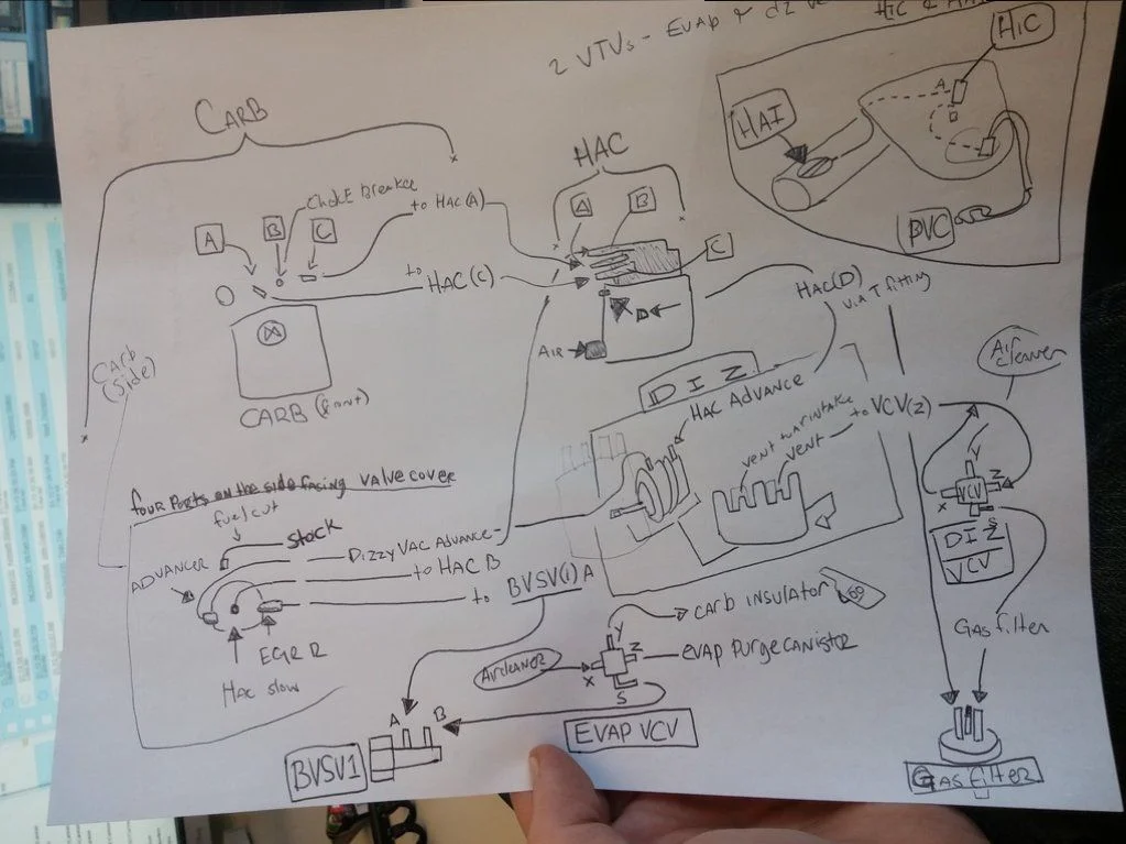

Here are some picture of my desmog. I know I need to get the tape replaced and I will. Anyone give me a pointer to fix my starting trouble?

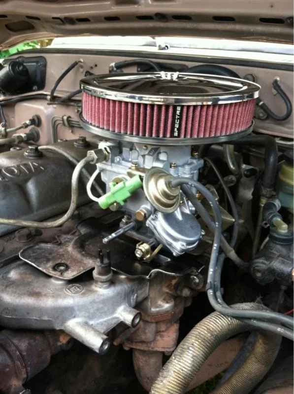

Check my new setup.

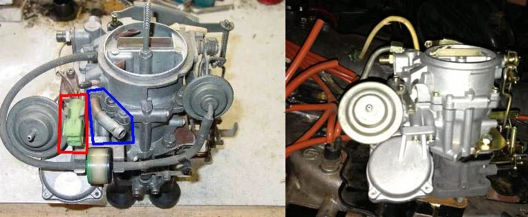

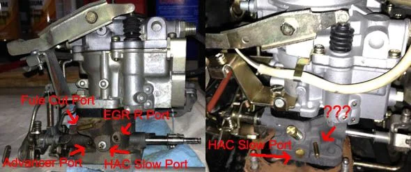

I have a few questions about what to do with a few lines since i have desmoged and now am putting on a trollhole carb with allot less lines. This should help out anyone else putting this on also.
In the top 2 pics.
The pic on the left is the original carb. I am wondering what to do with the hose that hooks up to the blue circled connection since the trollhole carb, in the top right picture, does not have that connection.
Also circled in red is the orginal carb electrical connector that has 2 terminals. The trollhole came with an electrical connector that has only one terminal. Would it be ok to just swap the cables? the entire thing unscrews from the carb. I wasn't sure if these would be interchangeable or not.
In the bottom 2 pics.
The pic on the bottom left is of the original carb with all the vaccum line connections marked. The pic on the right has only one place to connect a vaccum line. The HAC Slow Port is blocked off. I was wondering if this would be the Advancer Port for the distributor or Fuel Cut Port that goes to the Fuel Cut Vaccum switch.
If it is one of these would you just cap BVSV(1) port (a), since there is not a connection for it on the trollhole carb?
Thanks,
