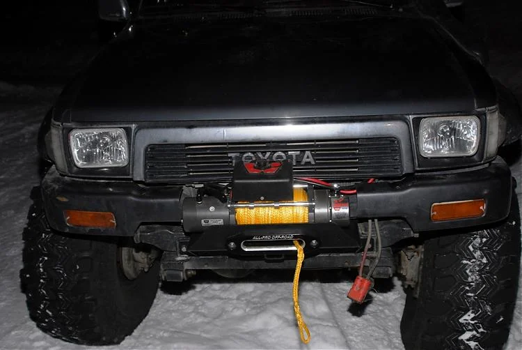

Mounted the winch today, just had to cut out the bumper peace that was in the way. Warn m-8000 in front, also have an detachable Tabor 9k winch which I may either use in front if the warn fails, or in my multi-mount rear.
