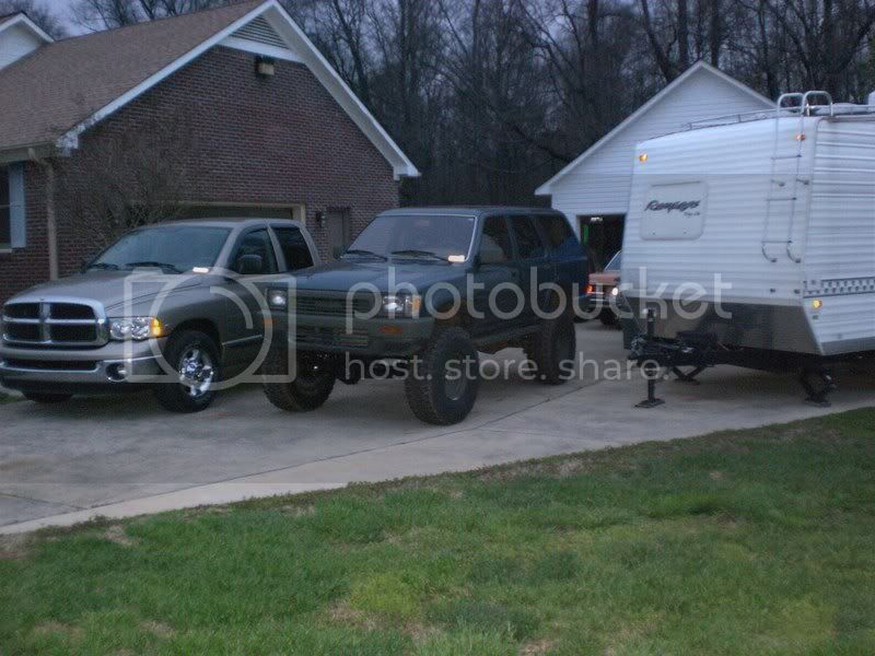

Well, their a bit to tall... could have shaven off an inch or so... What do you guys think???
The last picture should have been first, a before pic taken earlier today... Looks like I NEED the 39,5s now...
Looks pretty nice. Do you have any rear drive shaft problems now? I'm adding a cv in mine, as I daily drive it.

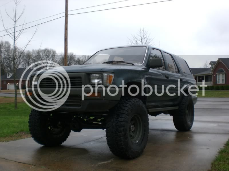

Got the new tires installed today, looks right to me:p:p:flipoff2:
