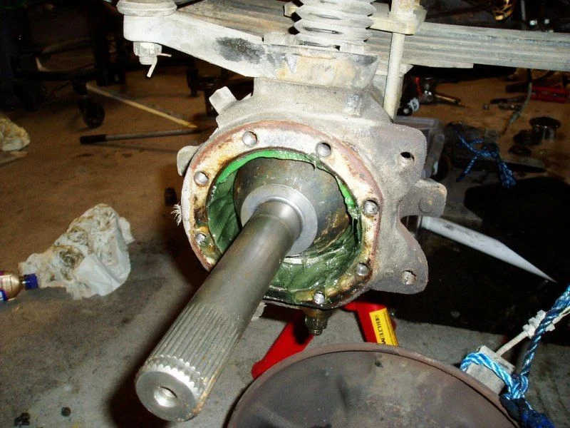

I will try to get some work done this weekend... New coils, new wheel bearings, longs, and a little check on my front air locker which seems to be leaking... :doh:
Will post some pix... If theres something to see... :cheers:
Dang! This is a bad A$$ 2nd Gen 4Runner I have seen. Saaawwweeeettttt!
Not that interesting, but 30spline longfields... :D
