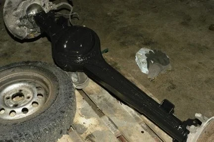

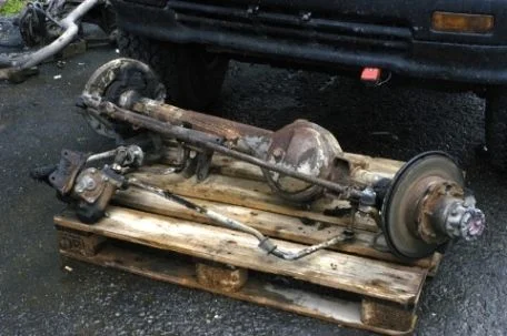

Got my solid axle today! Sandblasted it and removed some brackets. Painted it too...

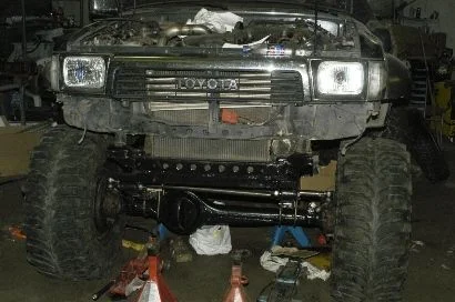

I have now started grinding the ifs mounts. So the project is slowly moving forward.
I have rebuilt the knuckle houses, still waiting for some parts. Also waiting for the diff with new gears and air locker. I reckon much work will be done this weekend.

Finally rolling again! Not quite ready to drive, maybe in a few days. Still waiting for my diff:mad:
A few pix...
The front hight looks to be a problem at the moment, but I will let the springs settle and also mount a winch in the front. I have removed one leaf and it feels soft.
When I have received my pro comp link-drop adapter for my rear suspension and the new all-pro link arms I will order special hight coils so it will be level again. ;)
Its gonna be expensive... sigh... :doh:

Just start!!! It will take a bit more time than you anticipate... And a few more parts... Its better to buy a working, and newly used front axle than to get a crappy one for free. I spent around 600 usd on bearings and shait... :frown: But now, most of it is new....

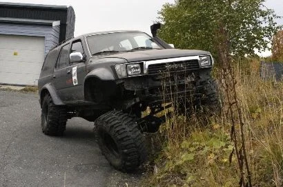

Where did you get those fender flares? Only ones I found were Bushwackers which are very small and JDM which are fiberglass so break on impact.
Sorry, haven`t seen the question before now... The flares are from Alltplast They are islandic-flares made from fiberglass. They will set you back around 1000usd.

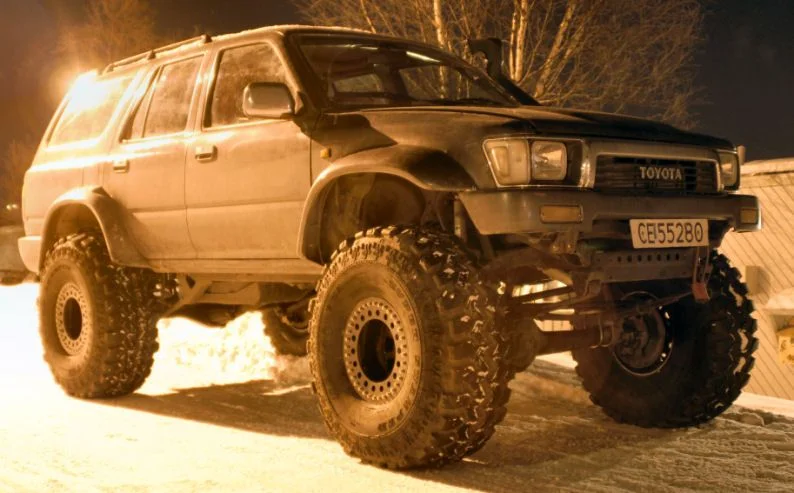

I also ordered a set of 38x15,5 SSR`s on 15x10 beadlocked wheels. Looking forward to getting them, posting a pic below... (sold my Iroks, wanted 39,5 Iroks but just a bit too tall...)
